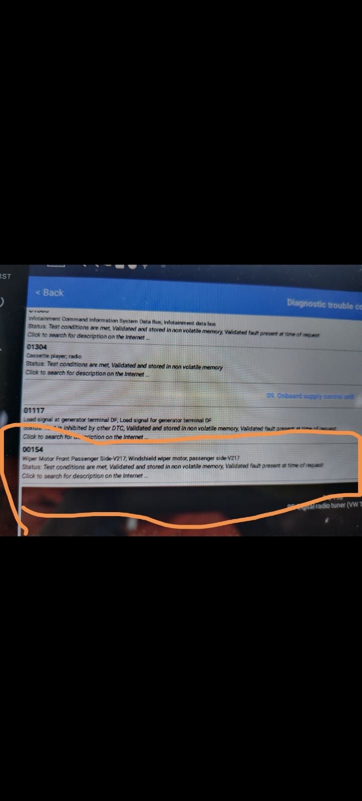

Nov 13, 2023
I have the same error and my right wiper motor does not work, how did you fix it?
