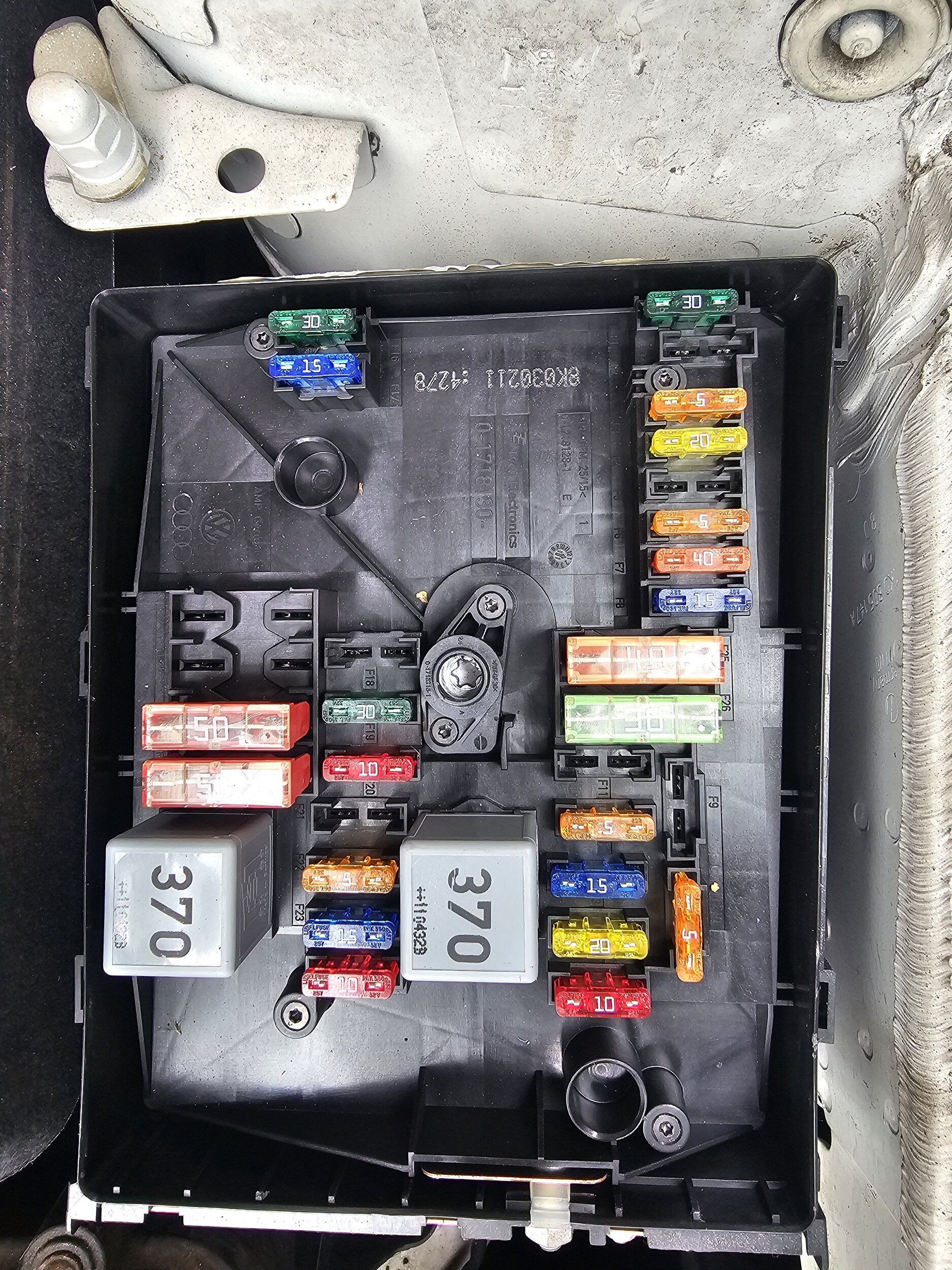

Hi, hoping this is an easy fix. My Seat Leon 1.6tdi has suddenly developed an error with all of the external lights (no other electrical faults). Basically
- Left main beam working/ right not
- Right side light working/ left is not
- Left front indicator working/ right not
- Right back indicator working/ left not
- one of the side indicators is not working
- rear (red) lights - boot working on left not right/ outer light the opposite (working on right not left)
- error messages galore
Not really used the car much recently and definitely not touched the electrics/ bulbs
Help!
thanks

Have you checked the fuses? I use a multimeter to test continuity on the fuses, sometimes a fuse looks ok, but is still actually blown.

Just been under the bonnet and removed/ reinserted the same fused. Seems to have cleared the issue. Think I will find out which one is the lights and replace that one just in case.
