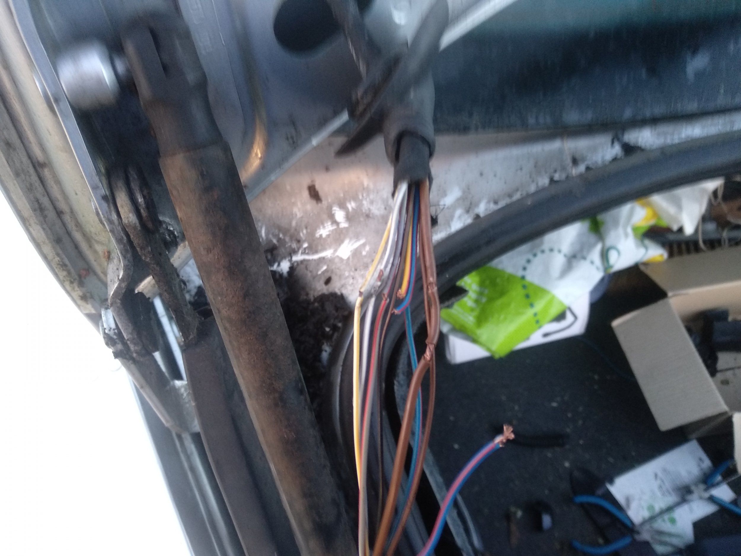

I too had problems with the boot latch not operating. As a stop gap whilst I was trying to sort the problem I attached a piece of string to the lock catch and fed it to the back seat area. To open the boot I pulled the string and hey presto, no more climbing into the boot via the back seats.
The next thing that happened, a few days later, was a warning light telling me that my nearside reversing lamp was not working. I replaced the bulb but the warning light was still there and the lamp was not lit. i suspected therefore that there must be a wire break, but where. Being of the old school of motoring my first idea was to run a cable from the working reverse lamp to the non-working one. To my surprise neither lamp lit up! (I later discovered that these more smart motor cars have something call "CANBUS" installed. This apparently monitors the function of many of the gubbins in the car, including the light bulbs, and any reports any failures).
The next step was to find out where the break in the wire was. To do this I had to invest in a wire tracer. How this works is that you connect one clip to the end of the wire and the other clip to body of car (earth). A tone is emitted along the wire and you follow this with a probe. When the tone stops that is where the break is. This I did and the tone stopped in the flexible joint that goes between the boot lid and the body of the car. I carefully stripped of the outer covering to display the individual wires. This is what I found.
Some of the wires had broken and most of the others were bare and ready to break. I cut all the wires in the cable and crimped them back together. After I had done that the reversing lamp worked and so did the boot lock. Problem solved. I taped the individual crimps and put quite a few turns of tape around the whole joint to protect it when it bends.
The conclusion is that any problem with electrics in the boot lid will probably stem from that bending cable. However, the wire tracer was very effective and not very expensive.
