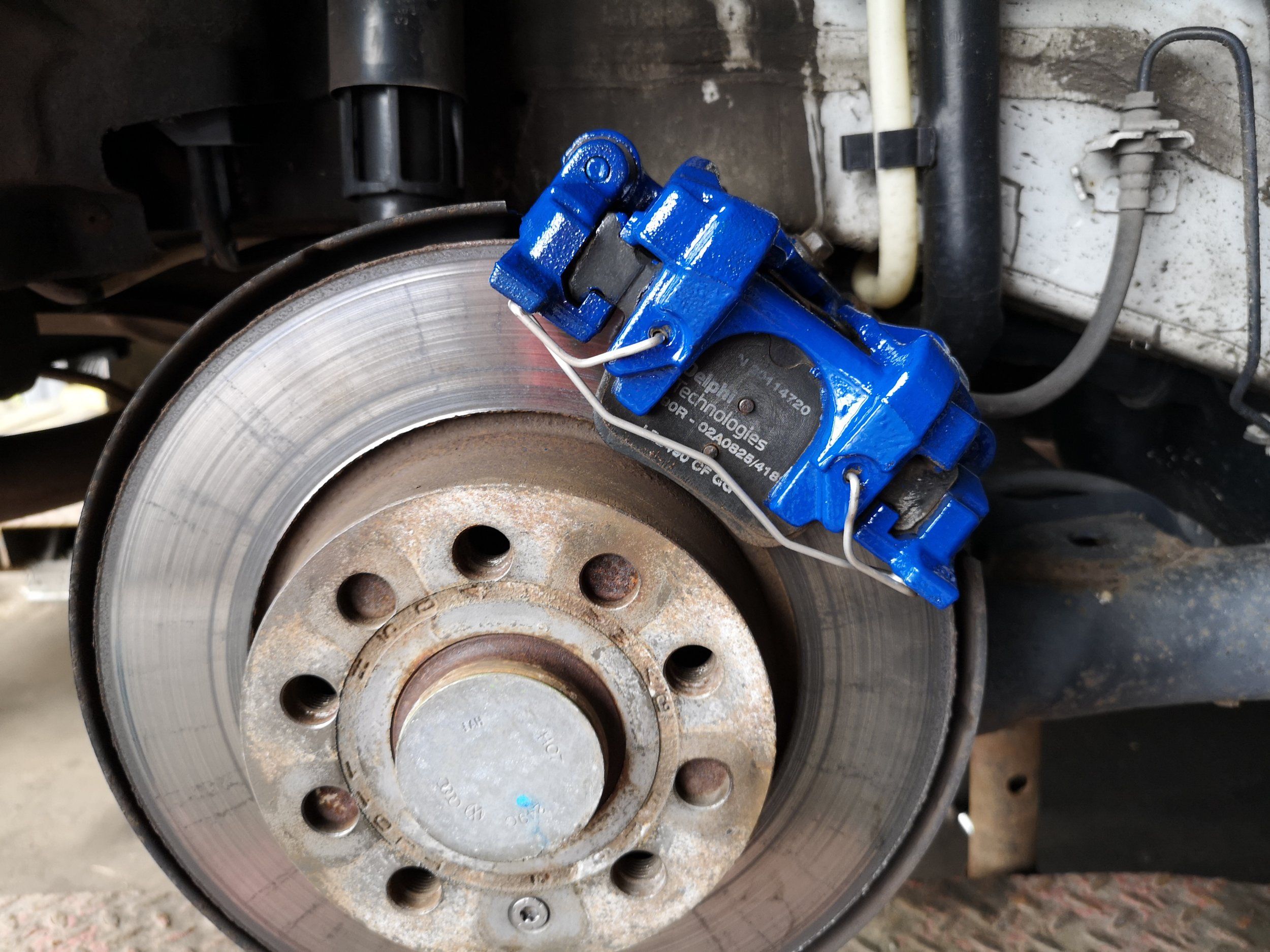

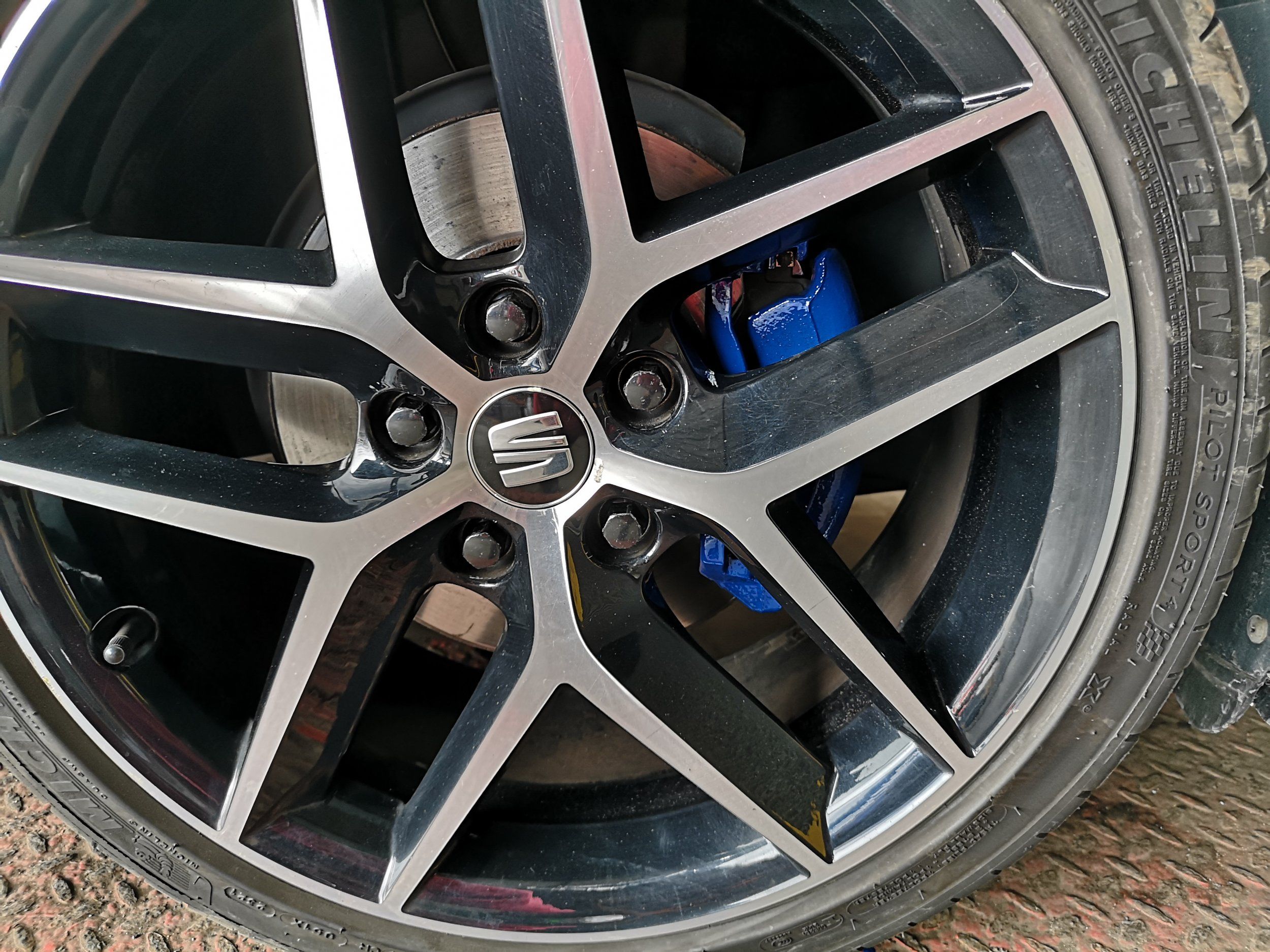

After nearly 8 months of doing "other" mods, I've finally got round to painting my calipers today along with 15mm spacer's all round.
It was the last part in the jigsaw of my visual modifications.
APR or Revo remap next ?

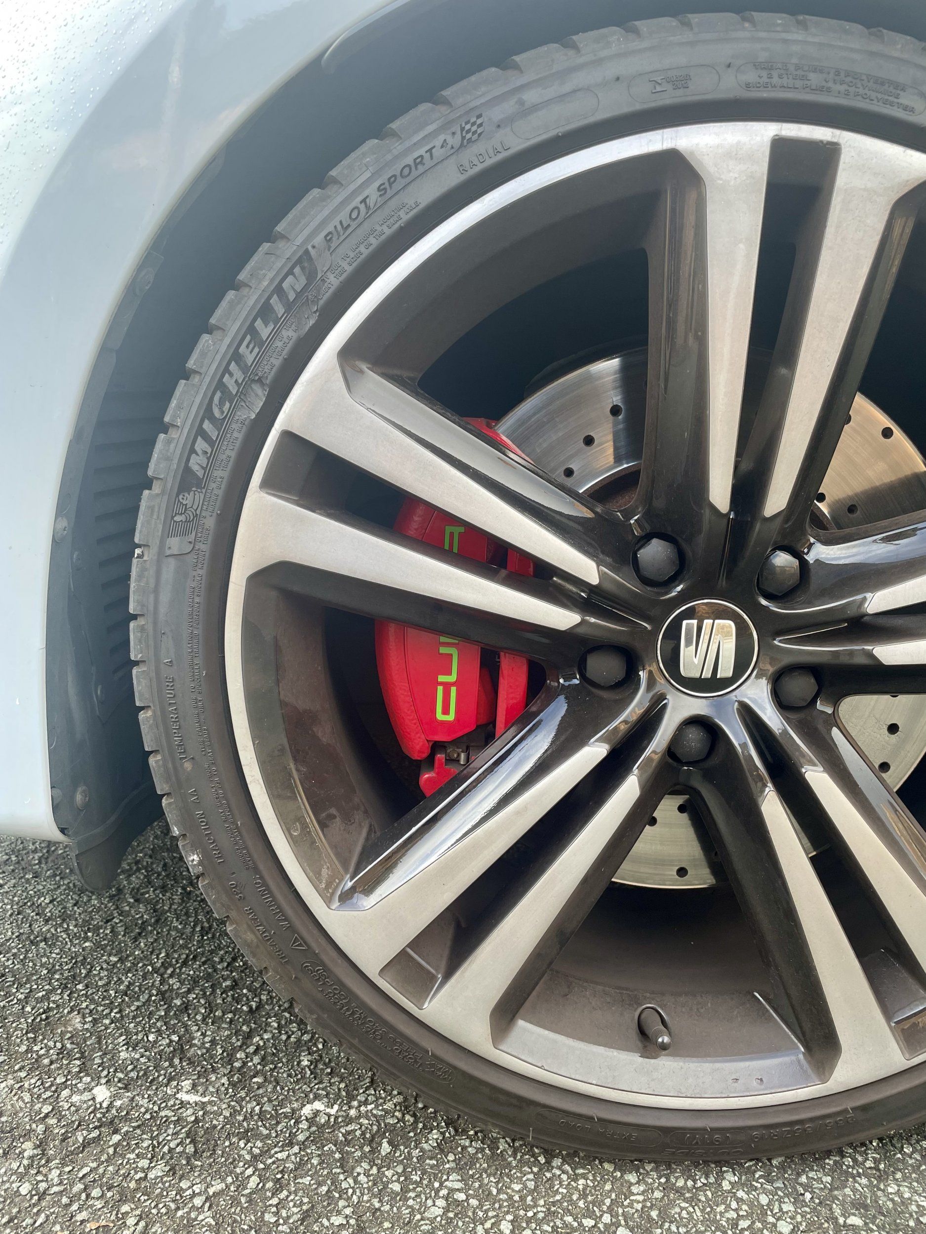

Nice. I put decals on my front calipers recently.

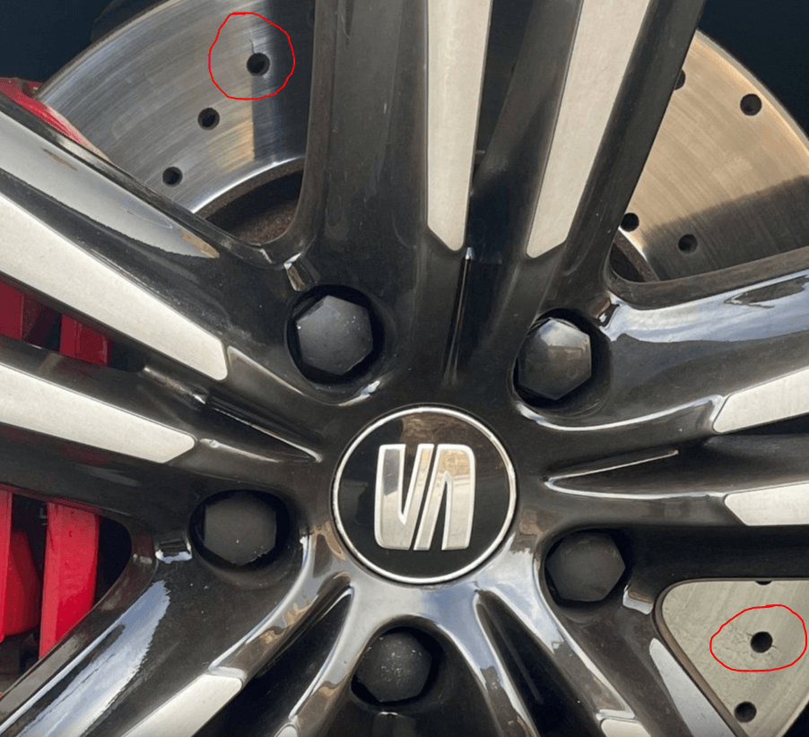

Nice painting but looks like you have some micro cracks radiating out from your drilled holes. Nothing to worry about at the moment - just keep an eye on it. if any micro cracks get to 20mm+, join up and reach the edge then you need a new disc.
What discs are they? Original or aftermarket?
That's the trouble with drilled discs, they look cool but each drilled hole is a lovely stress riser for a thermally expanding and contracting cast iron! drilled discs have a much lower thermal fatigue resistance than plain discs.

Stock discs. Mentioned it to MOT tester recently, and Seat dealership, they said it’s fine at the moment.

Getting the front discs and pads changed tomorrow. Discs were from new. Lasted >100,000 miles. Swapping them for none-drilled ones.

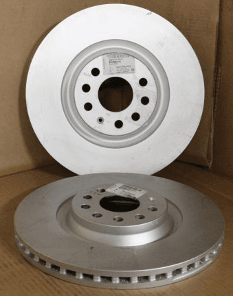

Ah ok, I would highly suggest it has had some new discs previously before your ownership.
The OE number 5Q0615301G for the 340mm disc is plain - NOT drilled. Can't see any drilled option for the 340 disc - only on the 370 disc - unless there was a local dealer fit option?

Oh, fair enough. You learn something new every day. I’ve gone with plain discs this time, no drilled holes, like those ☝?
