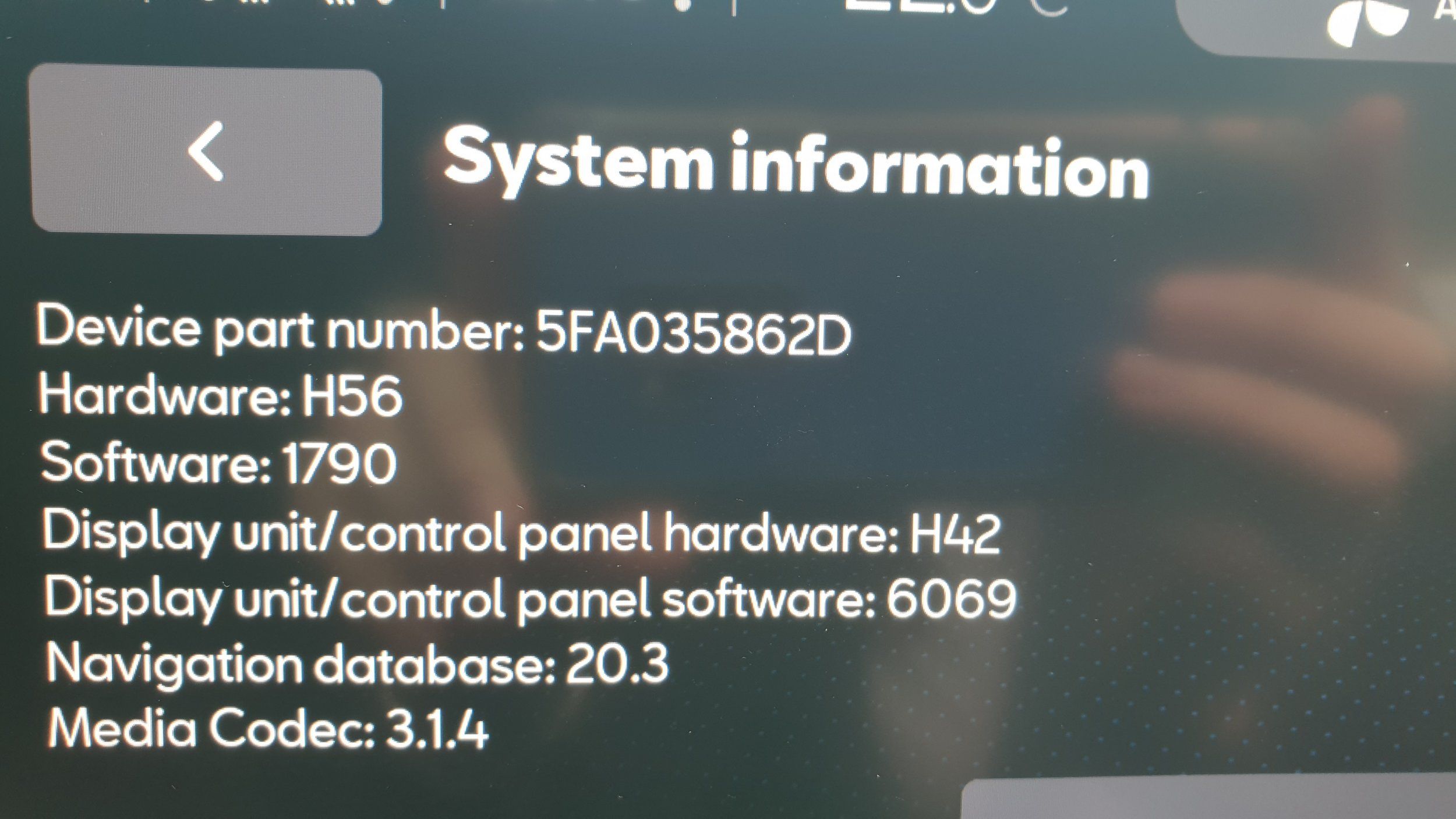

Hi,
My VZ2 is due to be delivered next Friday and I was wondering how easy it Is to check the infotainment software and firmware versions, I want to ensure I have the latest versions. I have heard there are a few issues in the earlier s/w releases. Also, does anyone know what the latest versions are?
Thanks
So what is the latest software version that we know of?
I saw that @steviekek had 1790 software in his car. Does anyone have anything newer?

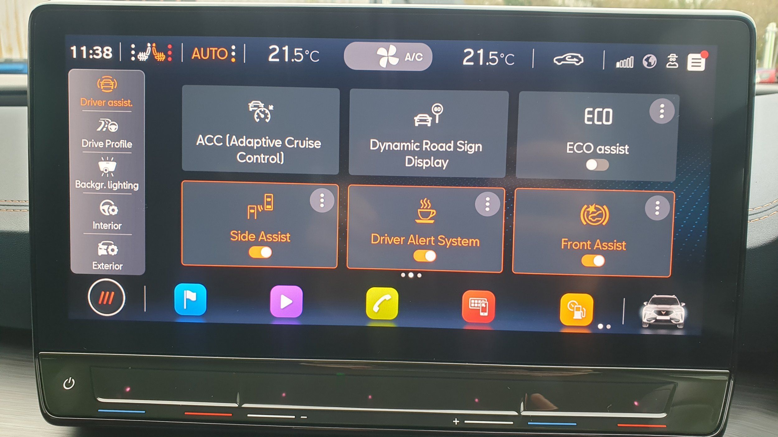

My car built on week 04, VZ2, has new version of hardware/software. Android Auto works wireless on it. It has a bit different settings than on demo car I drove in December.

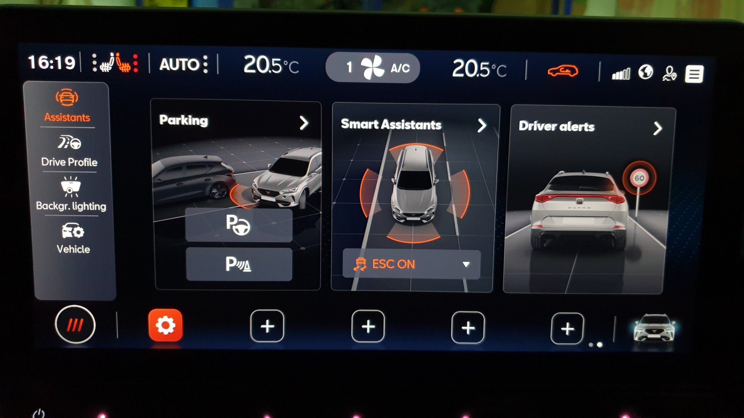

New version of Infotainment, requires more clicking through options, than previous one. To switch off assitance annoyances, you have to click Car and then Smart Assitants. Only then, there's set of tiles with different functions and you have to scroll to the right. Previously, it was on the main screen, after clicking Car icon.
I don't see quick way to switching off all gadgets.
Older version.
Newer version.
Older version.
Newer version.
That’s a difference from my car. I have the older version still.

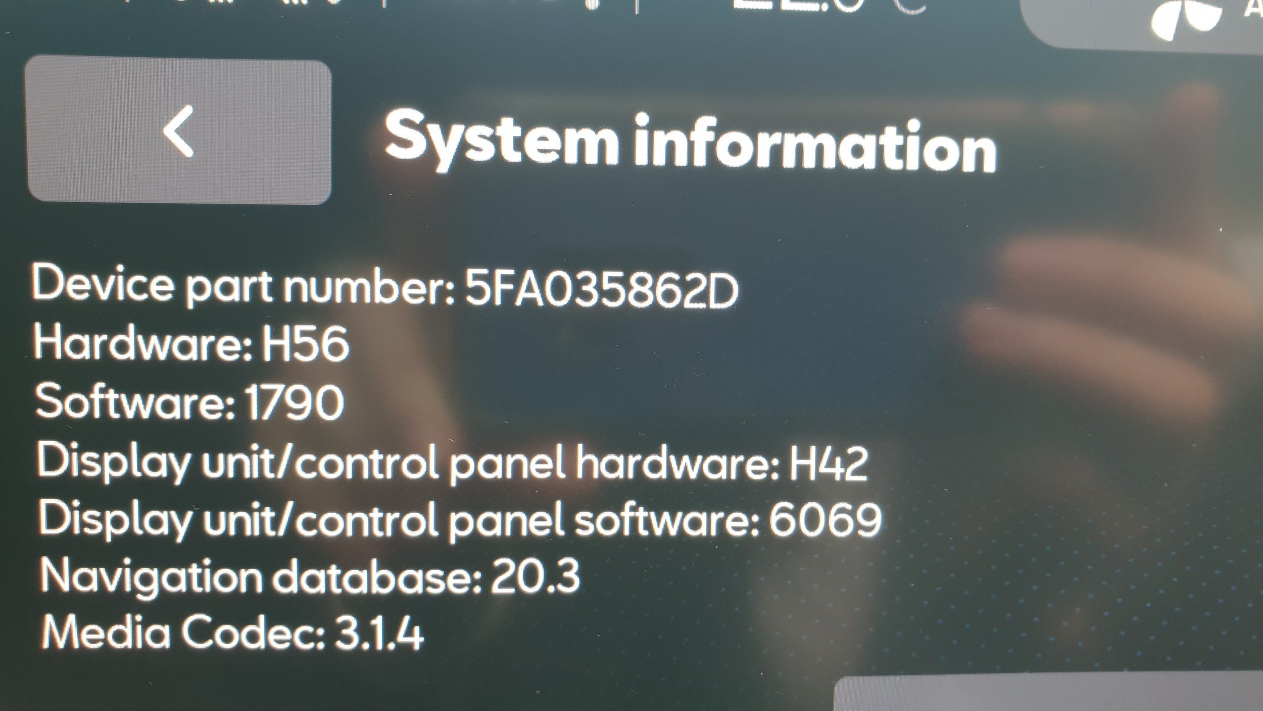

Whats the version number for the latest one ?
EDIT: just read the thread properly, 1790 latest.
This might be me being thick but doesn't "Device Part Number" identify the actual physical device so if the car has an "old" B part then it always will, so no software upgrade is going to change that?

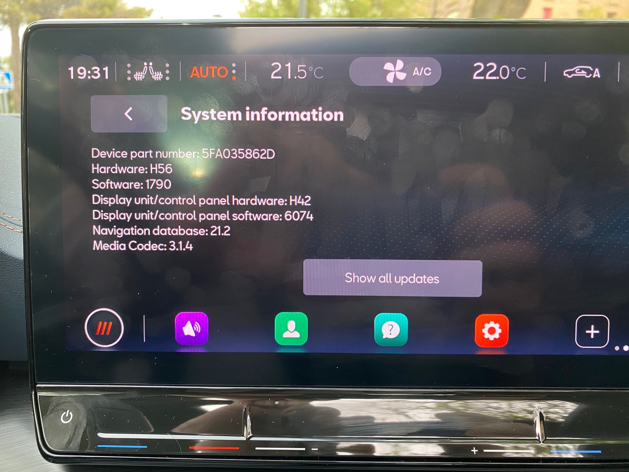

When I got the car (29th March 2021) - VIN number 20xxx
Device part number: 5FA035862E
Hardware: H56
Software: 1790
Display unit hardware: H42
Display unit software: 6074
Navigation database: 20.3
Media Codec: 3.1.4
Today I got an update, I switched over to WiFi and it took about 15-20 minutes with a long hang 2/3rds of the way. When it ended it wasn't clear that it was done, I was in a menu at the time and I just couldn't get back to the update screen.
After update (31st of March 2021) - seems I got only Nav update
Hardware: H56
Software: 1790
Navigation database: 21.2
Media Codec: 3.1.4
Reactions: Wattser

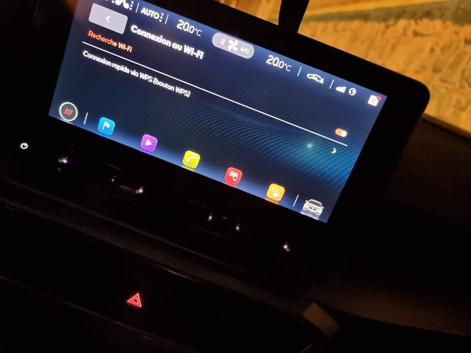

Need help when i update my software i lost the wifi i can't connect the with wifi of my tel so how i can do to fix it
