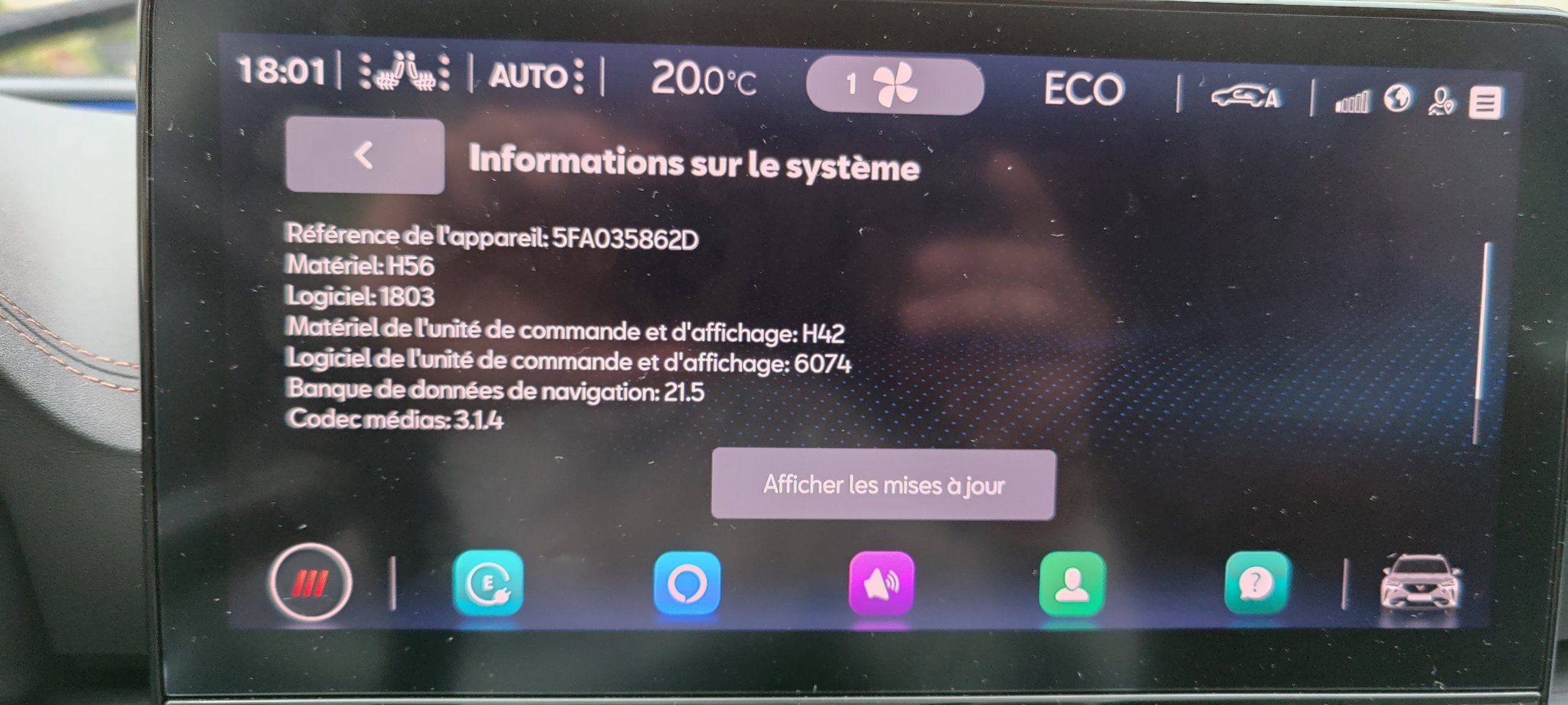

Hello,
New car ;)
V1803

Hello,
I just added the model in my signature.
Here is what I noticed since I received it (1 week ago).
First of all, I have never known the previous version, I cannot make a comparison.
List of problems :
1) ACC: For the assisted driving mode the only dangerous thing that I noticed immediately (more than 1200km of highway) is that it is not centered between the two lines. She is very left, see too much! I will send example videos in a few days.
2) Alexa: So there, I'm terribly disappointed. I was sold that Alexa was available and that's right and wrong. Here is the truth for future buyers. On your screen of your Formentor, you will have a "Store" or "Boutique" icon, you can download "Alexa". Once installed you will quickly notice that you cannot use it:
a) "While driving": I find it annoying that a driving assistant is not available while driving! Is it the same for other people? or just in "France"?
b) without a "Wifi" network. We touch stupidity! Either you have to share your own mobile phone each time in Wifi, and the Formentor connects to it, or you have nothing. Has anyone found another solution? If we take a Cupra Telecom subscription does it work?
3) The phone assistant "Cupra connect" is really very slow. The feedback does not always work, for example the state of the electric recharge. You have to wait several minutes (10 / 15min) after each refreshment.
To conclude, this is so far only the negatives points that I find in this car. I am totally in love and it works perfectly, all the options are sublime, and I strongly recommend the purchase.

Hi,
Auto answers :
1) I was in contact with Cupra ES and after Cupra FR, after long discussions with them, the answer is: it's normal !
I confirmed in writing that I think there is a problem to see in time ...
For 2) a) fixed by Cupra the last week by New Update. It's done !! Thx guys.
2) b) i work for try to find solution.
