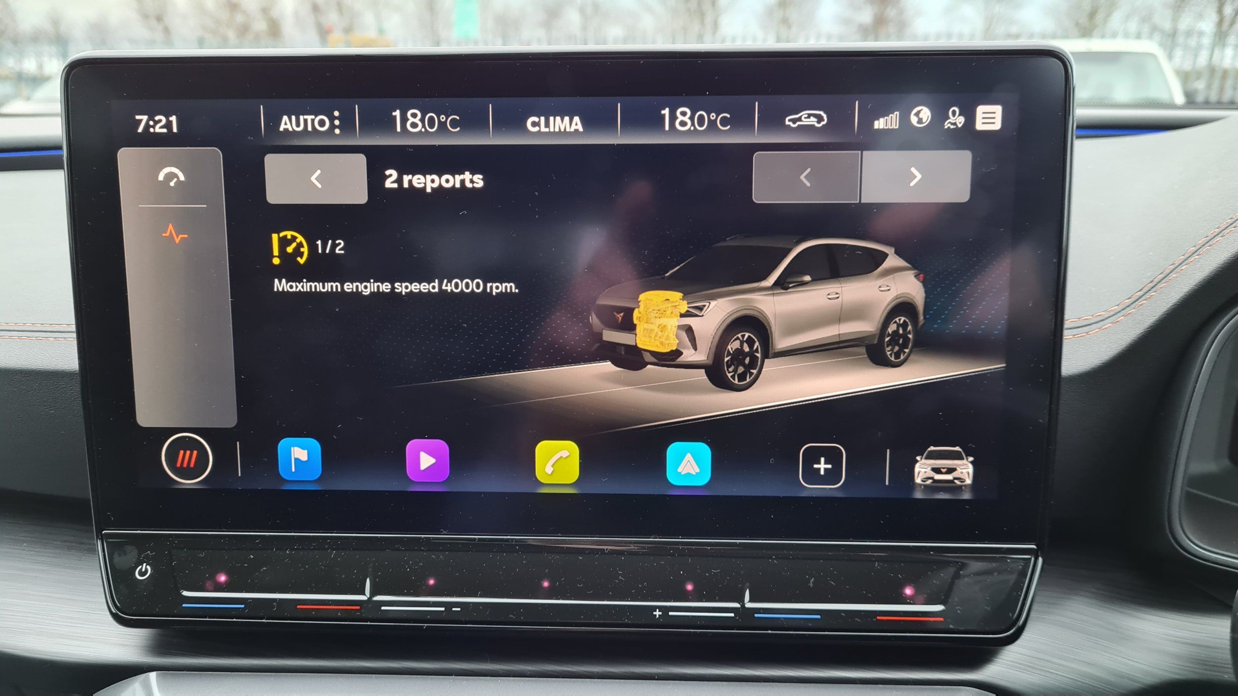

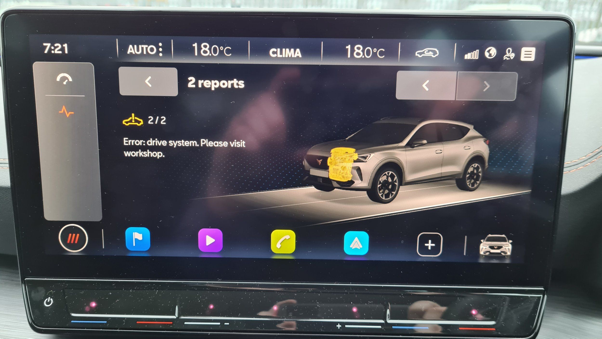

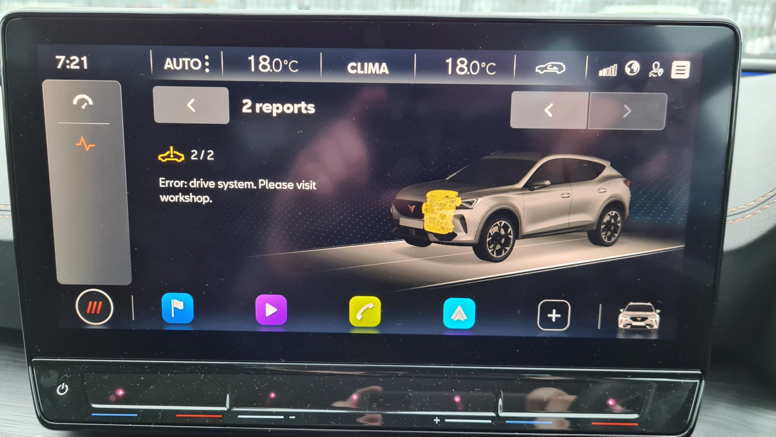

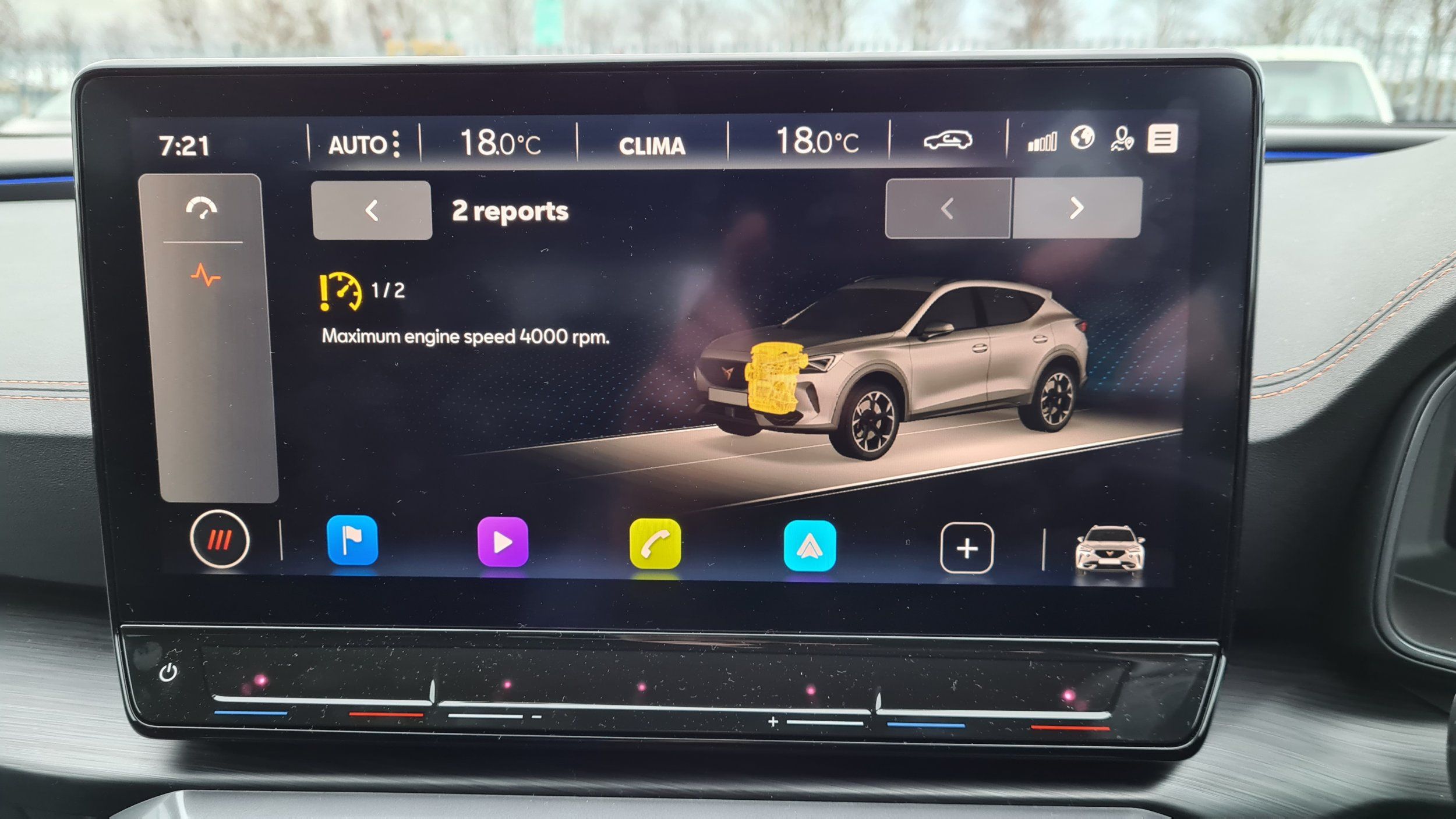

I hoped I wouldn't be joining the club of pissed off Formentor drivers but after 10 days I have.
Been waiting on a call from customer car for 4 days, keep getting told they'll phone by close of business but then I get an email saying sorry we'll phone you tomorrow and the cycle repeats.
Got sod all faith in this car.
View attachment 30764 View attachment 30765
I've had the "Error: drive system" twice. First time a week after getting the car in December, and 2nd time at the start of March. When I turned the car off and on it disappeared mind you. Is your warning on permanently?
Dealer told me it was probably down to the software needing upgraded and nothing mechanical. From your pics it looks like your software is either 1890 or 1896, so if it is software related it looks like they haven't resolved this issue with the latest updates.

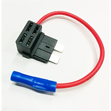

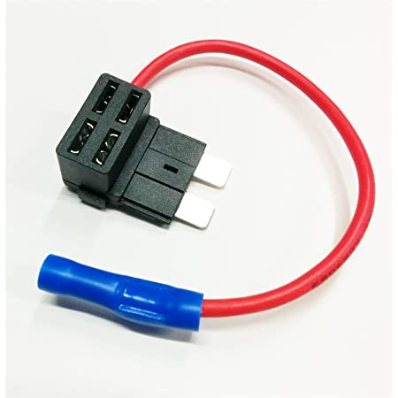

Ok, so I now understand - the blue piece in your pic is where each of the yellow (always on) and the red (ignition on) cables attach to the respective "fuse tap". Amazon shows different sizes of fuse tap - 21mm, 22mm, 24mm and 25mm. What size do I need for the Formentor fuse box?
DEAN0
Old Git
Feb 1, 2006
5,438
425
Preston - UK
That I don't know.
Easiest way is to pull a fuse and measure across it - pretty sure one of the dimensions you listed will match a fuse from the formentor.
And yes - you are correct - your red or yelllow go in to the blue connector.
The standard fuse then plugs in to the lower slot to protect the circuit as normal.
A new fuse goes in to the top slot to protect your added wires.
