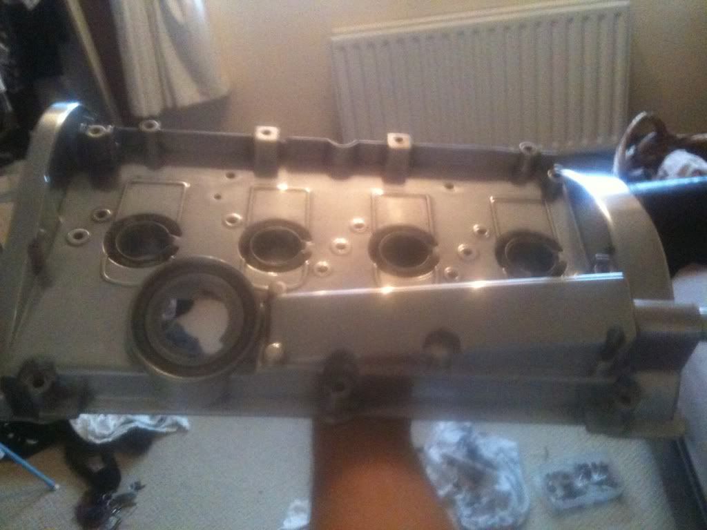

few updates picture from players and also a pic of my polished rocker cover.

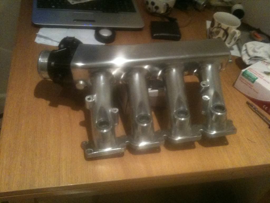

inlet manifold polished with gloss black tb

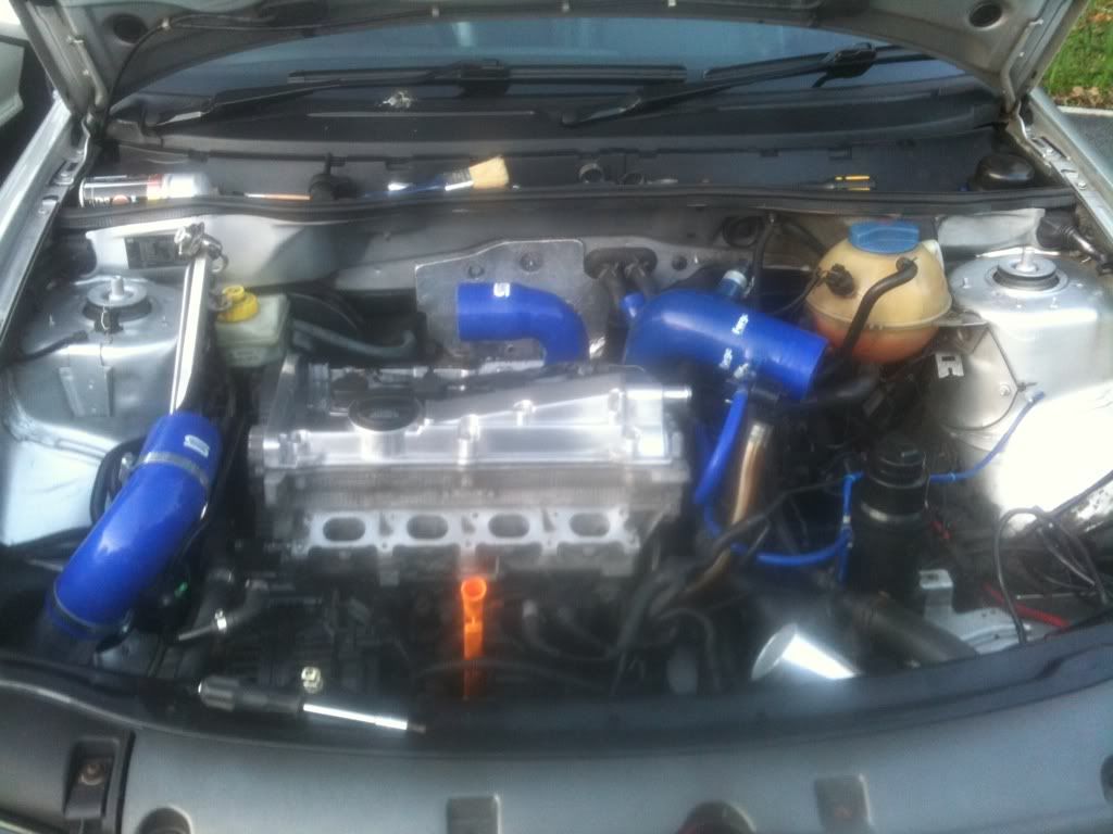

also one of bay as it stands going on a huge cleaning tidy and polish mishion at the moment going to player made me realise my bay sucks! not for long tho

Yer I know it's on my list of things to get yer spend 4 hours polishing it up today looks nice I'm happy. It's a great cheap mod that's for sure
Jul 4, 2007
1,674
bristol
Cheers mate. I used a dremal to grind any flash lines off. Then 120grit to get all texture off then 230,320,500,1000,1500 grit then autosol the whole thing. I do this a work anyway as it's the same technique to polish carbon parts so dident take me long

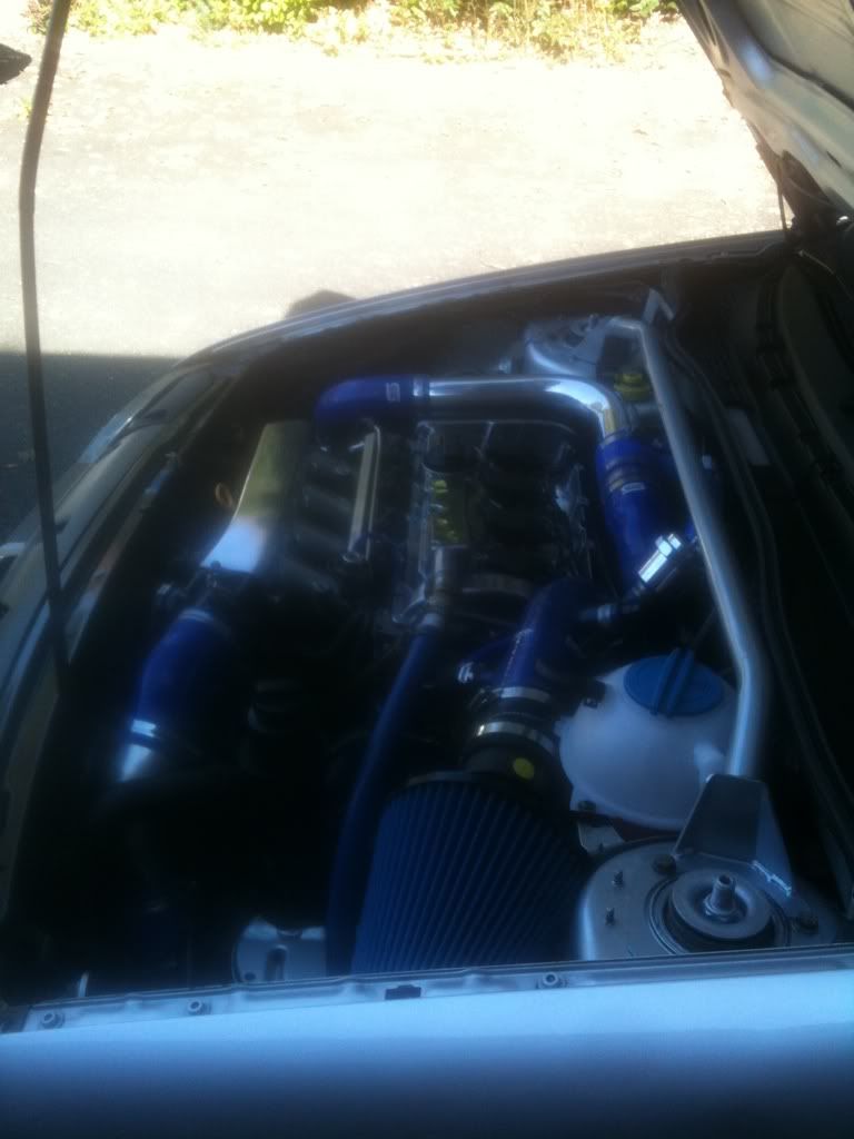

Got a few Pics of the engine bay completed well nearly just got to get a new pipe welded up to put dv back on hotside :) was crap pic taken at night but you get the picture
Also waxed it today
Comments welcome

Looking nice, clean & shiney.
How come you putting dv back to hotside? Thought it was better for the life of the dv....
Jul 4, 2007
1,674
bristol
Ally pipe it's because of the angle I used think it was a 70 degree but does not line up right but fits ok with a 45 silicone tube but you can't get 45 t pieces so hotside it is I cut the 25mm flexi now so gota go hotside lol
