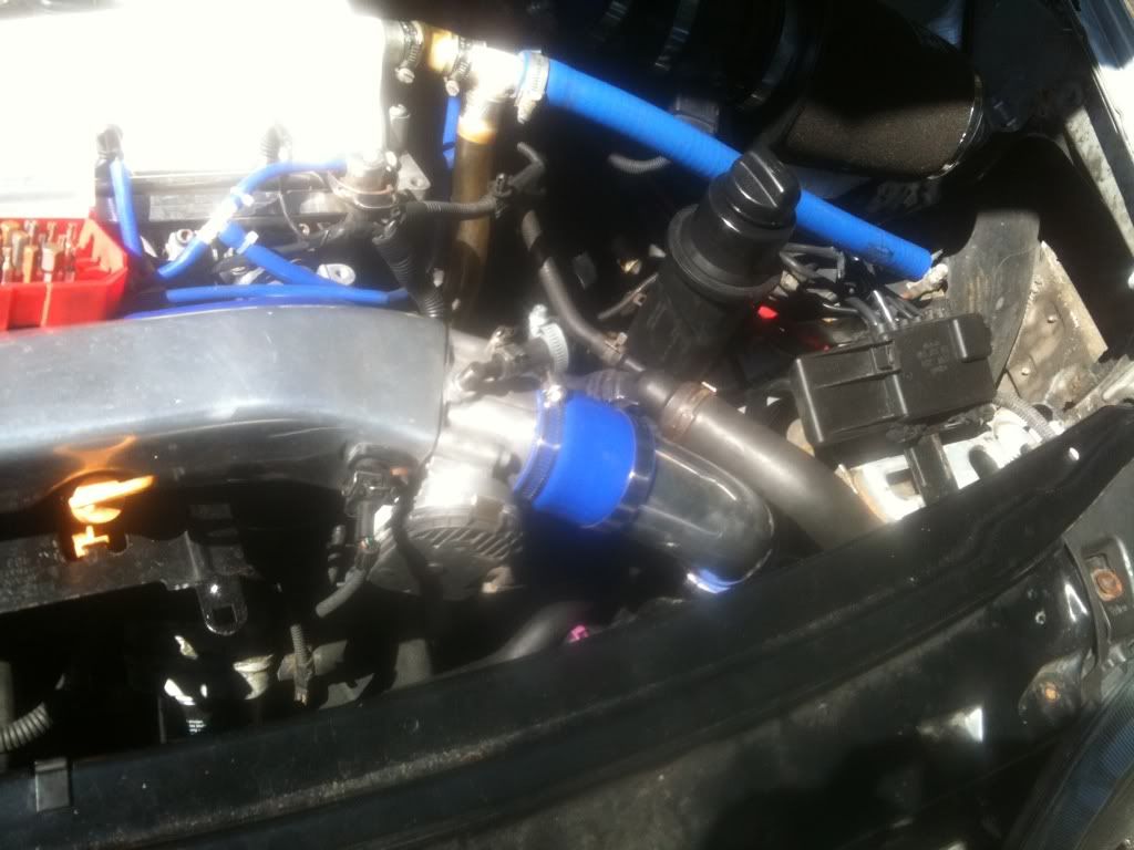

Update time got all the intake side of things done took a while but I'm really happy with it
It's tight
All mocked up Love it

Looking good Joe, make sure you bead the pipes as they will be popping off every 5 mins!
Oh and also did you buy jubilee clips from forge or use the ebay ones?
Jul 4, 2007
1,674
bristol
cheers james i was thinking about beading im waiting on t-piece, tubes, and maf pipe so just mocked it up using crappy clips.
i was going to order ones off forge but its so much cash so i found some half decent high grip ones on ebay for a lot cheaper hope they are ok. i dont have a beading tool :(
do you think i will blow pipes off all the time without?

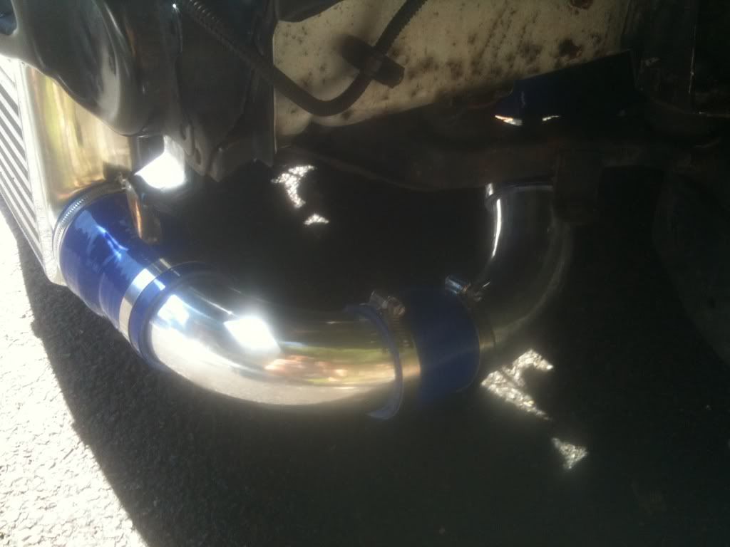

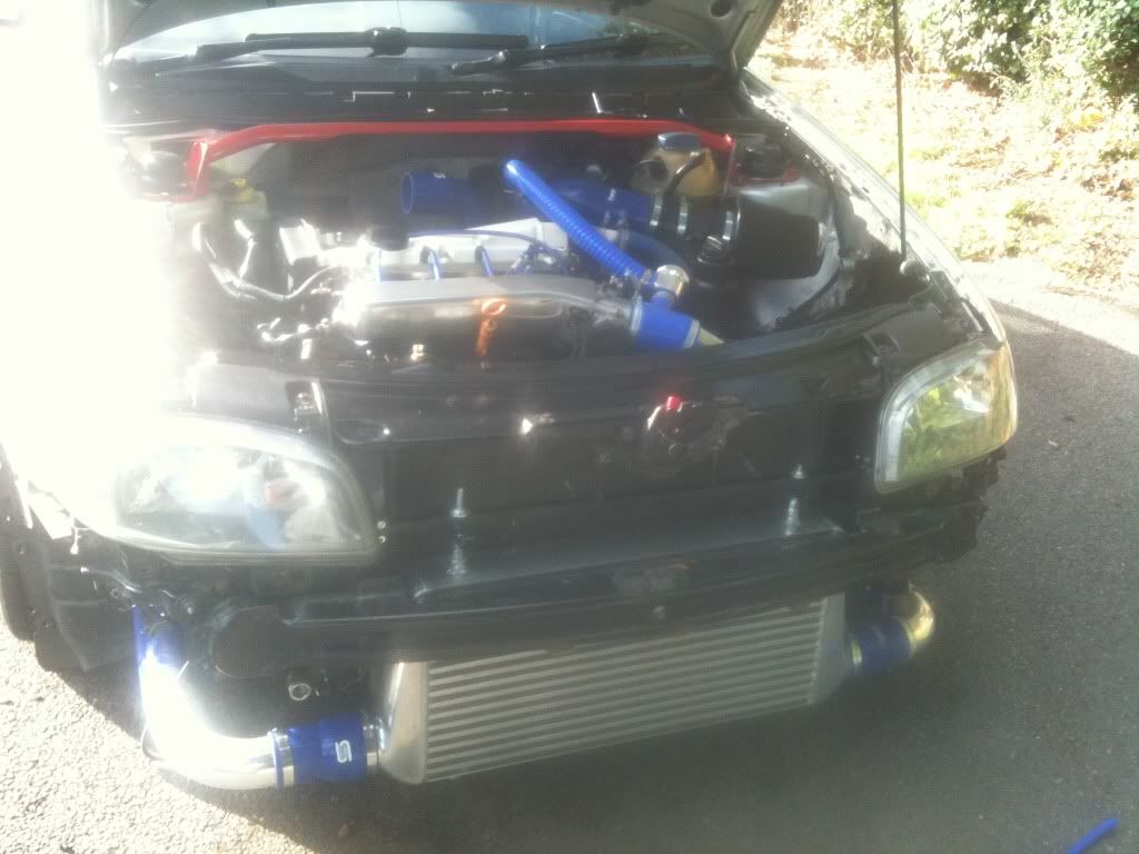

im so close thats its just annoying waiting on final charge pipe from the ship builders at work! o well it free welding. even re-mounted my horns as well also got the fog lights fitted which im stoked on havent lost anything!
i really need to buy a decent camera.
Jul 4, 2010
2,170
Cambs
Looking smart mate, glad to see you got the pipe ok :)
I would extend the filet a bit further away from the maf if I where you, gives the airflow a change to straighten out as you will get a lot of turbulence.
Gives more accurate readings then, especially as fueling solely relys on it.

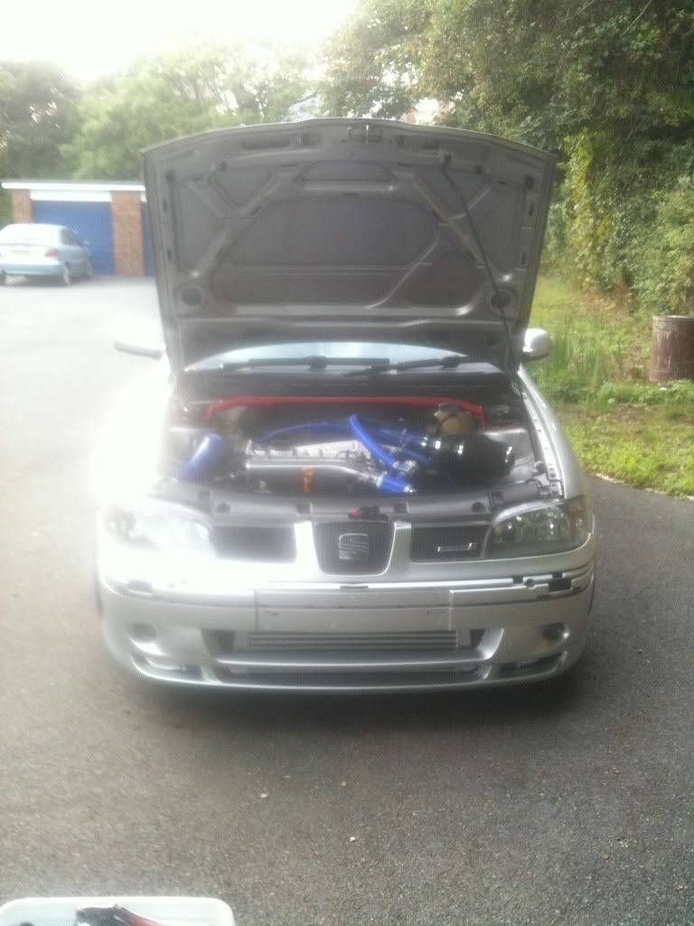

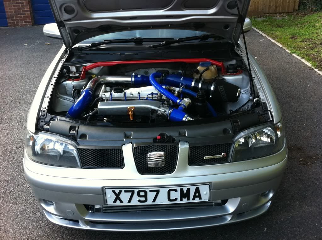

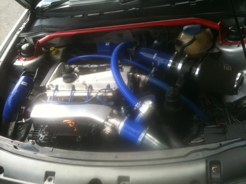

just a few pictures of how she stands after full hybrid treatment feels like its all pretty much done now.
and i am bored lol what to do with all the spare hours i have in my life.
next things i wish to do
full respray in another colour
wheels need to be sprayed
and just make it look lush again been so focused on power over the last year i miss doing small cheap mods.
pics below :D
side on
back
mean looking toyo intercooler
engine bay
also just a random front one
