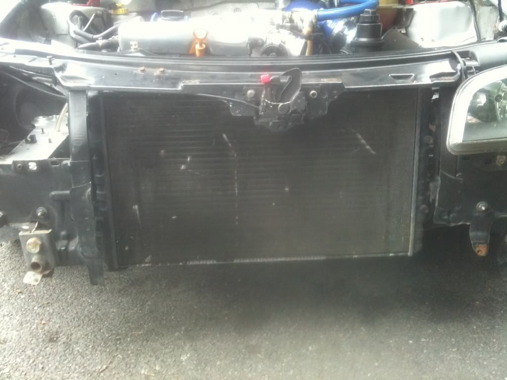

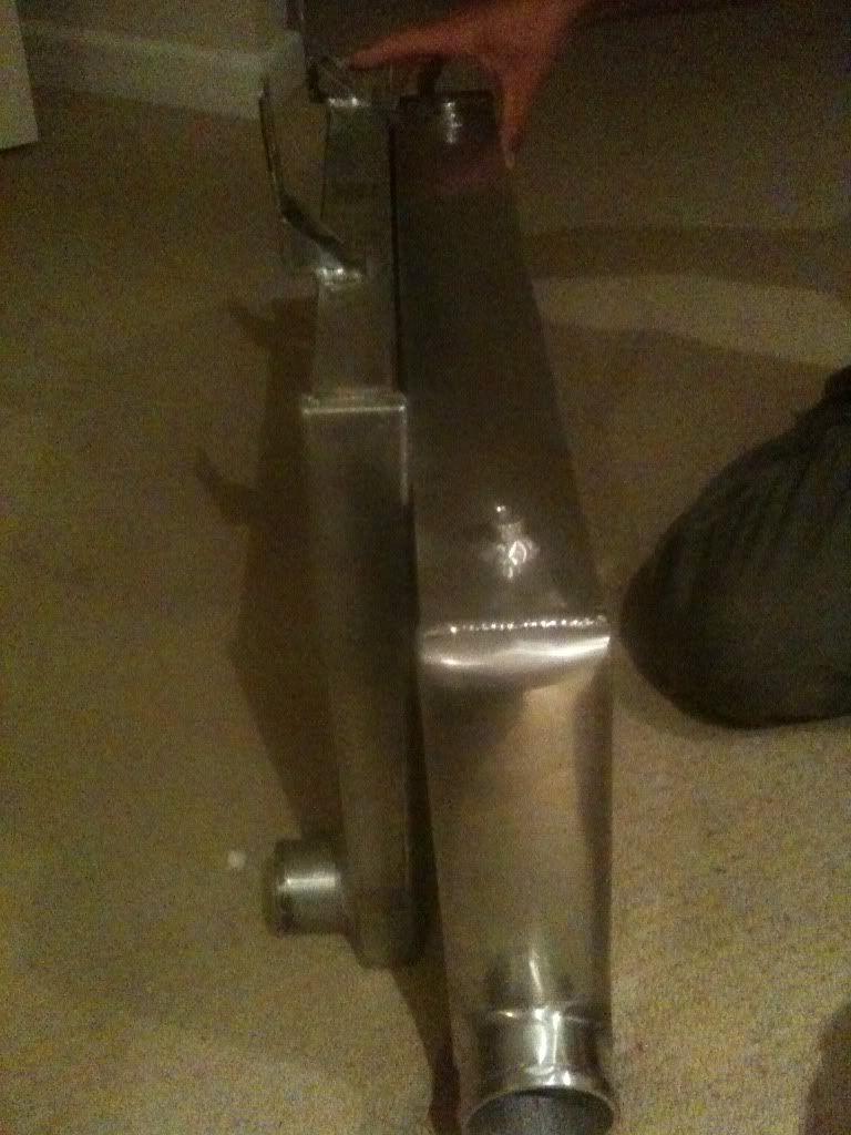

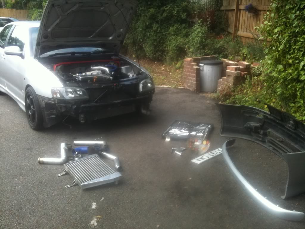

few updates for you chaps. finished work at 2. so got on with taking my old cooler off and fitting my new toyosports one few pics.
old cooler coming off
this ones with the rad moved back as far as it can go.
bit more room than before.

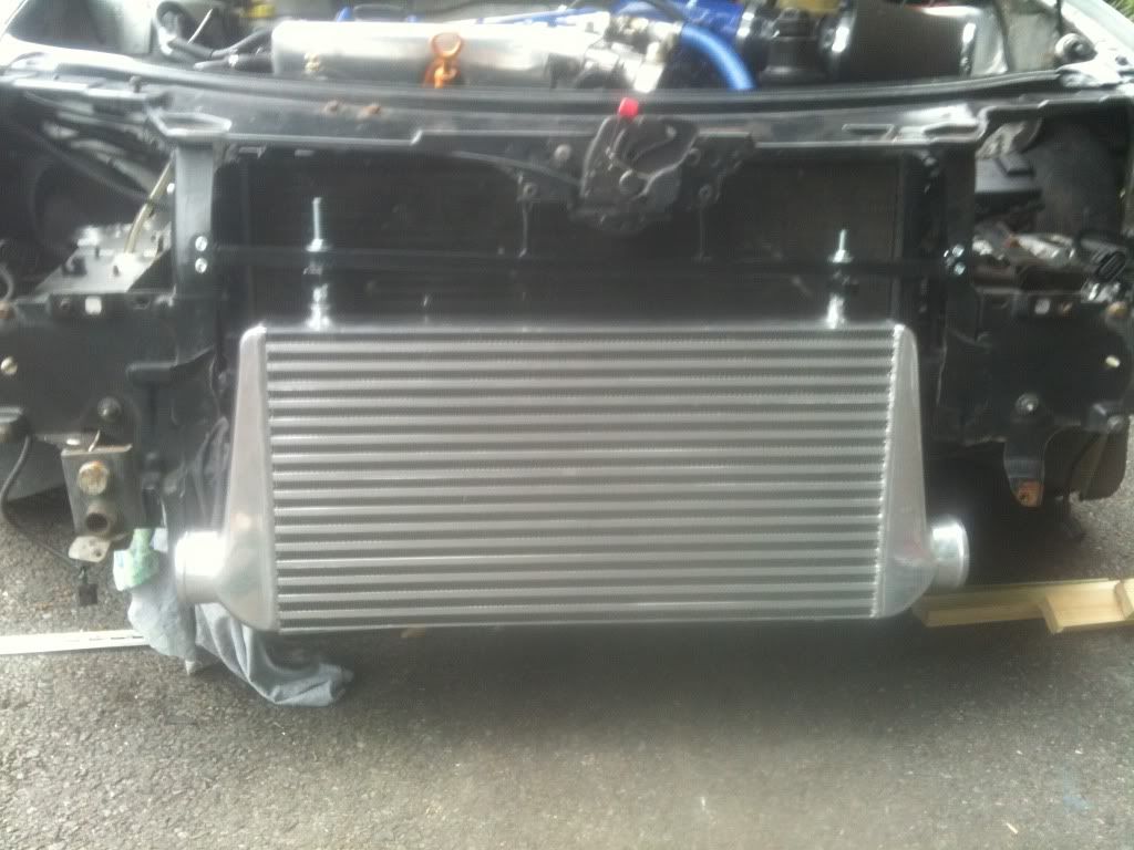

another intercooler update got it all mounted and bumper cut after work today heres where i got to before the rain got me. 2 hours work not bad.
i dident make the bracket in the end james kindly copyed his and sold me one. legend saved me a lot of time. thanks james!
just after mounting
bumper all cut in dident have to take a lot off im hoping to keep my fogs but we will see when pipes come.
old vs new lets hope it cools my hyrbid setup down a little more power torque who know. was loosing 5psi top end. 26spi spike settle to only 19 at redline. maybe after this it will hold like a stone.
