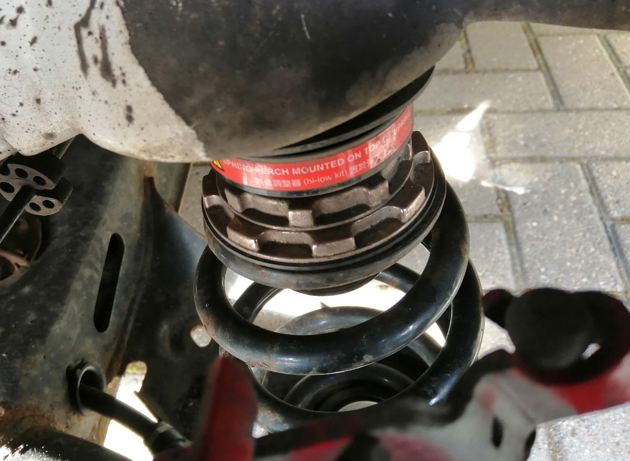

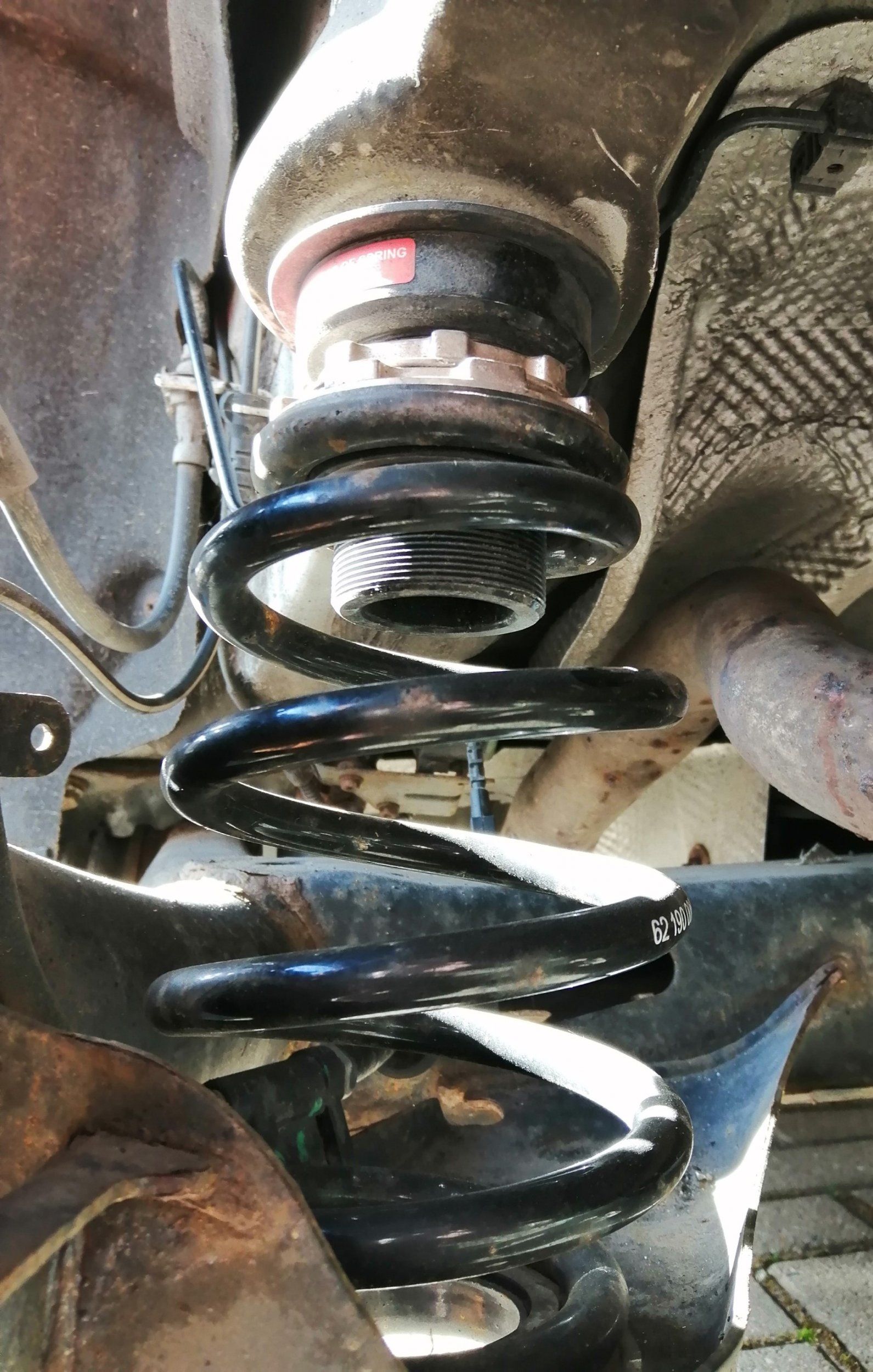

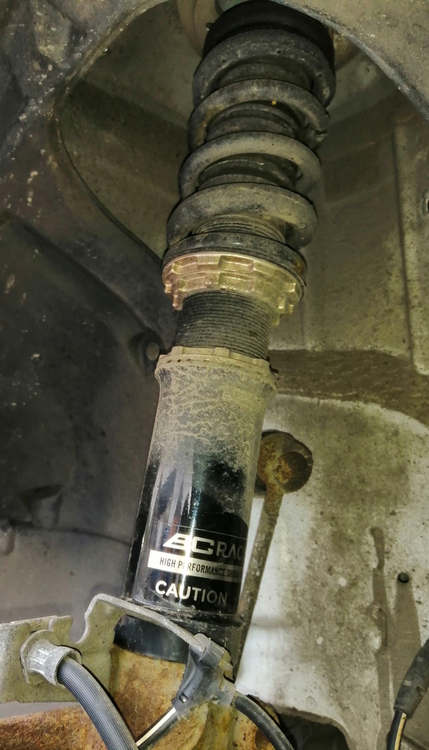

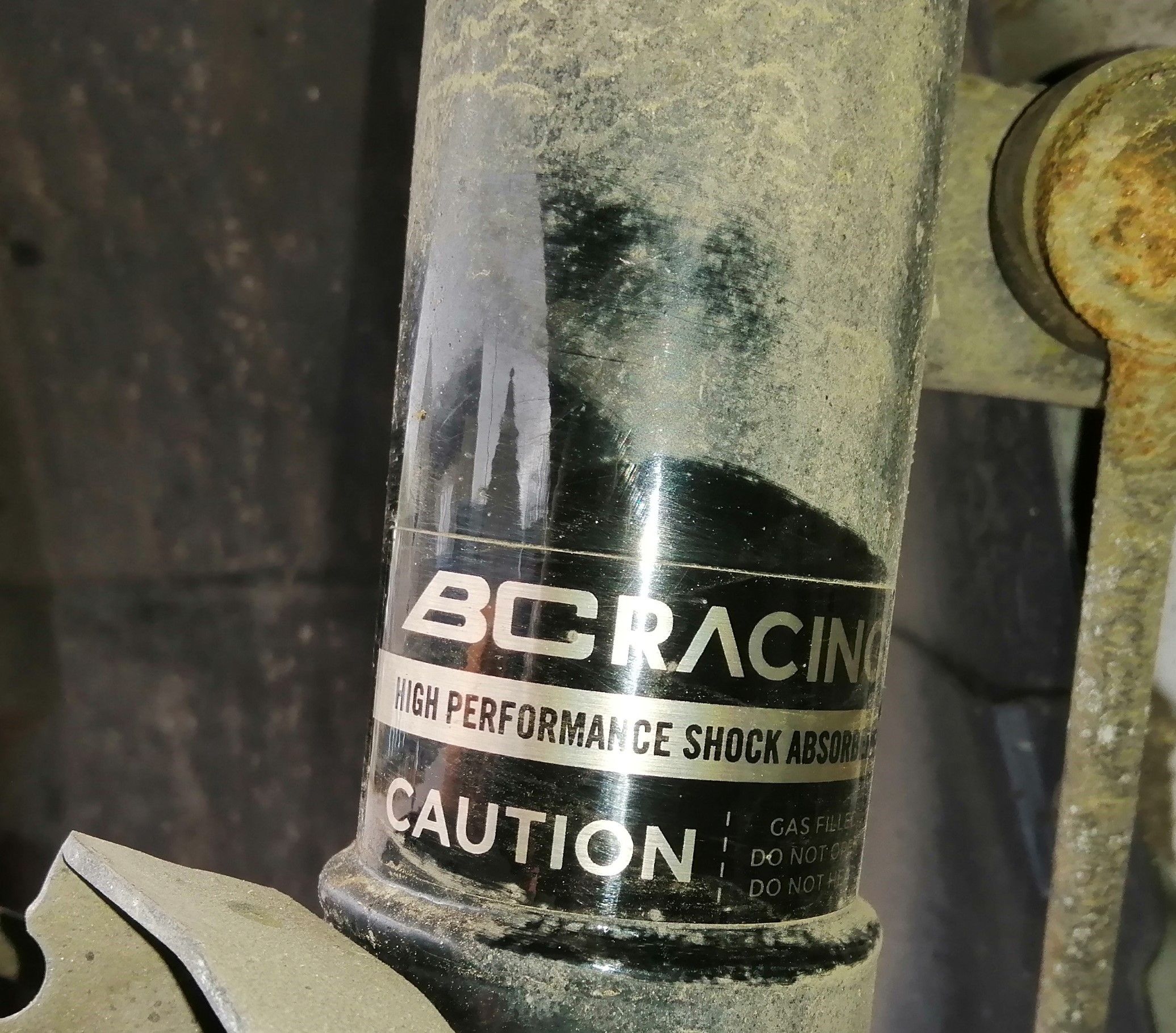

Currently have adjustable BC racing coilovers/struts and rear adjustable springs fitted to my 2014 SC 3dr FR 150, am looking to revert back to original three reasons
1. the front adjustable nuts on the coilovers are seized solid, no soaking or brut force can seperate them
2. Sick of hitting speed bumps as cannot adjust (see 1)
3. Car insurance with modified springs
recently tried to sell it but the coil overs was putting people off
Have looked online to sort Part numbers, but seems, well to me, to be not that straight forward, 5F1 or 5F5? front strut diam, which I think is 50mm etc
Does anyone know the best place for parts and or what this would cost to revert, the car is fantastic just this issue with the coil overs and rear springs
contemplated second hand but the parts dont seem that expensive new, it would be the fitting, which although I could tackle I think would have someone with better tools and more competent to do it
Any help would be appreciated (Pics attached)

Might be worth carefully getting a blow torch to heat up the adjustable nuts before lightly tapping with a hammer (making sure that you can shield off any areas that you don’t want to damage).
This was quite a common trick for removing seized components on armoured vehicles.
Thanks for the info, black_sheep, will have to buy a blow torch ?.... So much plastic around under there might be a risk, would hopefully work in the short term but think replacement is the long term goal....
What sort of difference did the modified suspension make to your insurance, if you don't mind me asking?
£200+ for being honest..... Was gob smacked.. Have done a quote without mentioning it and £280 different.... Currently insured with that Navy bloke/woman ?...
You will get the front adjuster rings to move
it will invole taking them off the car, i wouldn’t use heat on the shocks though. I bought a set of 3ft stilsons. They will do the job.
3ft stilsons and a bench vice
Hi Jase, yes agree on the heat, hence thinking if removed, replace with new if you get me, of course should that work I would be able to maintain them better than the previous owner ??
