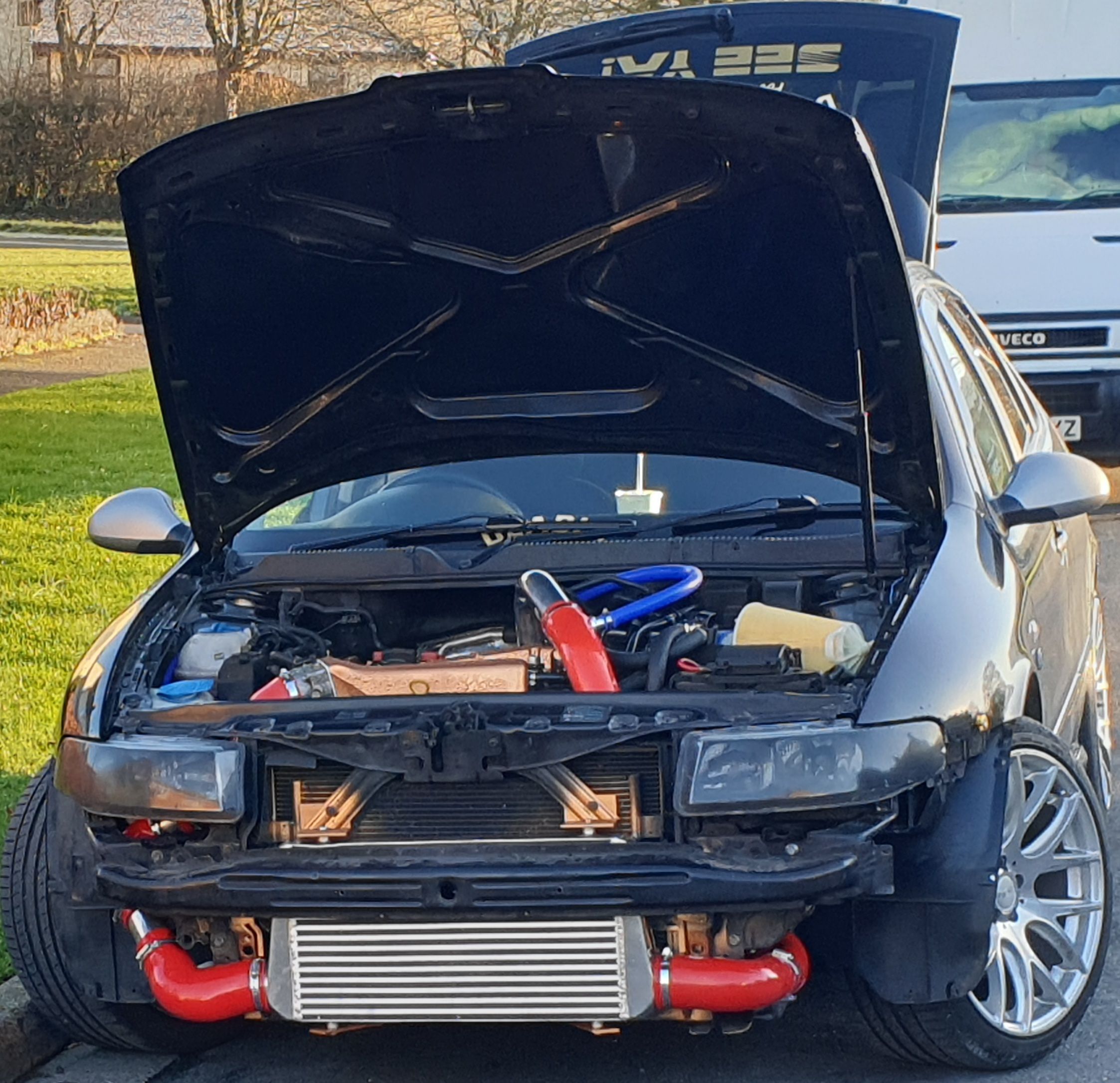

Just finished installing my welly cooler setup today, took it for a blast down the road and sounding sweet and pulling hard!!!
Reactions: Rich.T
Personally I prefer to cut things the right size so they actually fit without been forced into place.
Sent from my SM-G986B using Tapatalk
Unfortunately the 63mm to 51mm reducer doesn't allow too much trimming as I still need a jubilee clips worth of silicone to clamp onto.
This combined with the huge alloy 90 bend from creations motorsport makes it a little tight and I dont want to cut the beaded end off the 90 alloy because then im in danger of the boost pipe blowing off.
The way it sits is actually ok because there are recesses in the underside of the bonnet which is conveniently where the boost pipe is so it has minimal contact with the boost pipe.

It was a combo of creations motorsport and ASH hoses for all my pipework. I actually didn't need as much as I ordered because the creations motorsports alloy pipes are massive! Hence the height of the boost pipe people are commenting about. I physically can't get it any lower but it doesn't affect anything so I'm happy. So here is a list of my parts in order from turbo round to inlet:
63mm-51mm silicone reducer (for top of turbo housing)
63mm 90 degree alloy elbow
63mm 45 degree silicone elbow with n75 and DV self seal take offs
63mm 90 degree silicone elbow
63mm alloy coupler (100mm long)
76mm to 63mm silicone 90 degree reducer
Then the intercooler (550x300x76)
76mm to 63mm 90 degree silicone reducer
63mm alloy coupler 200mm long
63mm forge map sensor tube
63mm inlet to intercooler silicone hose
I used the jcs hi grip jubilee clamps to secure
Pipework cost about 140 quid
Intercooler cost 80 quid
Clamps cost about 20 quid
Its the take offs and the forge map sensor that add cost on as these were an extra 70 quid so complete setup cost about 300 odd quid but as I said I bout extra that I didnt actually need so I have 2 spare alloy 90s aswell as some silicone bits.
I know what ur saying about the charge pipe going over the rocker cover but I've bought some heat tape that will hopefully help keep things fairly cool
