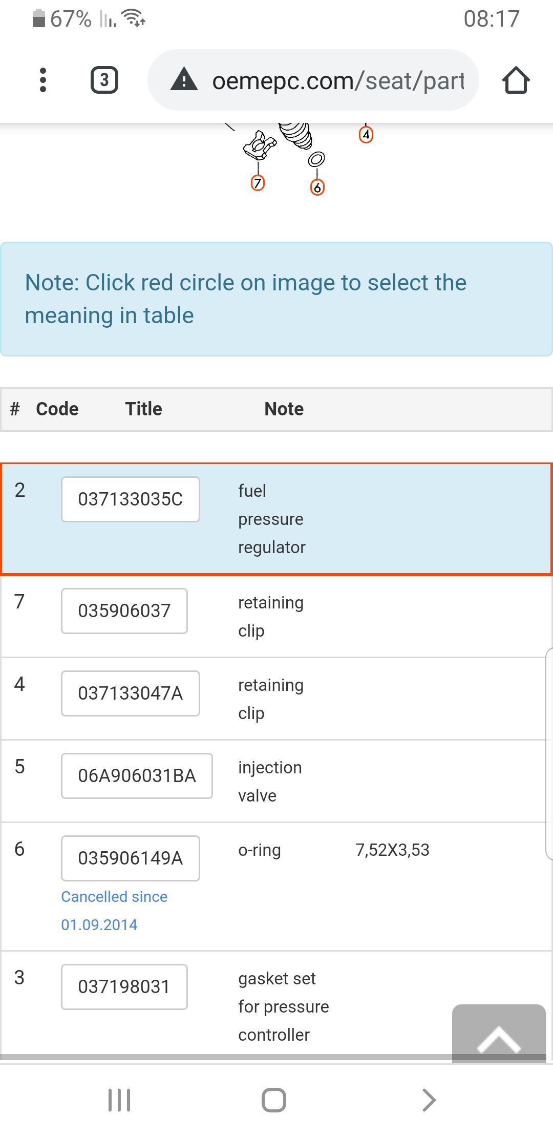

Looked at the FPR Fuel Pressure Regulator it says 4.0 bar part no 0280160575
Should it not be 3.0 bar for a stock 1.8t part no 037133035C
If anyone knows what their 1.8T FPR has?

I don't have a 3 bar so would need to buy one, just wondering if that could cause the rich running. It all looks stock. Not sure now if it it came with 4 bar as it's a VAG one

Yes it could cause it to run rich.
The ibiza never came with 4 bar FPR.

Just put in an second hand, VW 3.0 bar 037133035C FPR
Then reset the fuel trims in vcds
WOW, so much more power than with the 4 bar, 30% more, I would guess.
It now lights up the tyres in 1st, 2nd and 3rd gears, it's crazy fun to drive it again, even got the back out a little on a bend I was going so much faster, before it would bearely spin in 1st lol.
Thanks, so much for all your excellent advice on this, I would have never thought the wrong FPR could rob you of so much power.
