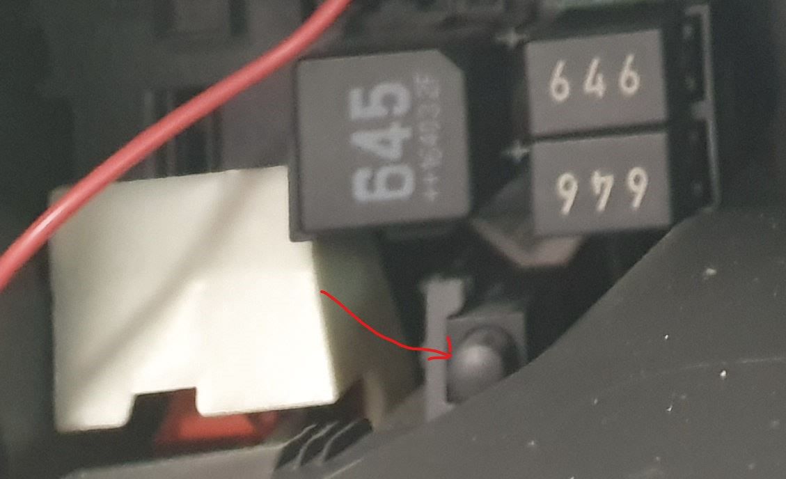

Can you please tell me where is exactly switch near lid hinge? ( if possible on picture)
thanks in advance
Walone
Feb 10, 2016
1,715
507
Near Heathrow
thanks in advance
It's just below the relays in the fusebox but may be different on LHD cars.

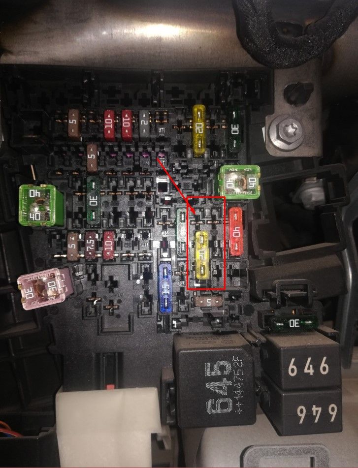

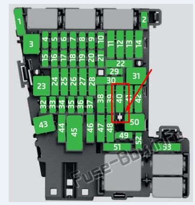

Hi, hinge is ok , i remove the glove box ,
one suspicious thing on fuse box is this - see attachment
according the schema which i found on internet see that all fuses are on line
in my case fuse 40 is shifted down , also on schema i see connector there

Fuse 40 is for the 12v sockets (or cigar lighter if fitted), when it is in the down position they are ignition controlled, when in line they have a permanent feed.
