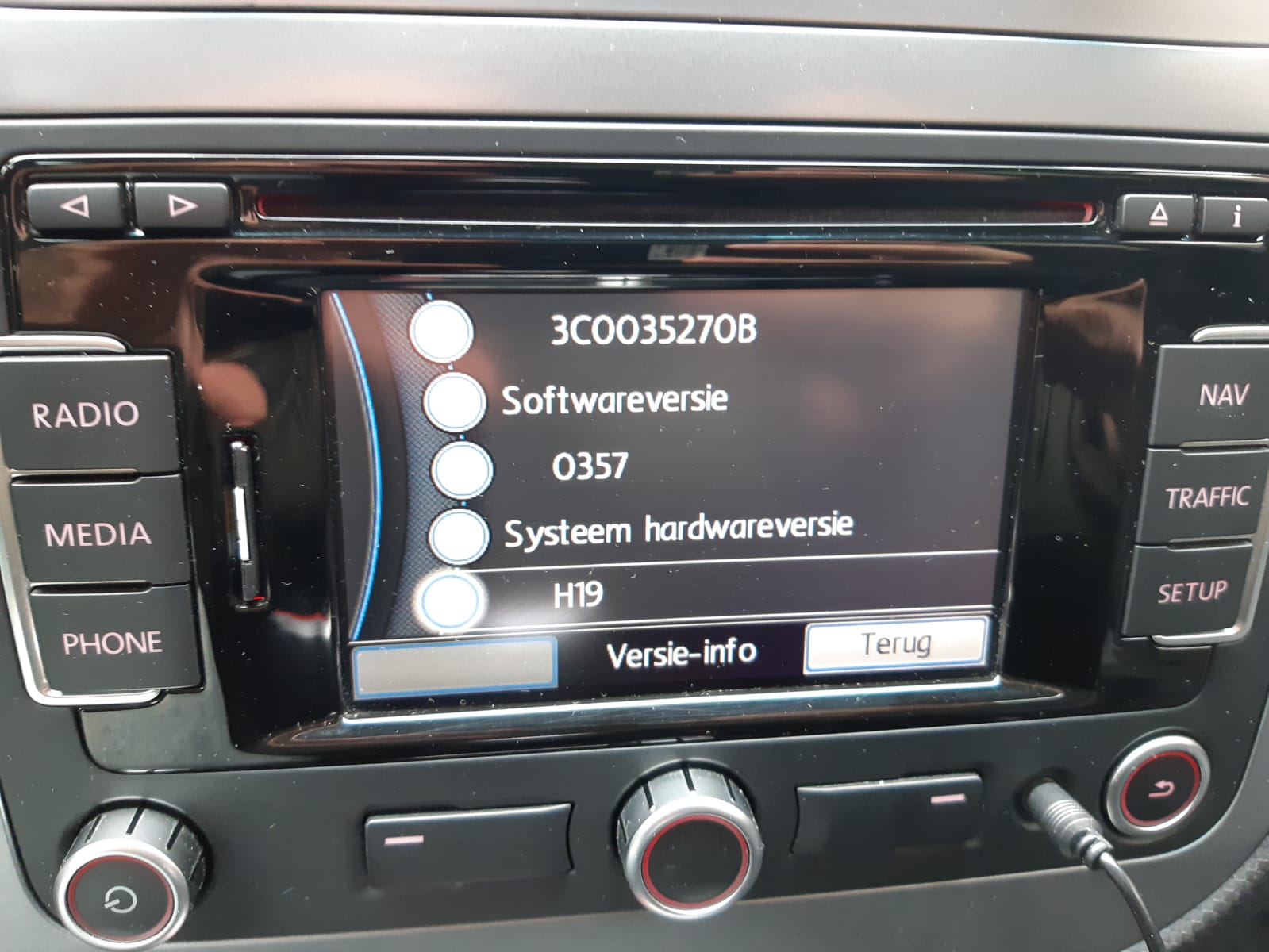

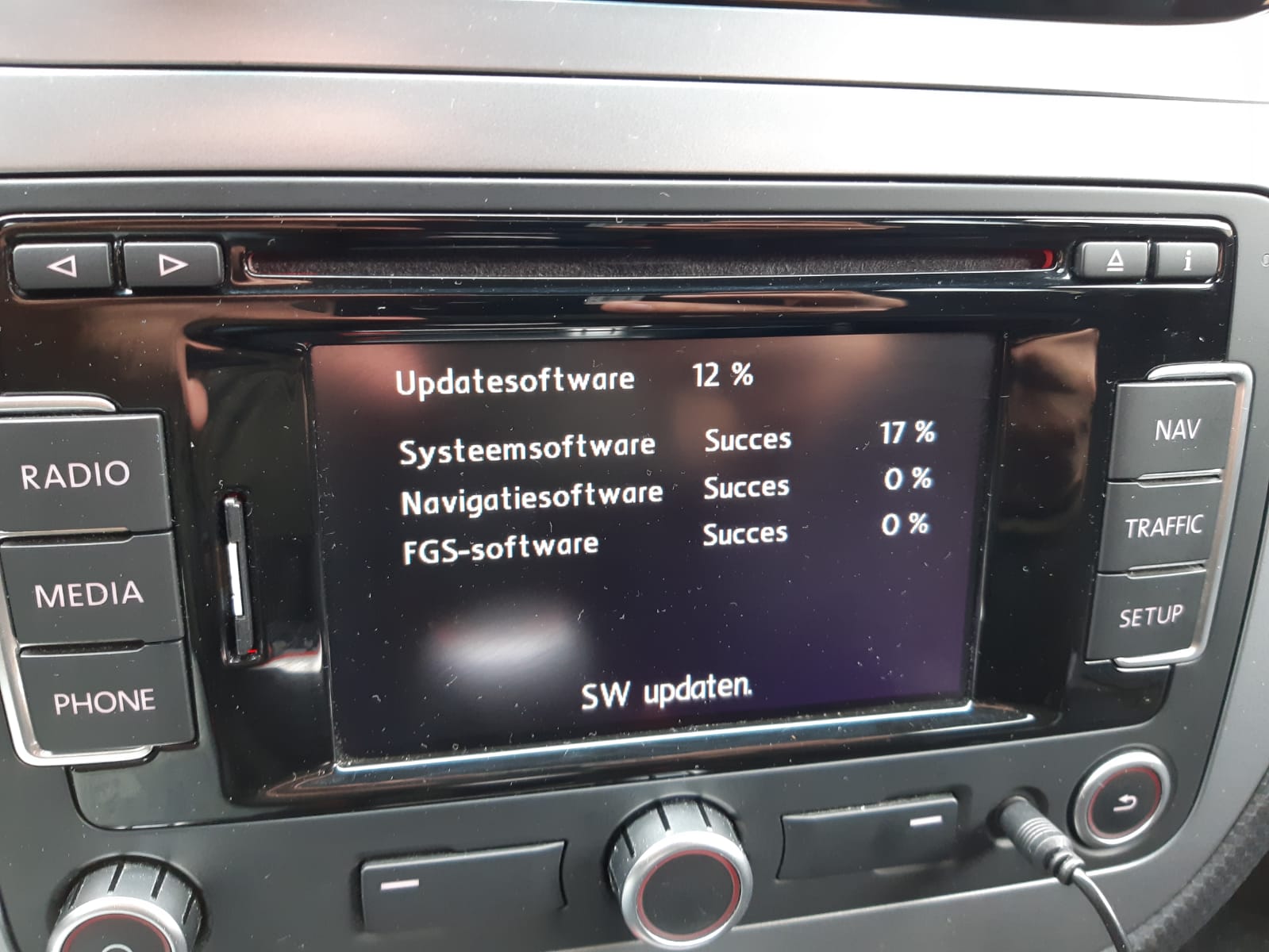

Thanks did a update from 0353 to 0357 the performance on the touch display is better now.

Just done mine today. Went from 212 to 357 as guide. Works great, just need not to panic when blank screens show for a while.

Just done mine today. Went from 212 to 357 as guide. Works great.

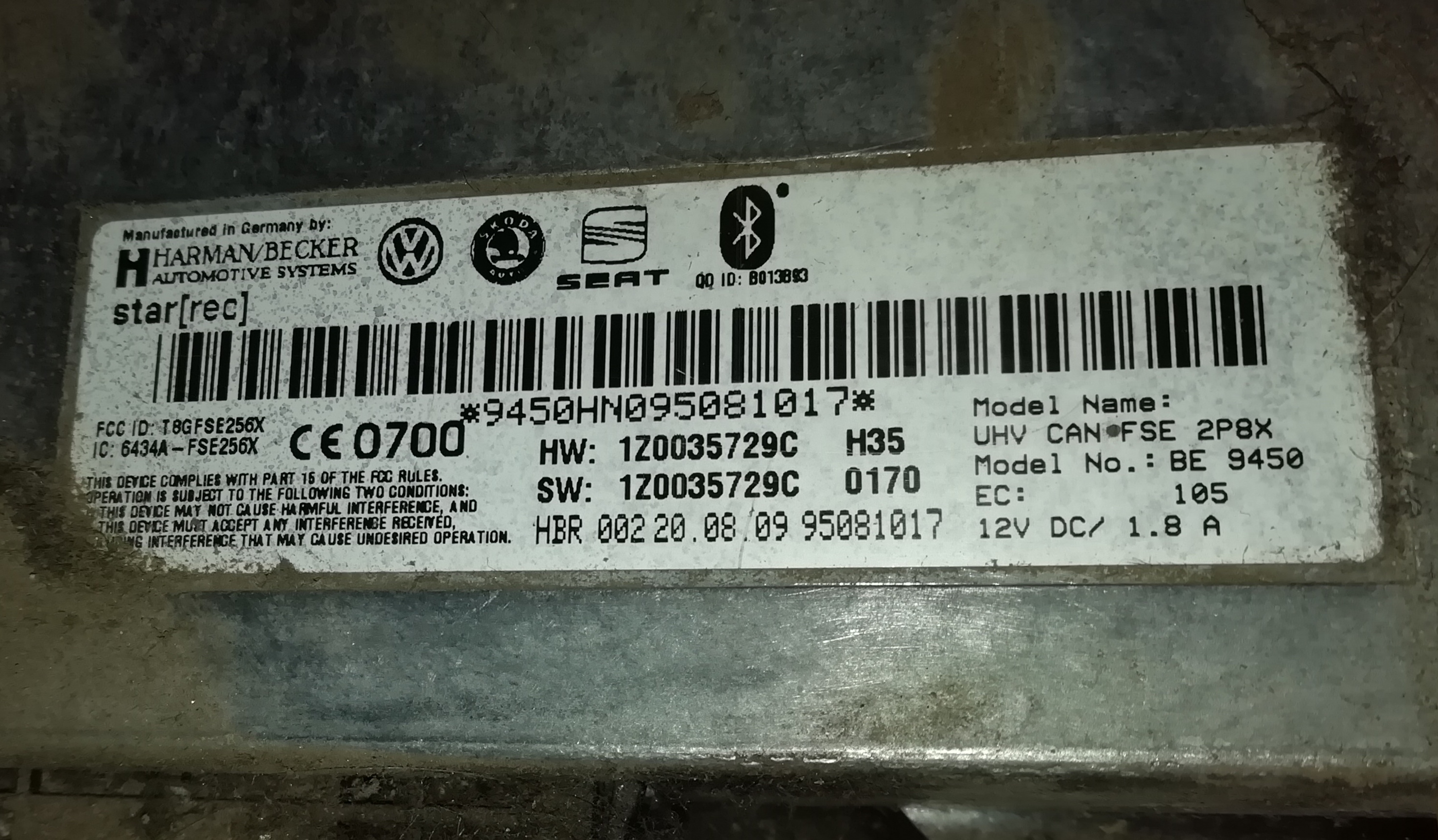

Attached is the version I have.
Which one on that list would be best upgrade option? Just to add Bluetooth streaming to what I already have. Car is 59 plate.
Looking at
3C8-035-730-D UHV-Premium
Novero HT-5 9IC/9W4/9ZG
9ZU/9ZZ BAP Yes Yes Yes Yes Yes 22/2013 WiFI Support
But not sure.
