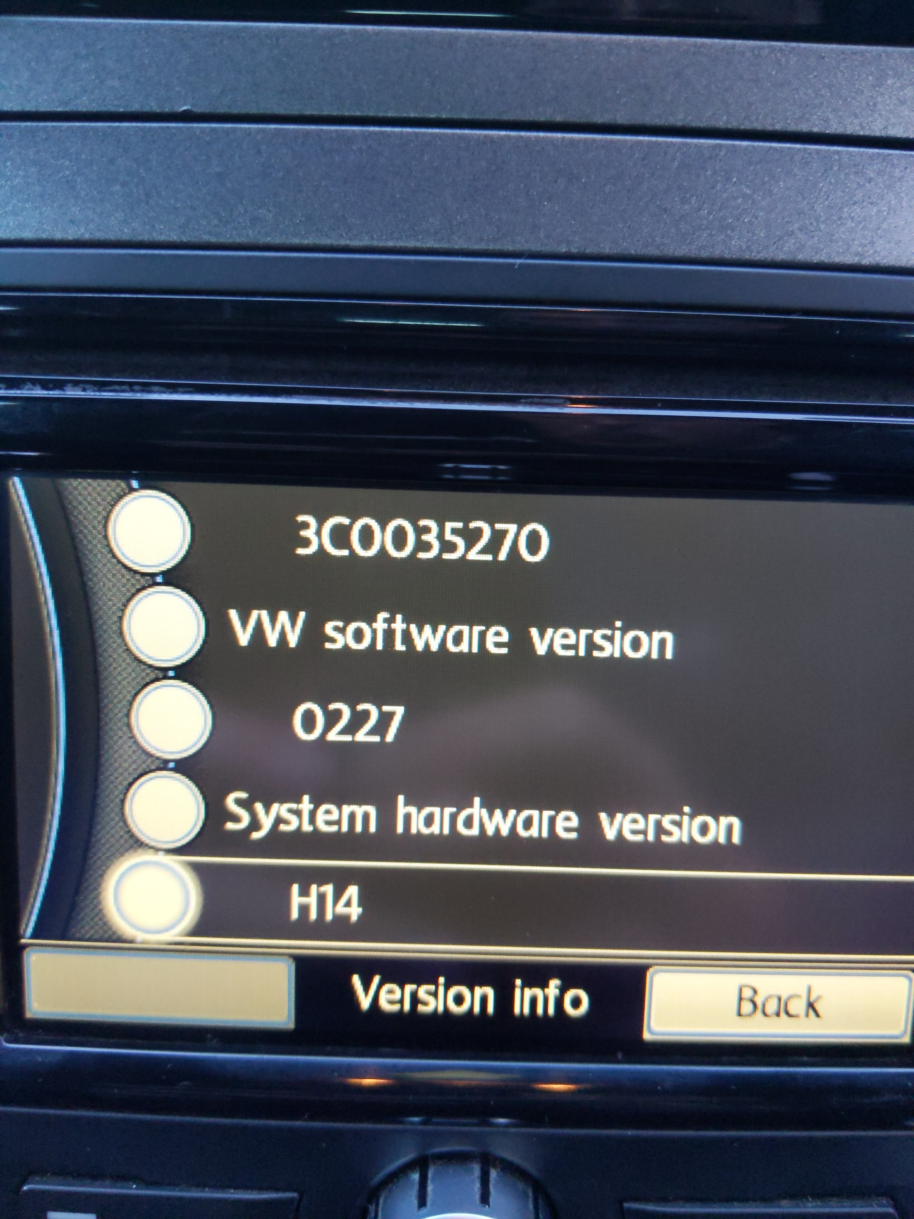

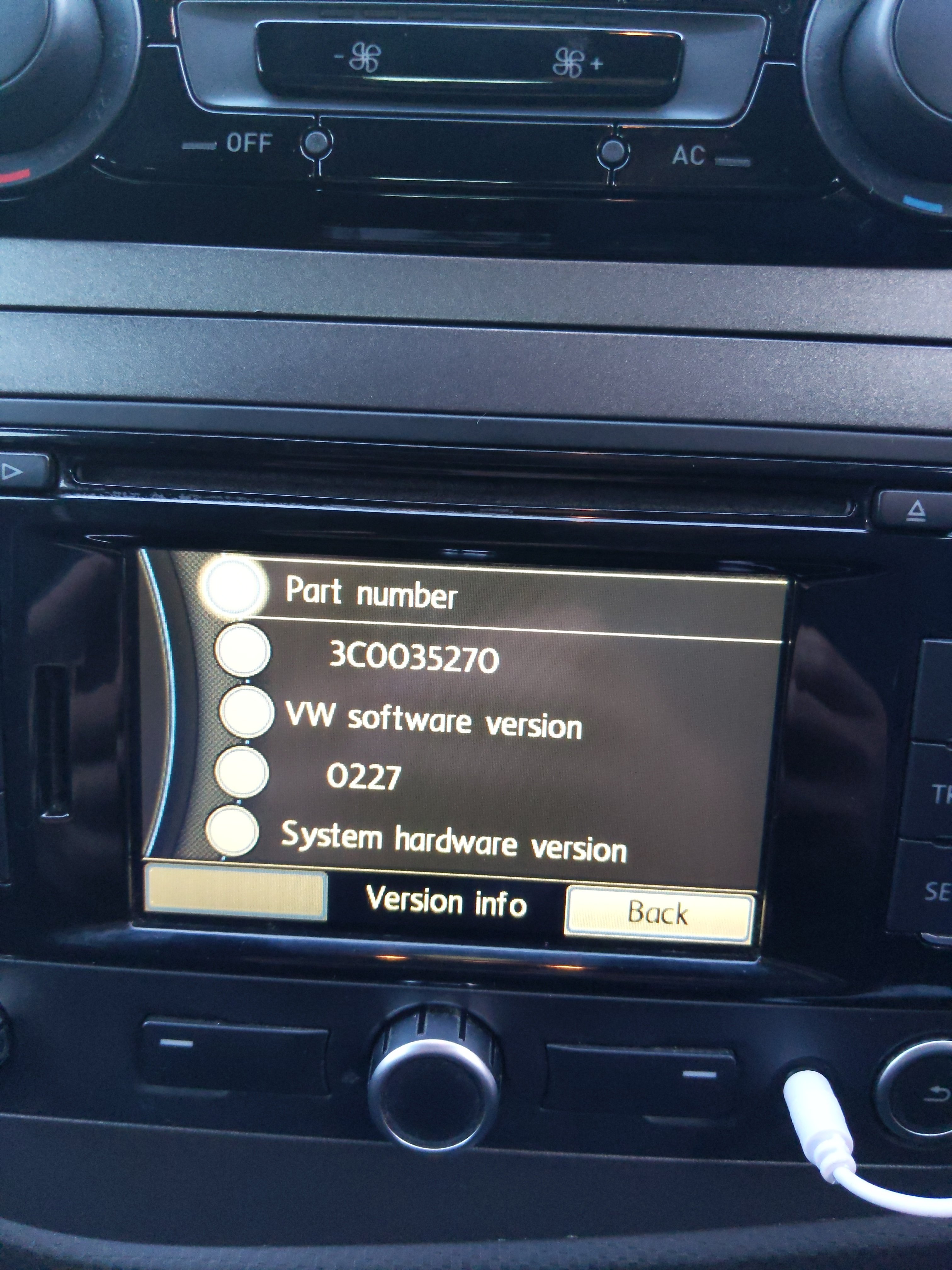

Hello, just got a Leon with RNS310 fitted with version 227, can anyone provide me working links for the update? Thank you!
Does anyone have the latest links which work to update this from 0227, I bought and fitted an rns310 today but is clearly old firmware
I may have something... Not sure what I had to begin with though...
This is mine
