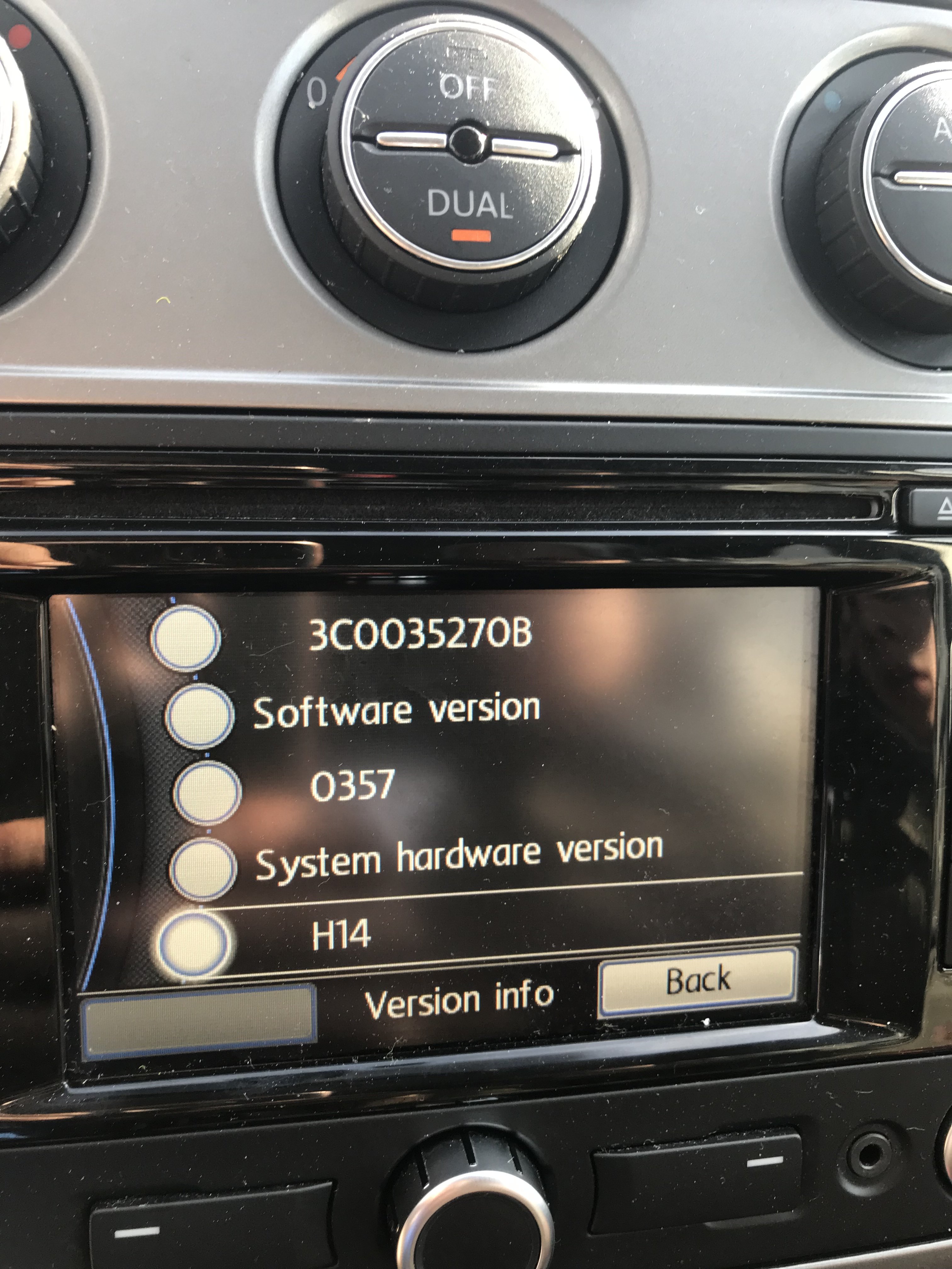

If you hold down the setup button for 10 seconds and select versions what info do you get?

Yes i did run the first cd twice exactly just mentioned in the first post
I assume you have the module for Bluetooth in your car (previously paired your phone to the car) A few people seem to have this issue with the phone button muting which ended up with a faulty BT module or that it's not coded in with VCDS.
