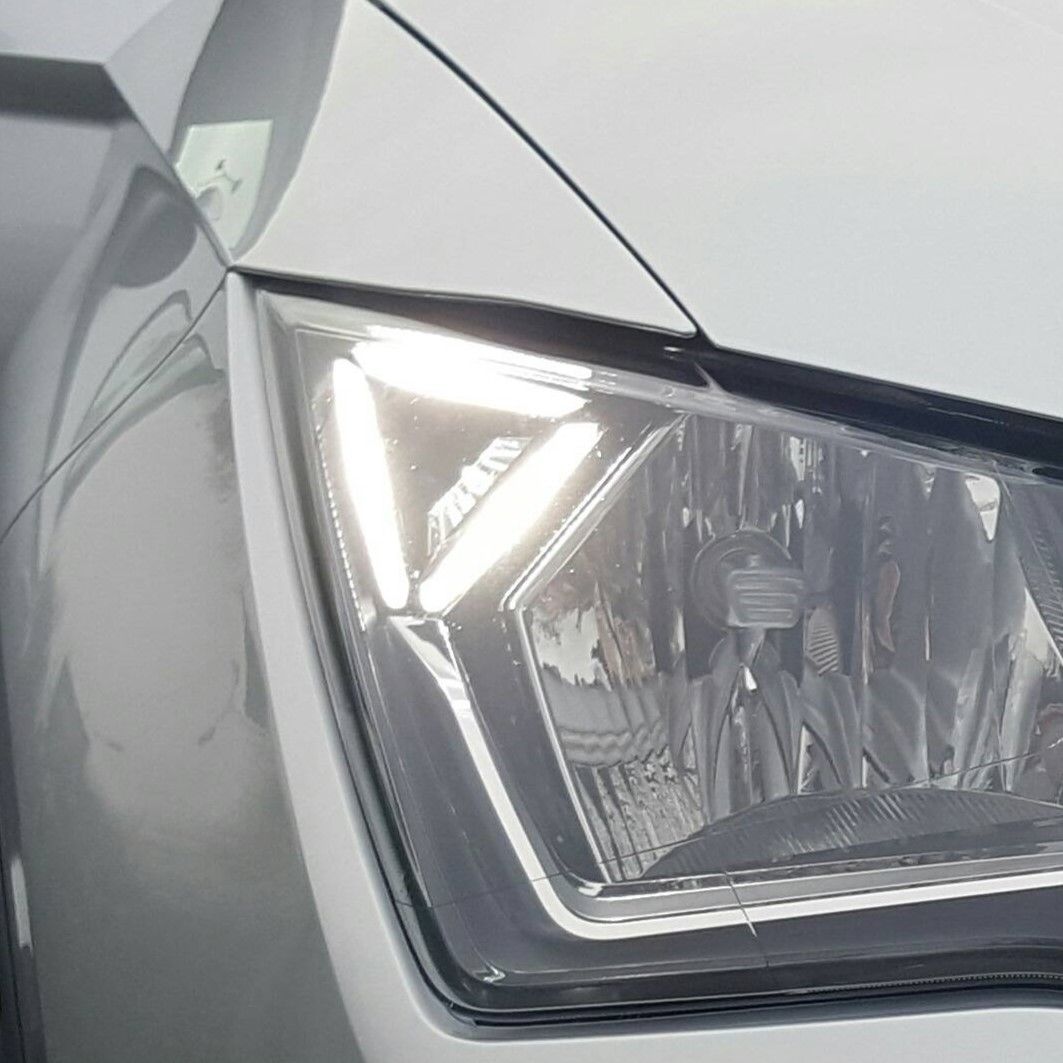

I have the halogen headlights on my facelifted ST with the LED triangle as parking light, pictured as followed;
(Not my picture)

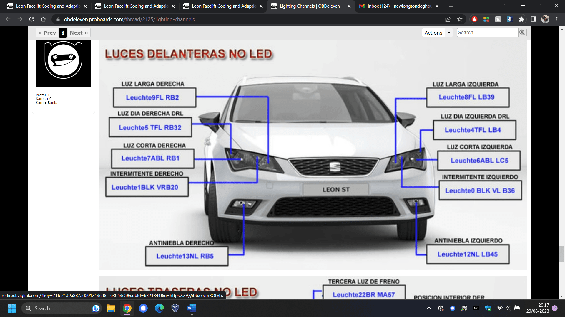

Yes, absolutely it will be possible. From the attached picture, low beam will be found in the central electronics 09 mocule under leuchte 6 and 7. Look at the Lichtfunction of these bulbs, and you will find they are coded for DRL, with dimming value set at 100
The triangle LEDs are Leuchte 4 and 5. Again look at the Lichtfunction of these. If you need to, add the function of the DRL to Leuchte 4 and 5, and remove the DRL function entries on Leuchte 6 and 7. Set the dimming value for the DRL function to 127

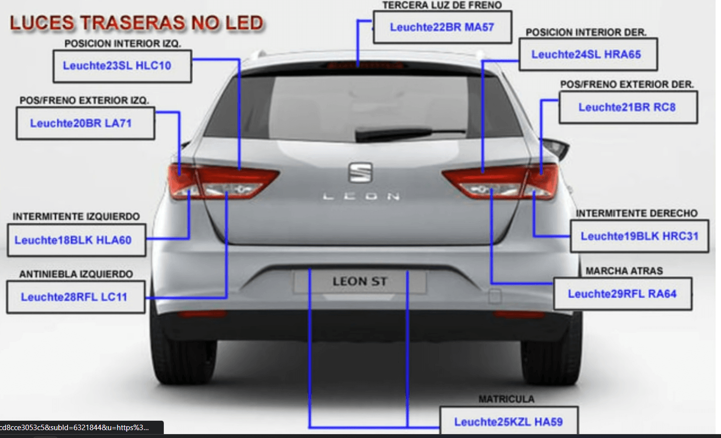

It is also possible (as I have done on my car) to program the rear lights to come on with DRL. Simply add DRL functions to the 4 tail lights, which from the second picture are Leuchte 20 & 23 (left) and leuchte 21 & 24 (right), also Leuchte 25 for rear number plate lights

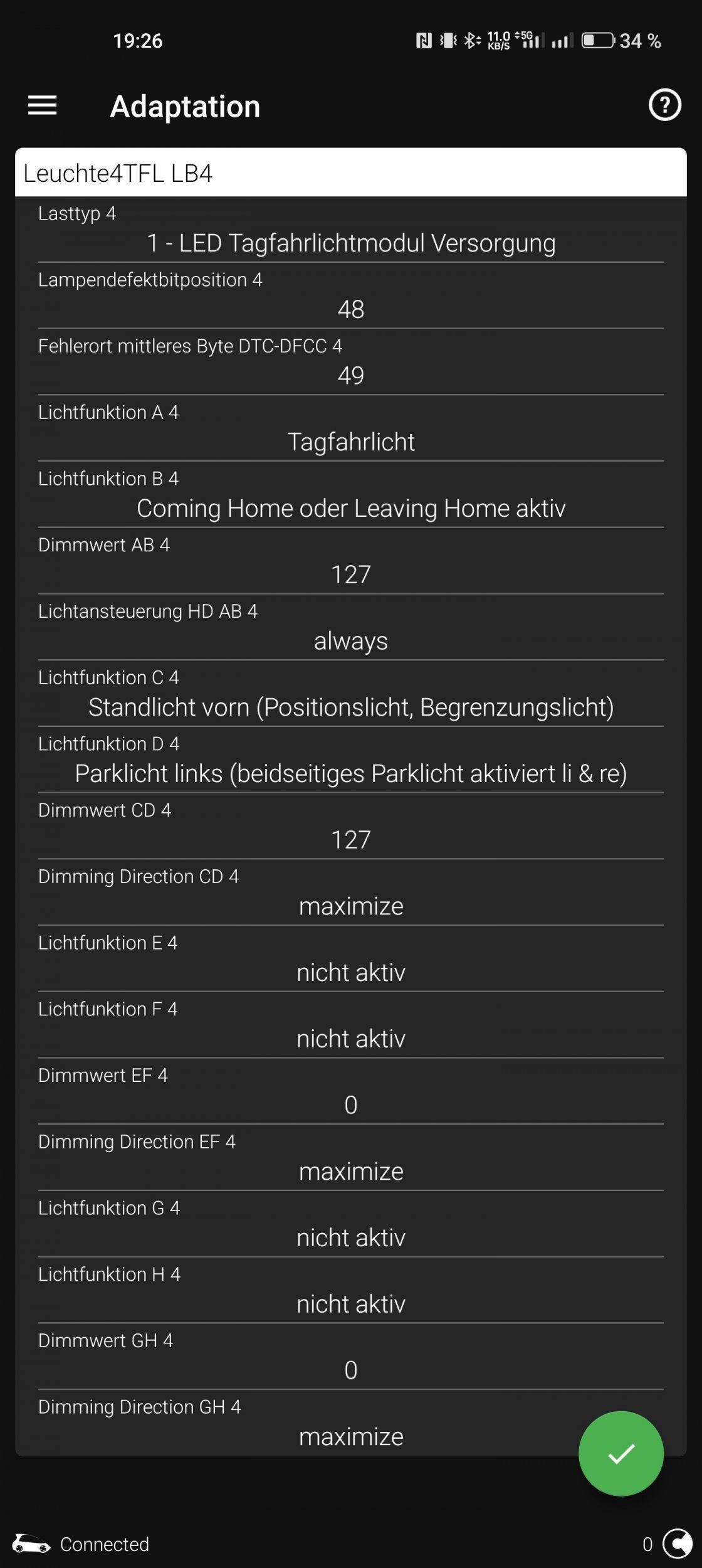

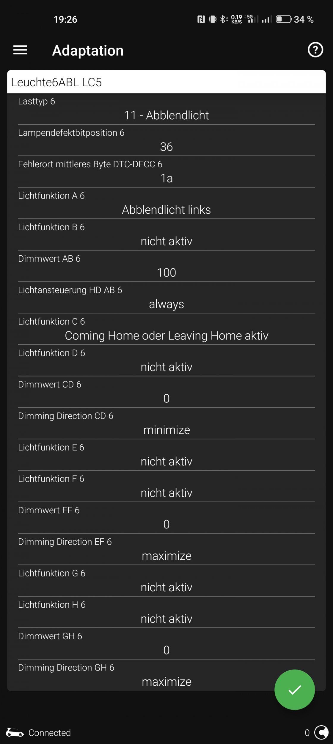

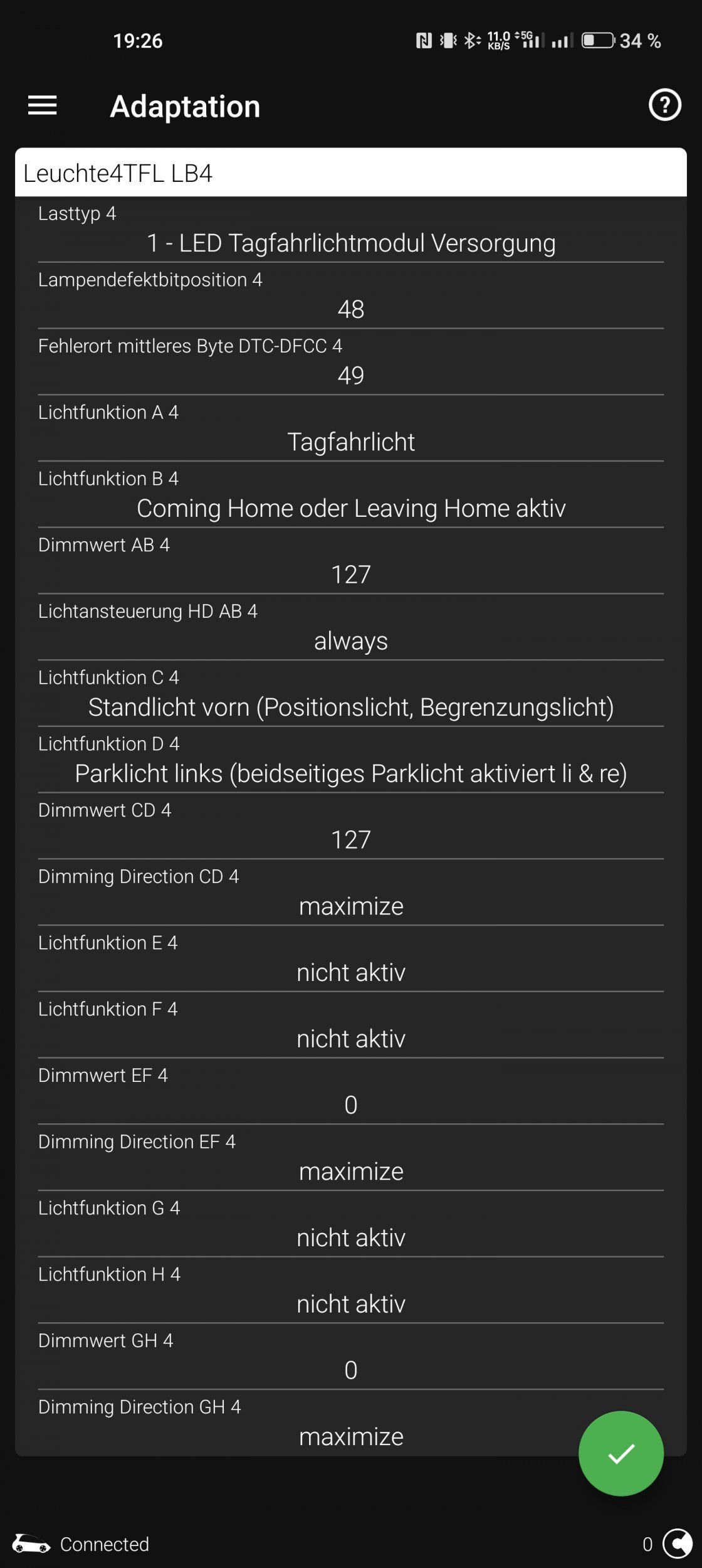

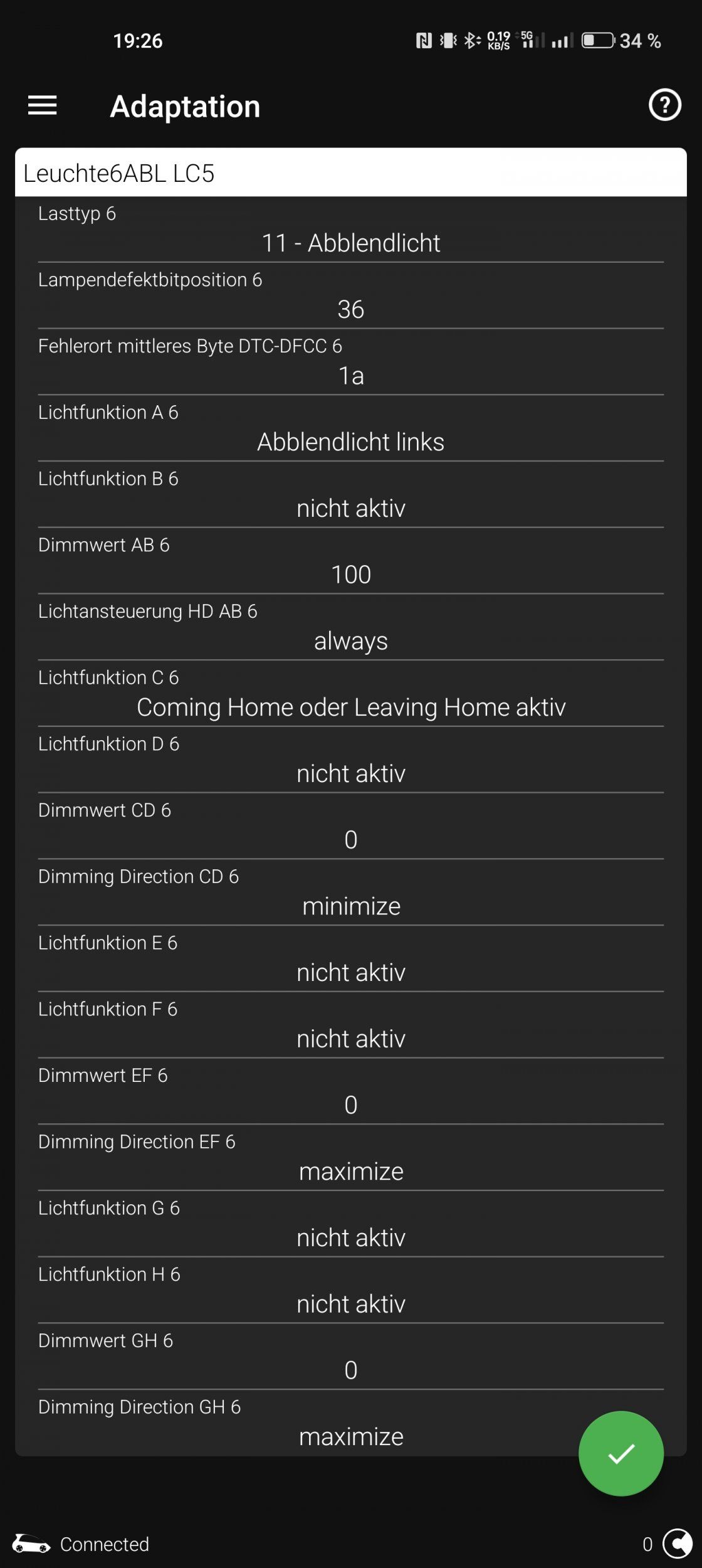

Here's how it looks on the left parking light and the left low beam,
Managed to find a solution to this after playing around a bit.
So if anyone comes across this in the future, there's a menu under central electrics>adaptation called "Aussenlicht_Front" where I had to change the settings for DRL.
This is how I believe they work, mine was set to the middle option which is why it used the low beam;
View attachment 39007 View attachment 39008

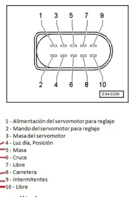

Bonjour j'ai une Seat Leon 3 ST phase 1 et j'ai changé les phares par ceux du Seat Leon 3 phase 2 dont DRL triangle réf 5F1941015
J'ai essayé avec le codage
Plusieur fois malheureusement j'arrive pas les DRL ne s'allume plus
Les deux phares ont le même connecteur 10 broches
J'ai changé leuchte 5 et leuchte 4 pour la droite j'ai essayé avec multimètre la sortie 4 est de 12v
Merci de votre aide cordialement
