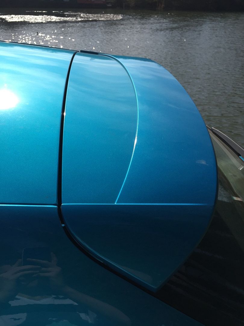

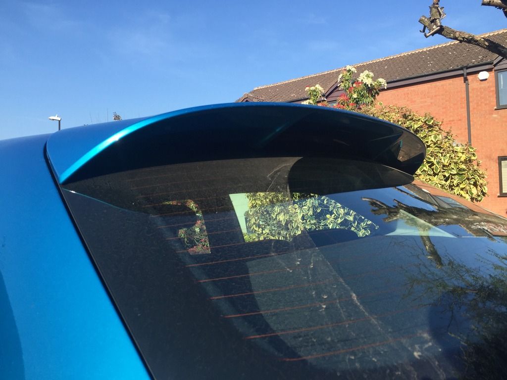

This is my spoiler, brought direct from seat for £160 primed, then painted by a friend using paint from VW to match my paint code :)
Can take more photos if needed, although the cars a little dirty at the moment :p

This one fits waaay better...
The carbon dipped one genuine Seat? It doesnt fit well.

Bit of a difference between the two...

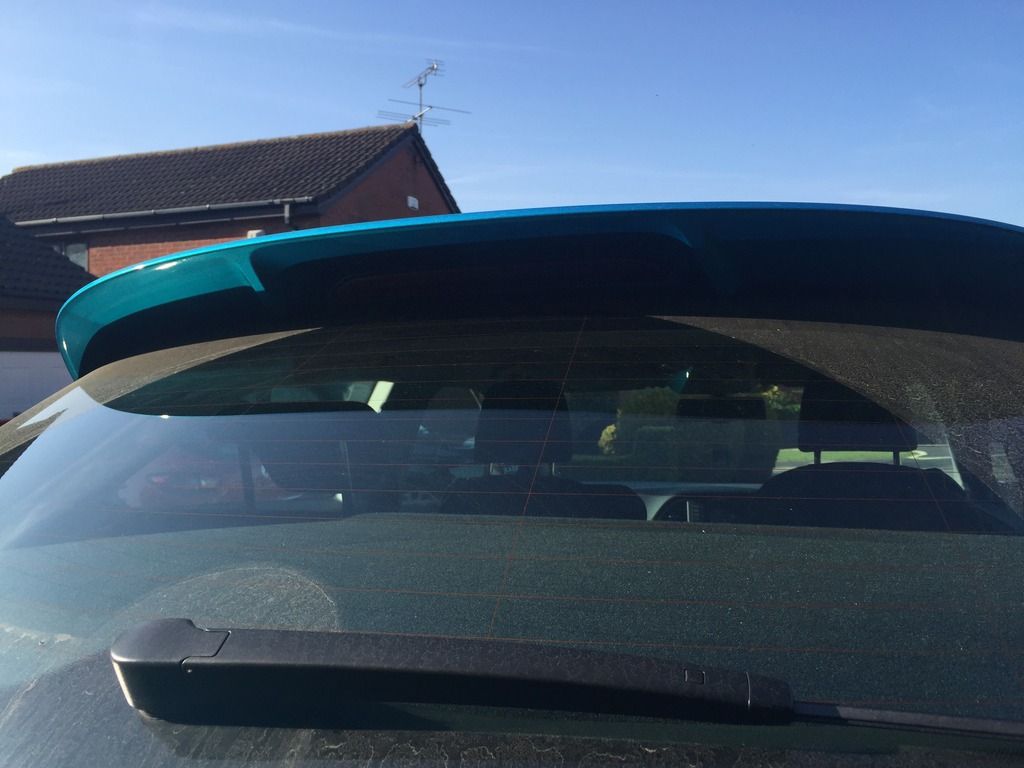

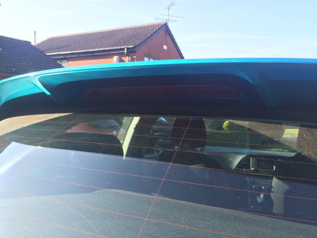

Tommy what does it look like from the rear, looking up at the bottom please?

Hopefully these pics are what you are after :p sorry they are a bit dark, can always take better pics if needed :) car needs a BIG clean too!!!! haha
Who did the fitting and how on yours please, assume this is the spoiler I was looking at at £399 painted and fitted from the dealer. Also which dealer did you get from primed?
I brought the spoiler from A Seat dealership in Birmingham, next to star city, for £160 primed and including the fitting kit. I then got it professionally sprayed in a body shop for £80, then I fitted it myself :)
Excellent, thanks so much... Tommy95 Stuck with tape only?
Most welcome, yes and no, they supply a fitting kit, which includes some thin foam strips you stick to the spoiler to reduce vibrations, a tin of alcohol rub to clean the surface, and big tube of a really sticky glue, and trust me it sticks and goes of very quickly, if you get any excess glue on any paint or your fingers remove it with the alcohol rub ASAP! Then just tape it to hold it in place while the glue goes off. So yes you use tape to hold it initially, but after 24 hours the glue will hold it in place :) Any other questions just ask :D
