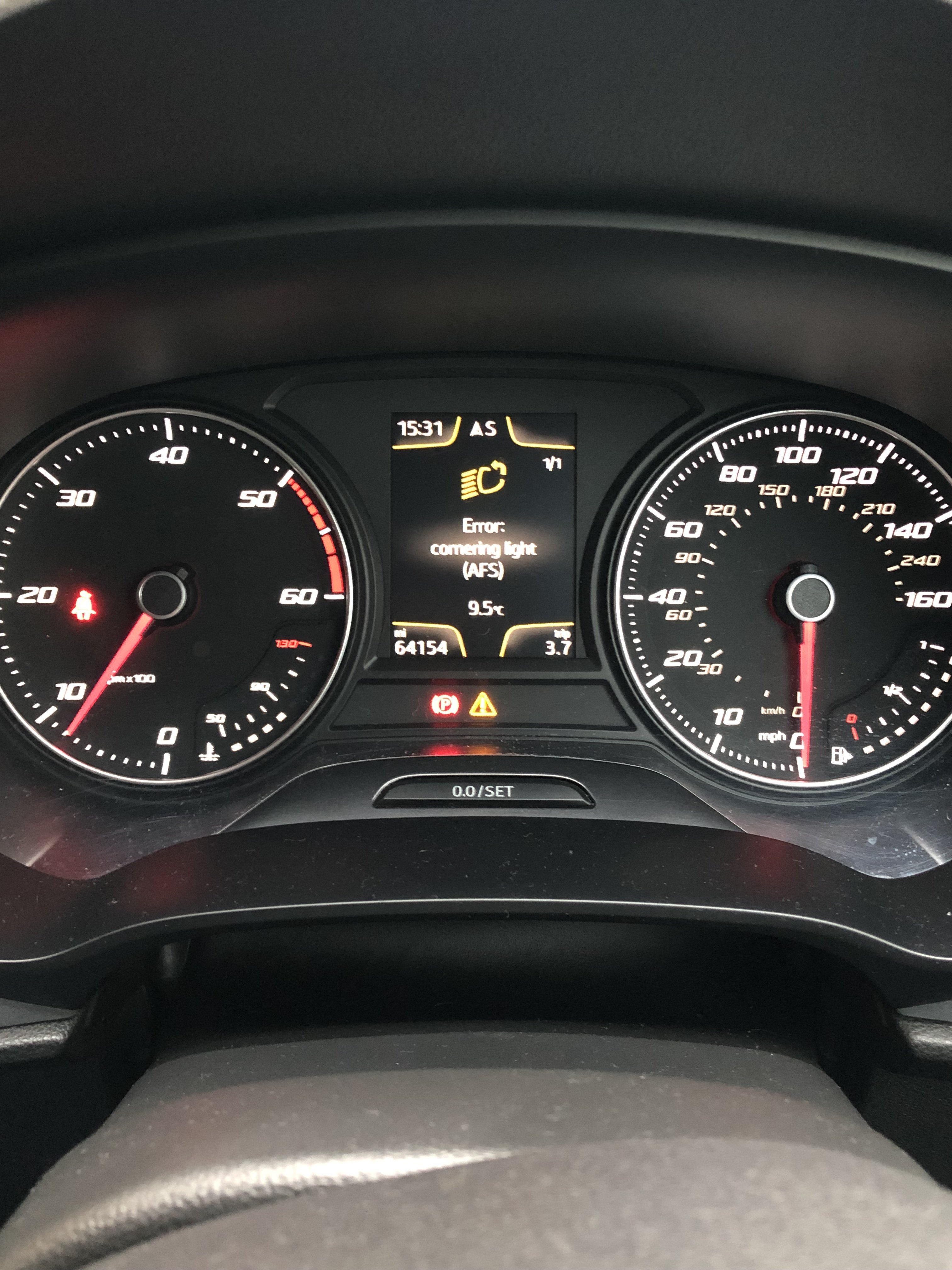

Ok so I swapped my old headlight range control module for the new (second hand) one. Same warning came up and this time neither headlight moves, even on start up they both just stay static. Also, my option in the menu for turn on/off motorway lights has gone completely.
So I swapped back in the old one. And here’s where it gets even more confusing. I’ve still got 2 completely static headlights and no motorway light option, but the headlight range error warning is gone. And it’s been replace by ‘error: cornering light (AFS)’ displayed on the little screen between the dials. And if I look on the main screen it says ‘error: bend lighting (AFS)’
I don’t even have corner/bend lighting. :censored:
