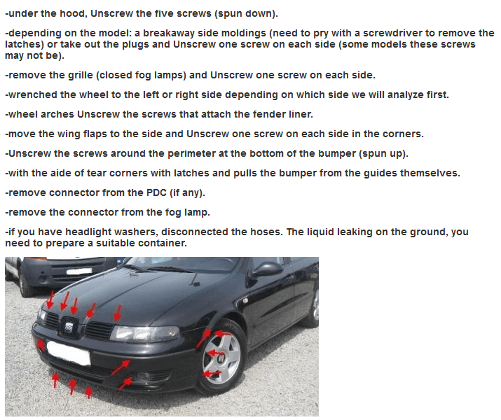

I recently bough some aftermarket cupra bumpers for my leon stella mk1. (front, back & skirts)
The thing is, im having trouble removing the bumpers because theres a few screws i need to remove. But i don't know witch or exactly where...
I removed 3 or 4 screws right under the front bumper, 4 in each side in front of the wheels and the knots on top of the bumper in the engine bay.
Im guessing the ones im missing is somewhere under the headlights. I dunno if it's bolts, screws, straps or maybe knots?
Please share if you got any knowledge or tips about this. Would love your support!
Thanks in advance.
Battoussai
Mar 22, 2016
540
187
Portugal
Hi there. If I remember well, there are two screws - one on each corner underneath the bumper's black strap.
