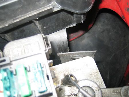

pulled over, disconnected battery for 10 minutes, and noticed fuse 3 was melted completely
couldn't remove the fuse so reconnected battery, no lights came on, and i got home ok
got home and managed to get the fuse out and cleaned up connections, took it for a good hard run, all seems fine so far, boosts fine, no lights on at all

the fuse thats melted is the abs relay, but no faults came up in regards to this,

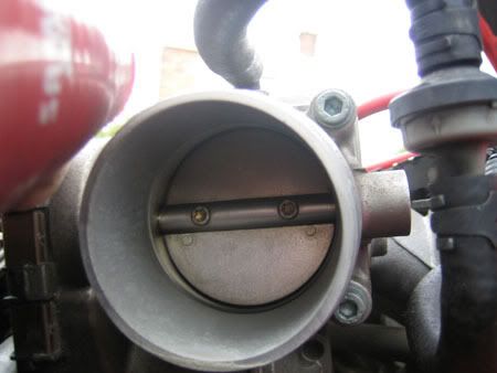

Take off the intercooler hose, which is connected to the inlet manifold.
And see what position the throttle angle is at, if its not closed you have a mis aligned throttlebody.
You could try taking the throttlebody off the end of the inlet manifold and giving it a check over.

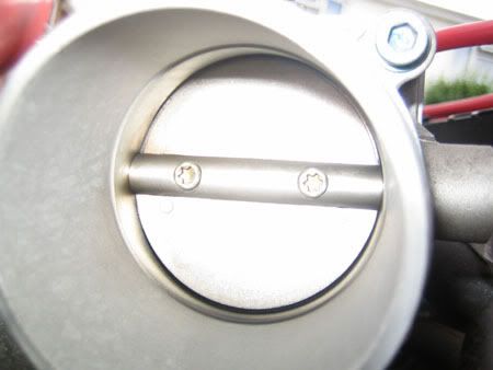

was going to clean the throttle body aswell
took it off
all looks fine, sprayed some carb cleaner in there

Open the throttle with your finger from the top, all the way and let go, see if it settles back shut or open like you8rs is. or you may have another fuse in the dash gone?
high revs when the car is hot, only started after the fuse melted and i had to disconnect the battery
will try the throttle, see if it settles back down
checked fuses under steering wheel, all seemed to be intact, checked no18 the abs and that was definately still fine
at a guess, i might need to replace the fusebox on the battery afterall, was hoping i wouldnt have to
although my fault codes dont relate to that
well it does seem to be a common problem, i think a few on here have had fires from the fuseboses. And SEAT refuse to do a recall on it.
