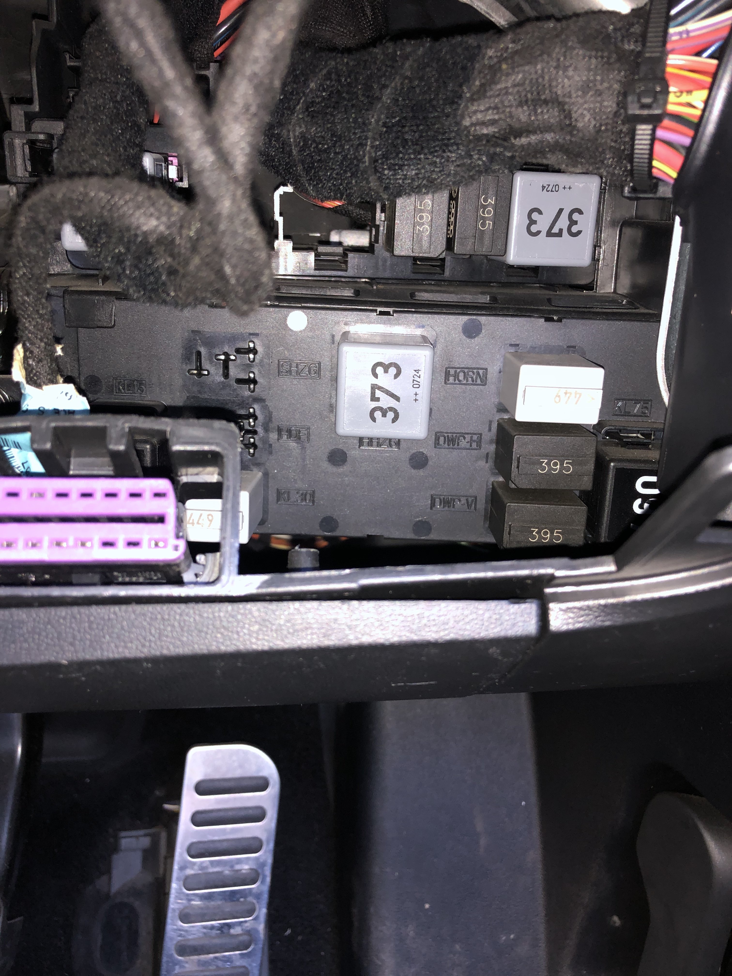

Fuse box is the panel on the right of that bit in your photo:

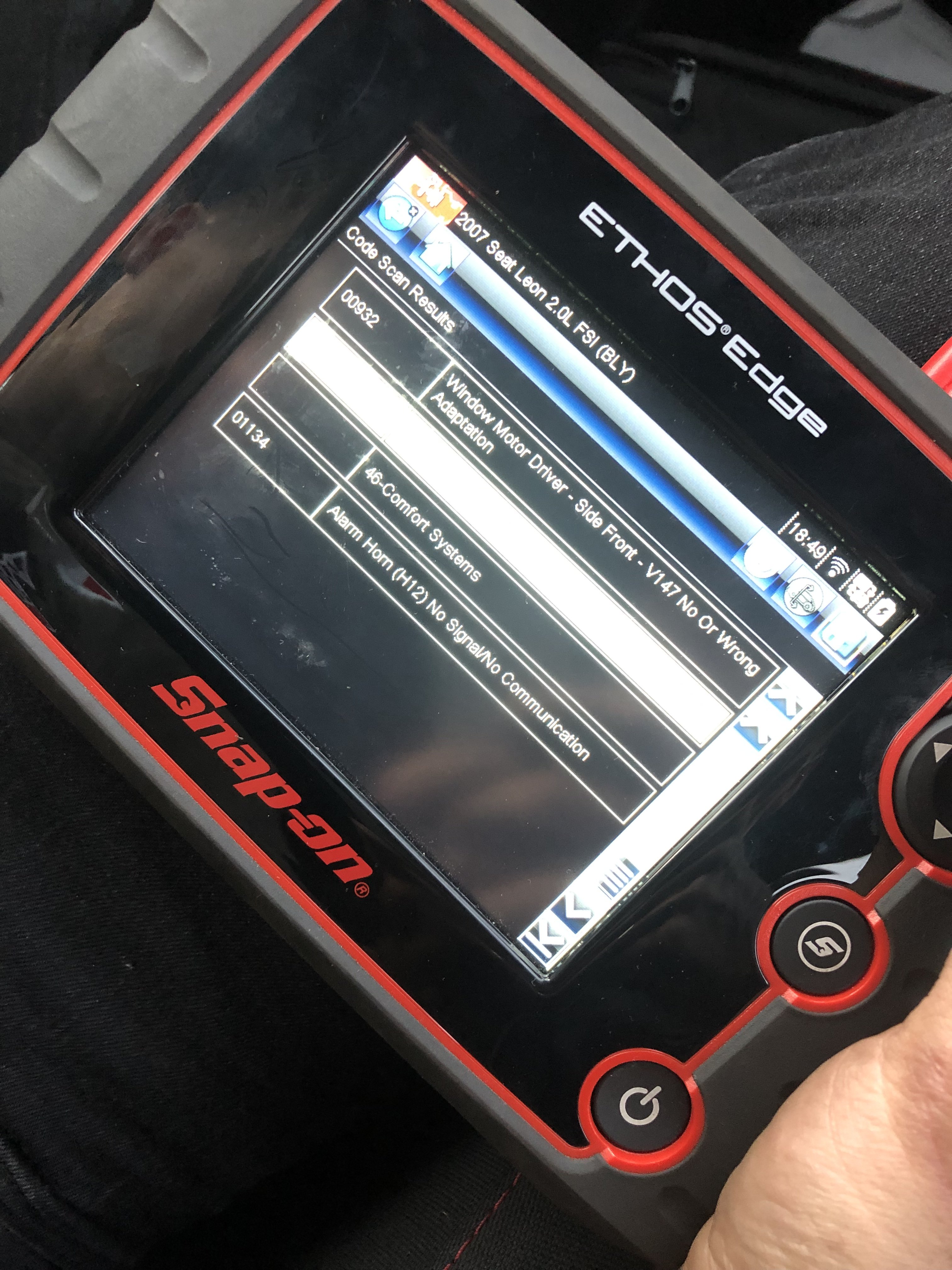

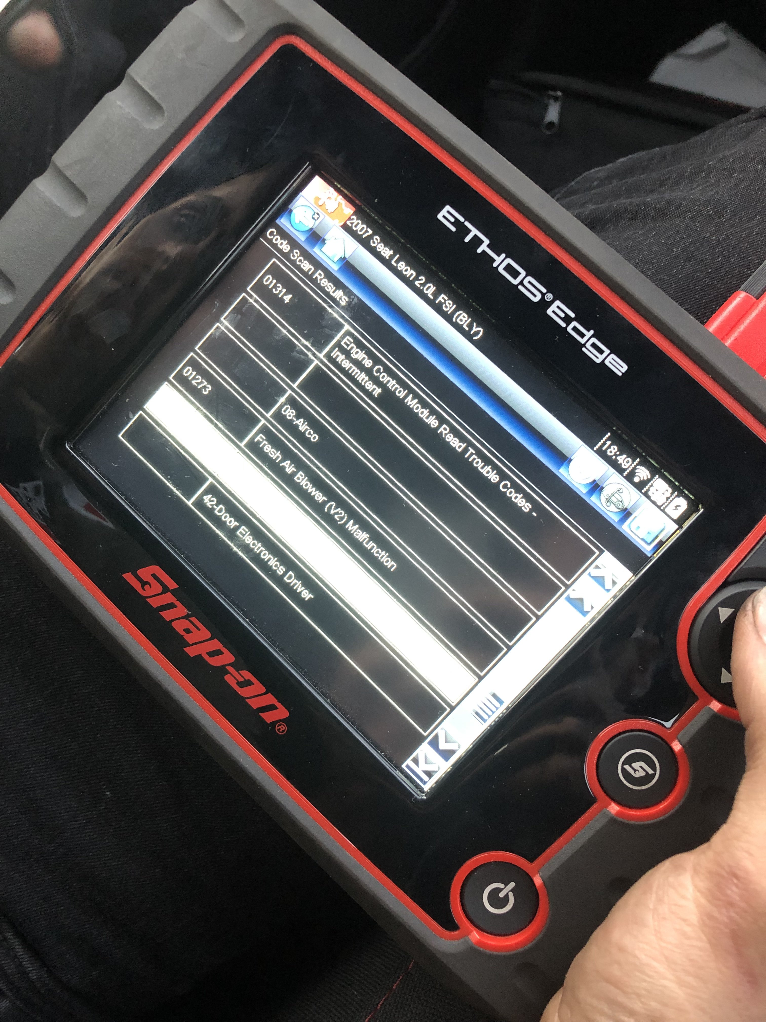

Turns out I’ve now got a bigger problem. Most times I’m driving and come to a stop the battery light comes on and kills the engine yet it starts up after perfectly fine, all fuses are good, alternator is charging and tried 2 new batteries. Scanner is saying no communication. I don’t understand what’s wrong with it at all
Have you measured the alternator voltage under load (aircon on, heated rear window on, radio on, wipers on, etc)?
Did these new errors happen to coincide with the massive amount of rain we just had?

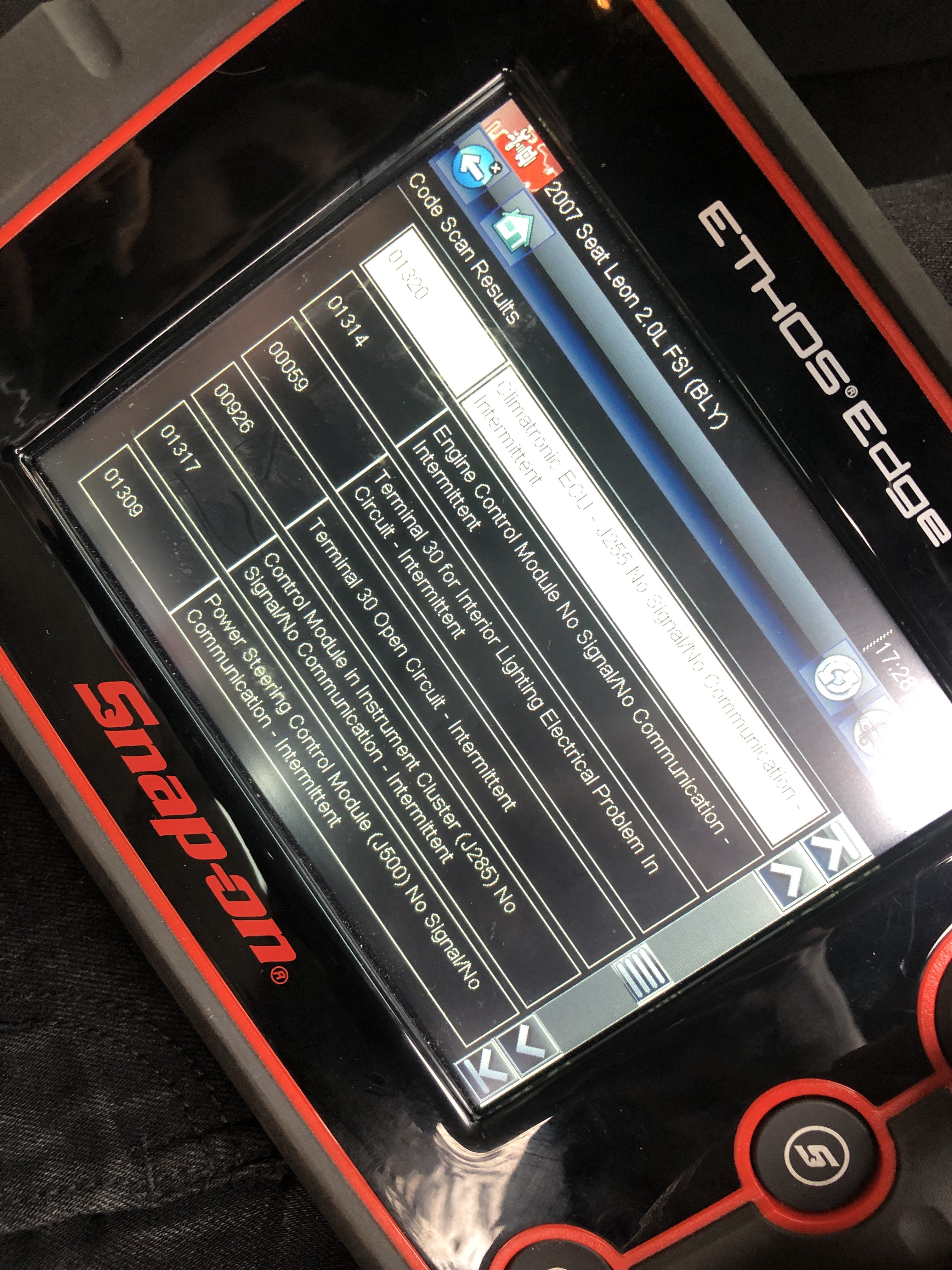

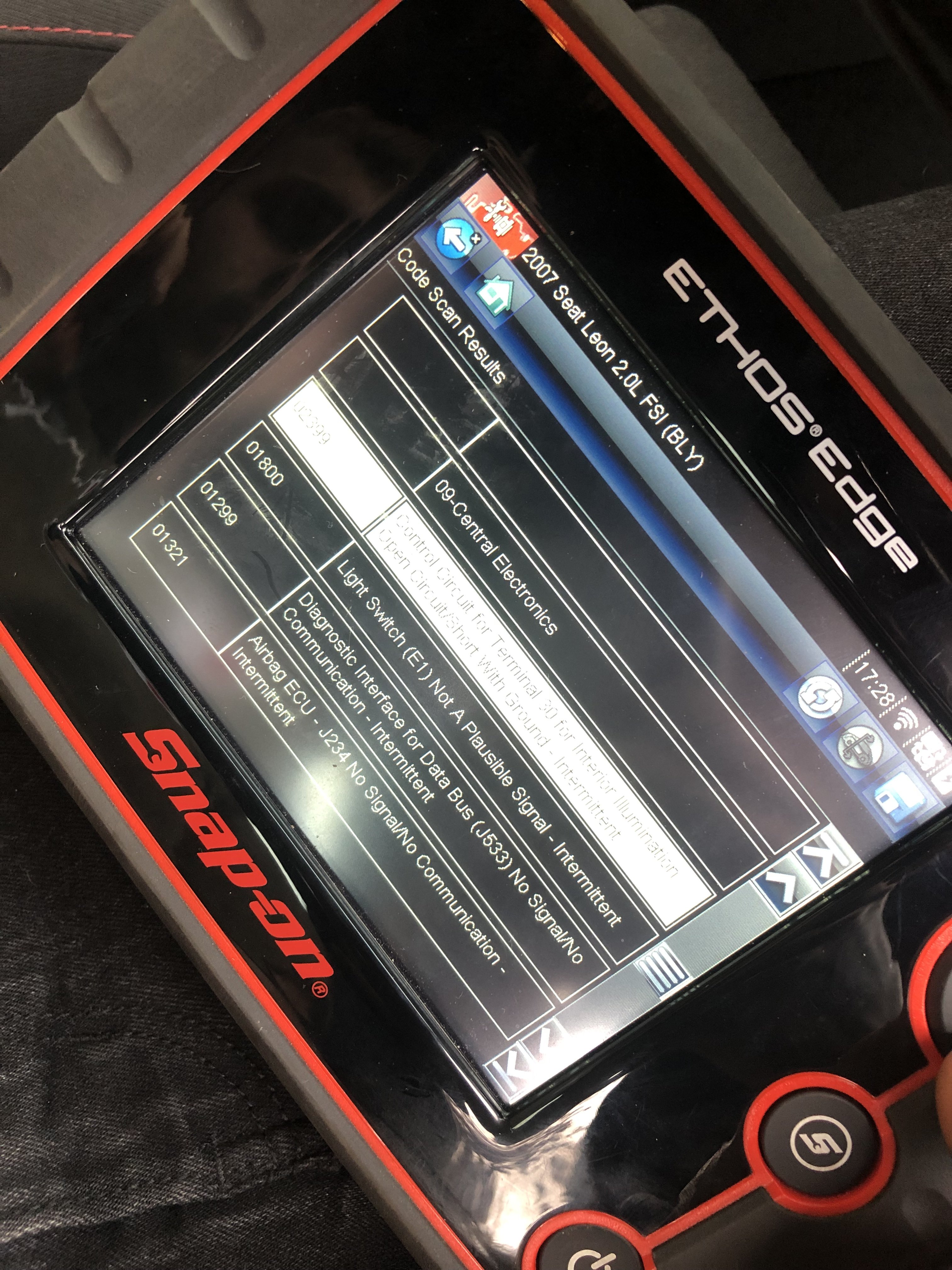

I just cleared the fault codes, went for a drive and upon getting home it died on me as soon as I pulled up. These were the only codes after scanning again. I’m so confused
Loose earth cable?
No I checked all earths and they’re good. I think I’ve narrowed it down to ECM Relay which is the R1 in fuse box (engine bay) mine is a 370 tho. I’ve been looking at others on YouTube and there’s are 460? Does it make a difference?
