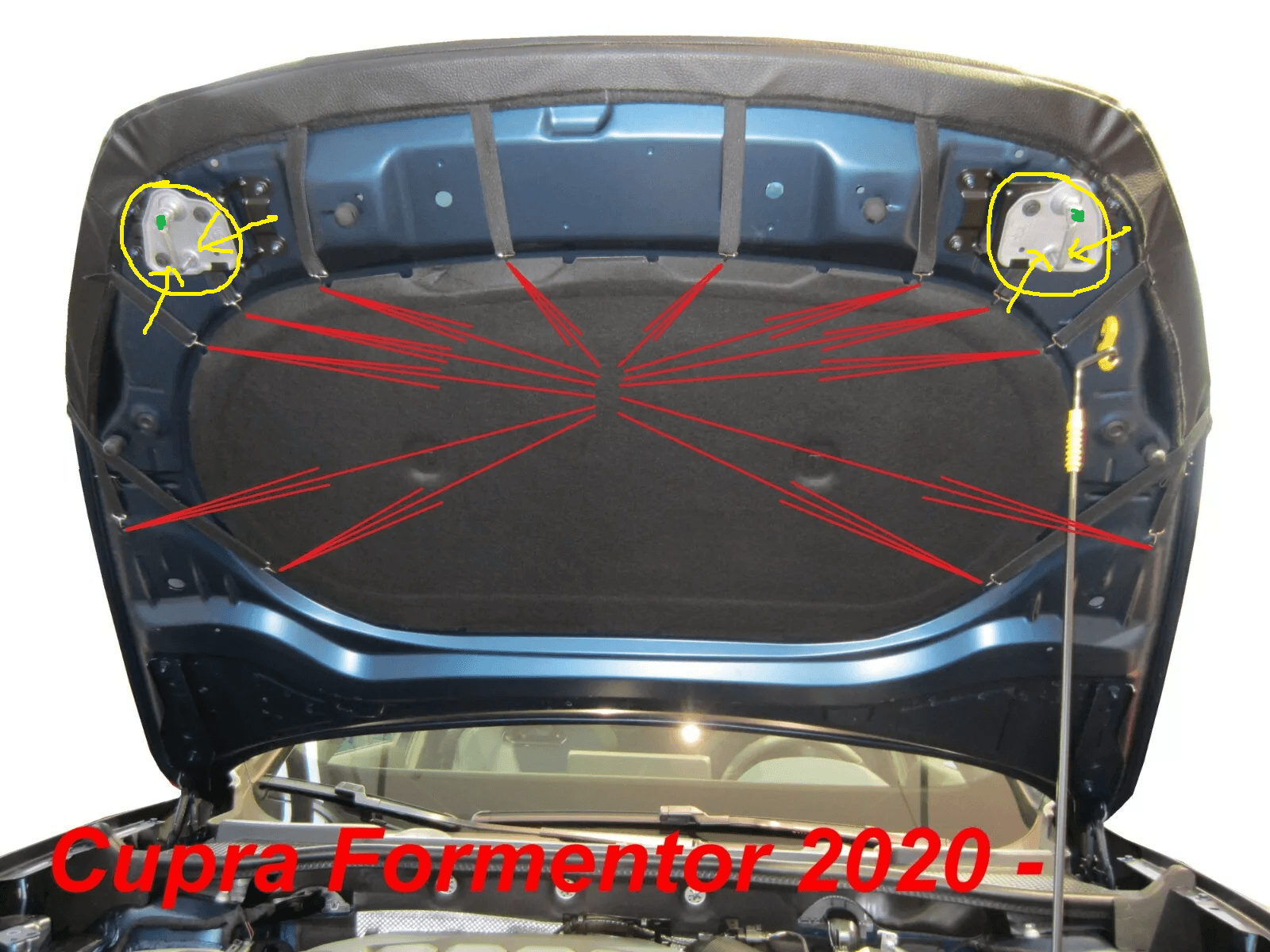

Hi,
video sound lot like mine problem which I resolved yesterday after 4 months of trying and few dealership visits.
Although sound looks like it is from shock absorbed (I though the same. Also left side) in my case it wasn't. After lots of tests I found that sound comes as result of hood micro movements while driving.
If you look at picture (i found picture on internet so please ignore red arrows) issue was in one of this metals marked with yellow color. To be more precise this side of metal marked with two yellow arrows was making click sound when pressed hard. I screwed up metal on places marked with green color and never heard sound after that.

Hi,

Thanks so much. I’ve experimented with the bonnet hinges a lot, tightened them to the max, and added some insulation. I even cut a Red Bull can and put a thin “seal” around the other part of the bonnet hinge that was making the rattling sound. Unfortunately didn’t help me at all. Rattling sound is persistent, and the worst thing it’s irregular, so you need to drive a specific conditions to get this noise.
May I ask, did you tighten it all the way?

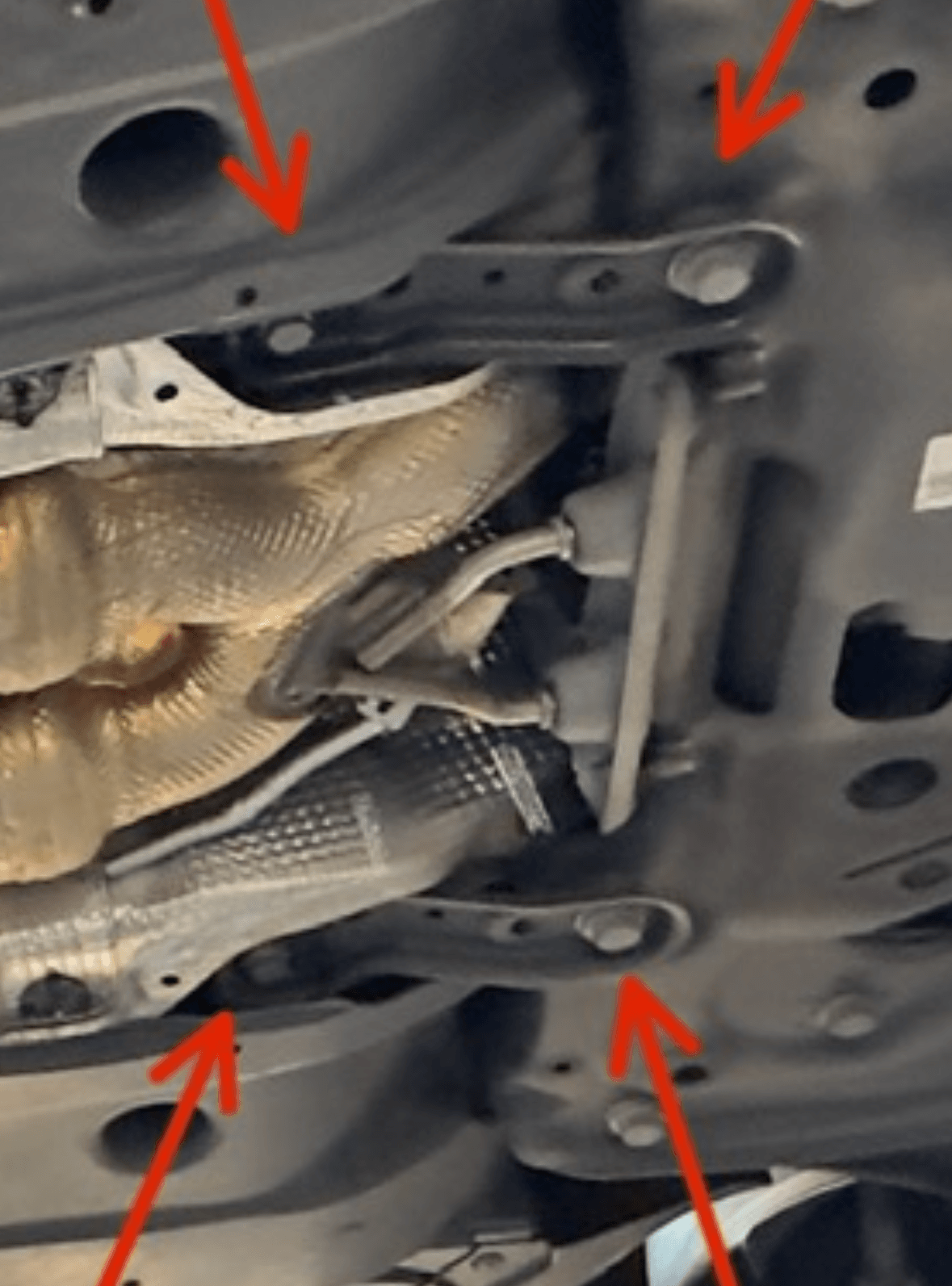

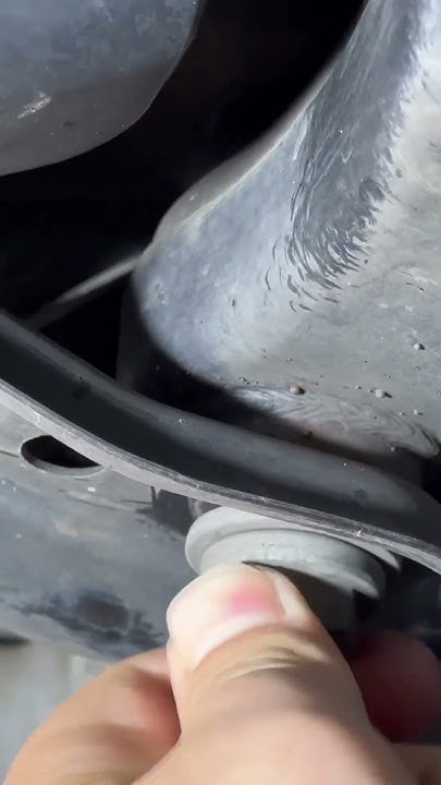

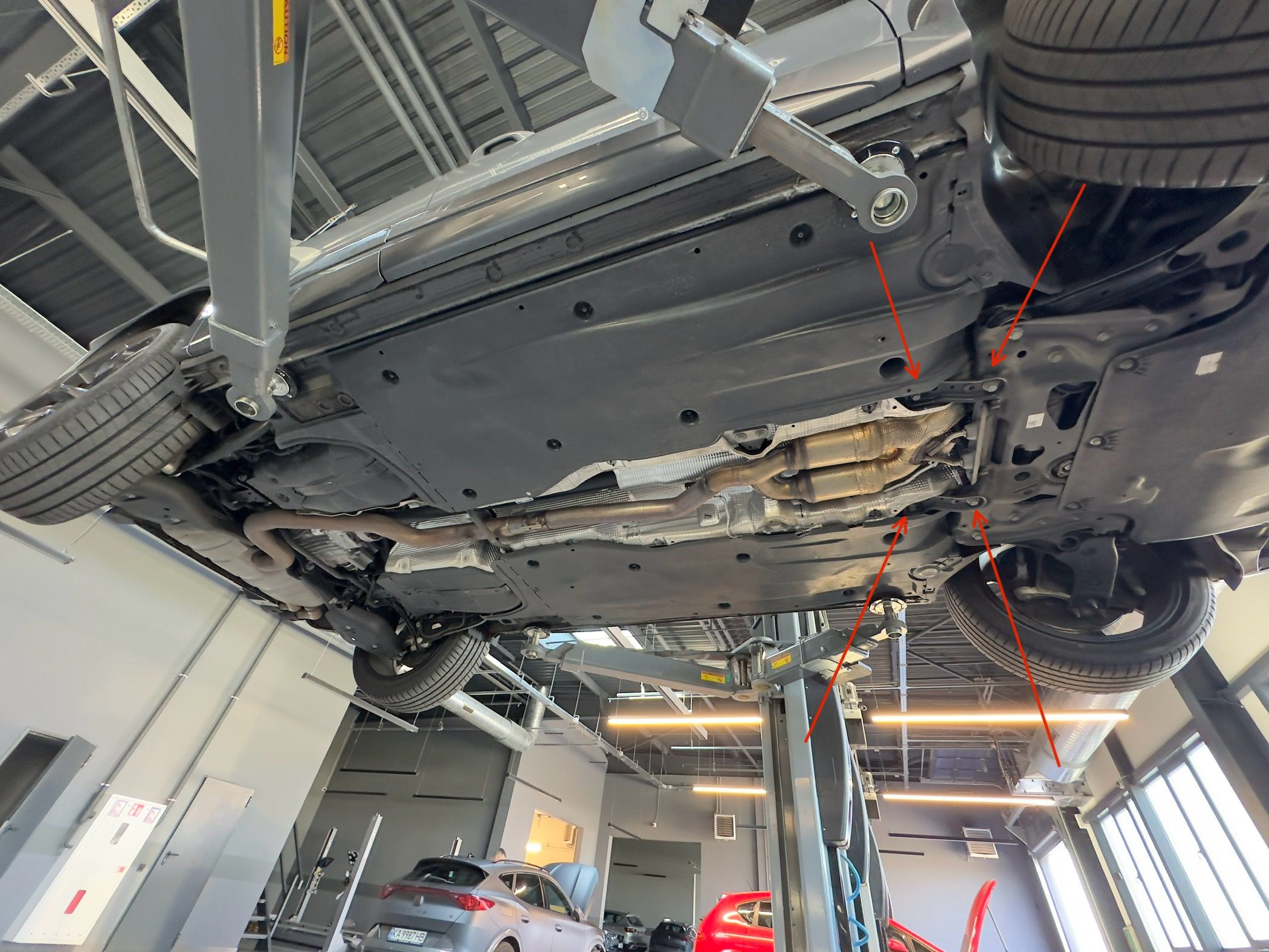

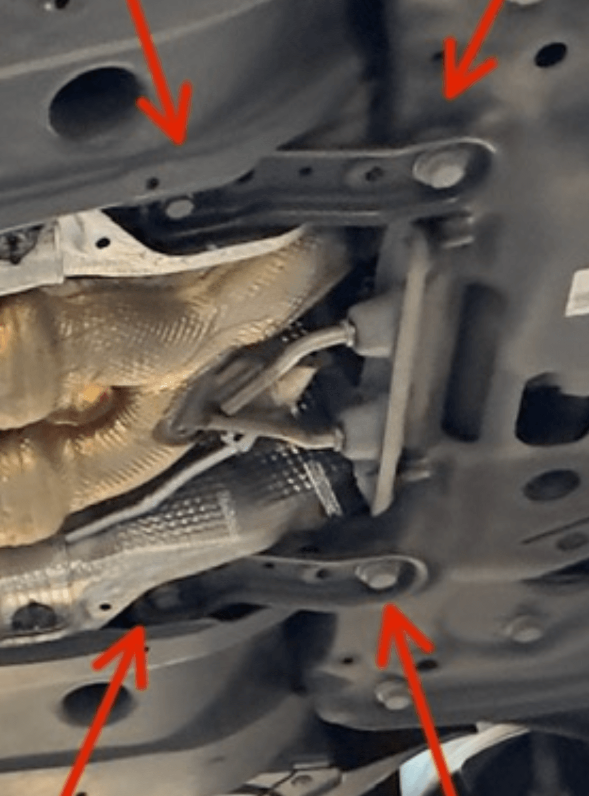

Finally, I’ve sorted it out. It was a loose bolt that was holding the sub-frame assembly. Please check out the video.
Hello, where is this bolt exactly, could you please help? I have the similar noise as on the video, maybe the solution is the same.

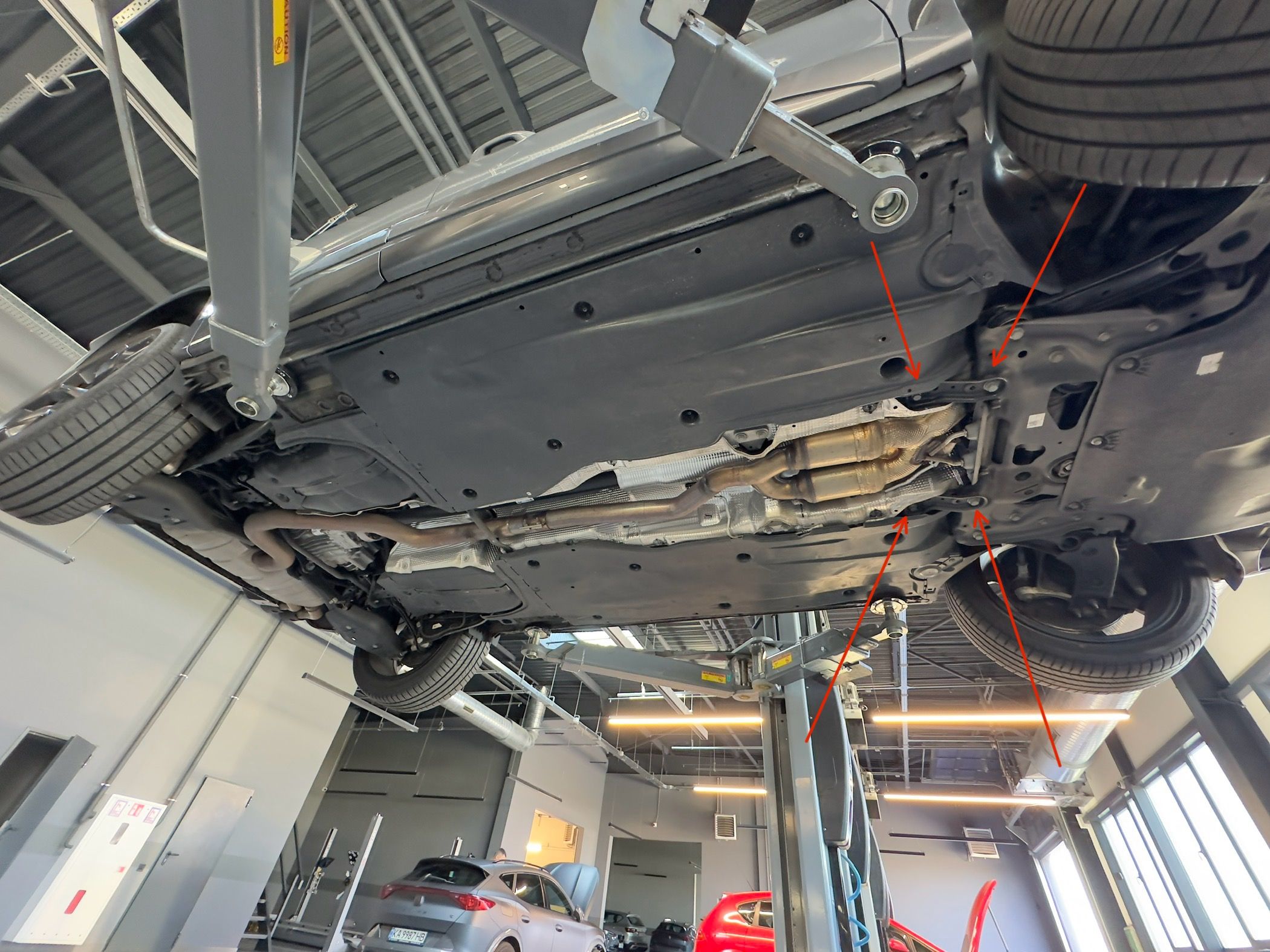

Hi, I suggest inspecting and tightening at least these four bolts as a bare minimum.
Ideally, tighten all bolts and connections that are reachable.
And let us know the results)))

P.S. The rattle issue was fixed, and it wasn’t the bonnet. The issue was caused by a poorly tightened bolt on the subframe. I tightened it, and now everything works just fine (no rattle noise at all).
Hope this helps.
