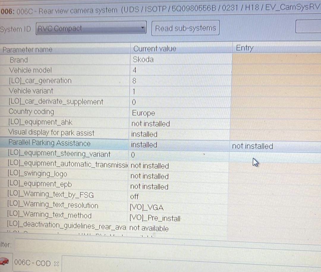

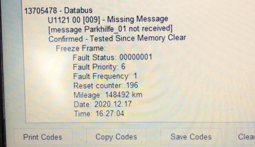

Hey, I fitted myself a Highline Reversing Camera, everything works except now I have a error on the the 6C “parkhilfe_01 - not recieved”
pics attached.
I think its the fact the camera thinks it has PLA (Parallel Park) ticked but you can not untick. It always says “request out of range”
Anyone got any info around this? I spoke to someone in Leeds who does these and they havent had a issue however they only fitted them on Facelift MK3’s.

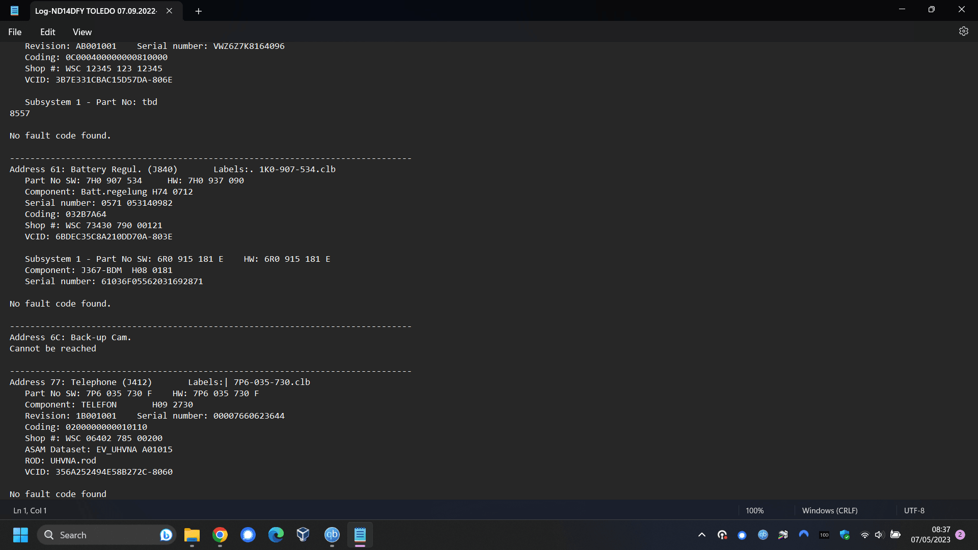

Is the camera actually working perfectly with no flakiness in the image on screen? Reason I ask that is this: I have fitted reverse cameras to 3 x Skoda Octavia mark 2 (54, 08 and 62 plate), my current 64 plate Leon SE Tech mark 3, and my wife's current 14 plate Toledo SE Nav, and in every single one of these installations, address 6C for reverse camera is not accessible in VCDS, or indeed in VCP. Any fault codes produced during the installation had to be cleared, and were cleared, by the global clear all DTCs on the page where you select the vehicle model. Any subsequent scans of any of these cars will always show the camera module 6C inaccessible, and the initial scan will show all modules black, with no faults anywhere in the car.
Your first picture showing "tested since memory clear" says there are no actual faults in the camera system.
If everything is working spot on, then live with this message you're getting, it isn't coming to any harm. I'm pretty OCD about getting things spot on, but in this case, it's something I've learned to just accept!

It makes the park pilot button inoperable.
I have cleared the faults via every method, still same.
Not much to put it down to other than the Parallel Parking ticked and not been able to untick it.
However apparently same camera fitted to the facelift MK3’s doesn’t cause errors.
