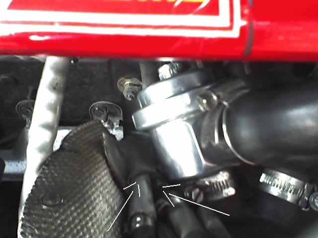

Hi Guys
This is sooo dull I am hoping someone out there has recently replaced them .:blink:
I would like to change over 2 hoses which sit right next to the DV. They are sat along the TIP running parallel going down about 8 incehs to a part which I dont know the name of either!
Just wondering if anyone can tell me where to look or better still tell me the codes I need to quote to the dealer:clap:

lol I couldnt take it in the dark:( I aint got the Cupra night-night vision gear yet! I dived out this am though so please cast your eyes over this pipe.
:D
May 2, 2006
2,758
thats your vac hose going to your actuator, their should be 2 going to it on a k03 setup, yes you can replace them, just use some silicone vac hose

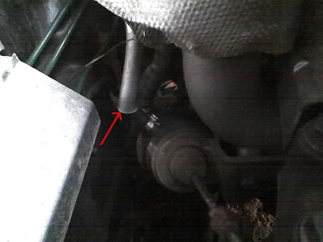

This is the top of those hoses. Can I get them from VW and WTF do I ask for.:confused:
Is it Ok to cut them half way down as the clips that are on them don't look friendly!?

its the vac hose from the actuator to N75
you could just get some silicone vac hose from forge motorsport for example..not sure of actual size but I'd guess 8mm

u could get the stock hose from a dealer..describe it just as stated already...but silicon hose will prob be cheaper and you could replace other hoses as you will get a metres worth
cut away when you replace it, its only rubber

8mm is not the correct size FYI:confused: . Looks more like 6mm maximum internal diameter but thanks anyway
