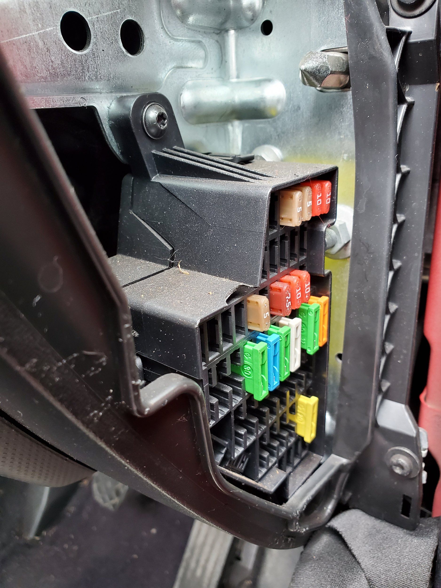

Sorry for the really old bump, thought better than a new thread as my old Ibiza was perminantly live and my new Leon not! I can't get it right haha. This is a Pic of my fuse box below if I remove one of the yellow fuses my 12v stops working so do I touch that one or is it another? Also I have a 2007 mk2
Sorry for ignorance haha

This thread was in response to the MK3 Leon, the MK2 is most likely wired differently from what has been discussed in this thread so I don't know if it's as easy for you to make yours perm live as described here. Might be worth making a thread in the MK2 forums and asking there, someone with more knowledge of the MK2 platform than me may be able to help (y)
