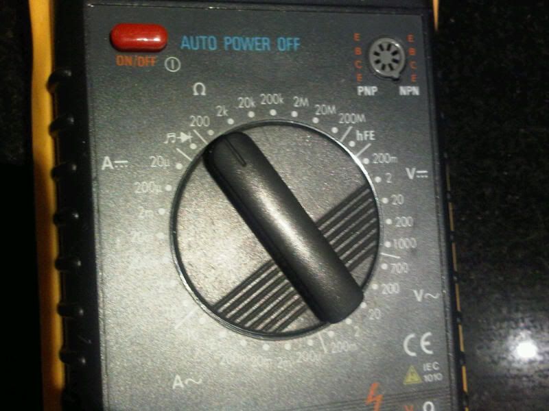

I took my passenger side glass out as it hasnt worked in years and wanted to get it sorted before the ice age arrives. The right one works so checked the fuses and there only appears to be one for both sides. There isnt actually a picture denoting heated mirrors only 2 symbols for heated screens both of which the fuses are fine. So with a volt meter what do i need to set it to to find out if its fubared? and what should i see as a result or failure?

So with the glass off and set to 20k(2 to the right in the picture) I get a reading of 0.65 ??
Switch the meter over to the setting with the musical note (one to the left of where it is in your pic) then put one probe onto each connector of the removed mirror glass. If the meter beeps at you the element should work when voltage is applied.
Switch the meter to the "up to 20 volts DC setting" (10 to the right of where it is in your pic) and you should get a reading of about 12 on the wiring for that mirror. If I remember correctly they come on with the heated rear screen switch on a MK4 Ibiza.
Cheers chaps, so with the musical note it reads .614 (remember the mirror is off the car) if i touch the 2 probes together it beeps. What does that say about the glass? I will test the the wiring incar 2moro.
That setting is for measuring up to 20 volts DC, not resistance. The OP sounds like he is attempting to check the resistance or continuity of the heating element.
My bad, thought he was checking to make sure it had a feed. I did illustrate half your answer though :p
OK, if you're testing the resistance of the mirror glass, the fact that it didn't beep when you tested it on the musical note means that it has failed. Ignore the reading.
