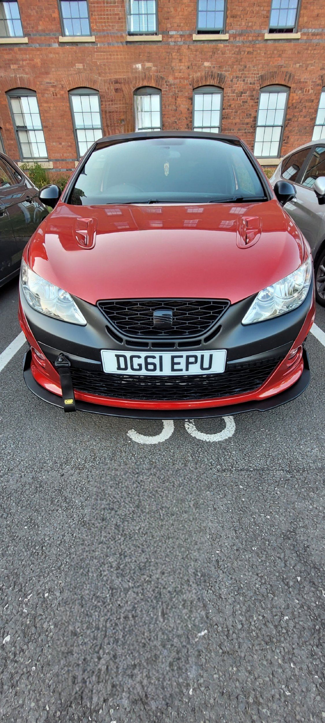

Made a new splitter from 12mm birch ply and a lick of exterior satin paint.....some proper down force going on now 😆

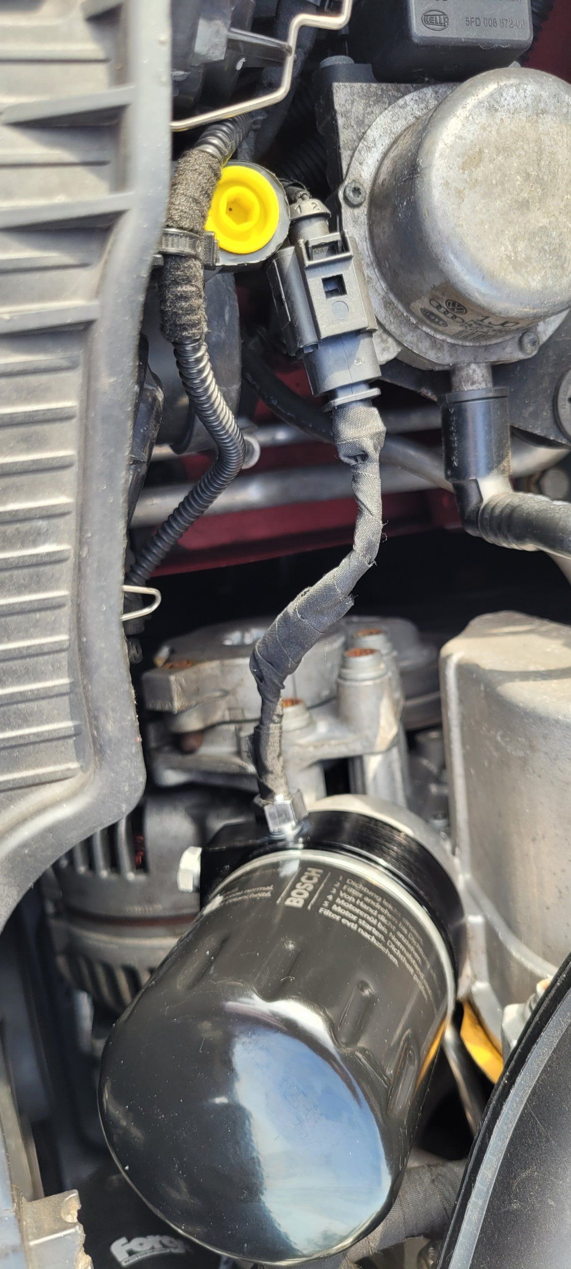

Little addition before Cadwell a week on Wednesday, Oil Temp Sensor and Prosport gauge, couldn't have odd gauges though so swapped out my Turbosmart boost gauge for matching Prosport 👌
I even put a oem 2 pin connector on the sensor for that...'Keep it Factory' look 😄
FYI...Stock oil filter doesn't fit a standard sandwich plate 👍

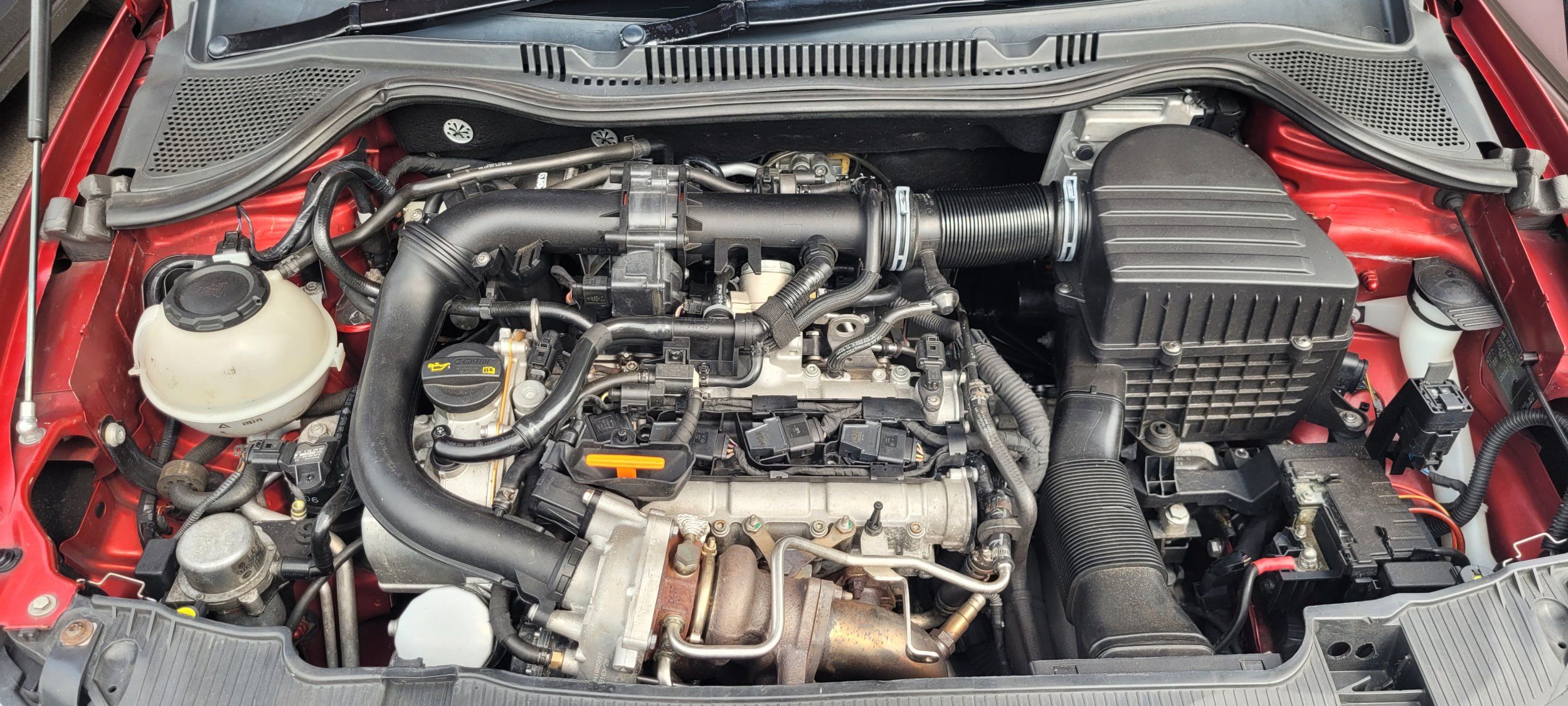

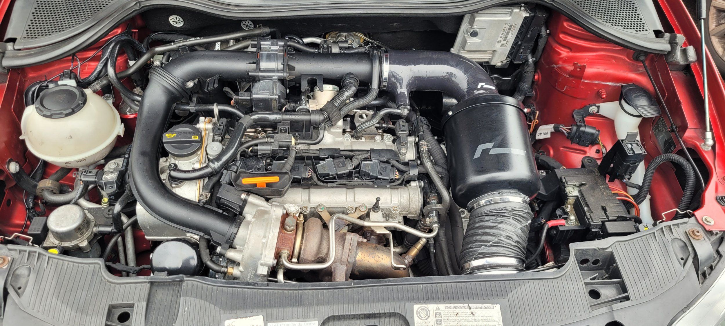

Picked up a Racingline CAI for cheap....
Not noticed much difference but I'll see how it goes..
Reactions: nd-photo.nl
BocaBill
Mar 31, 2020
128
72
Looks like a directer path with the Racingline
Yea, bigger diameter and more direct tubing however the foam of the filter is denser than the pipercross one.
Filter housing picks up heat from the side of the engine, something stock box doesn't behind at the back of the bay.
Will have to datalog intake temps and air mass volume

And stock filter might also have more surface area maybe? In these pictures it looks way bigger than the Racingline
Yes, pipercross filter is larger in size though most the air flow goes through the scoop facing side
