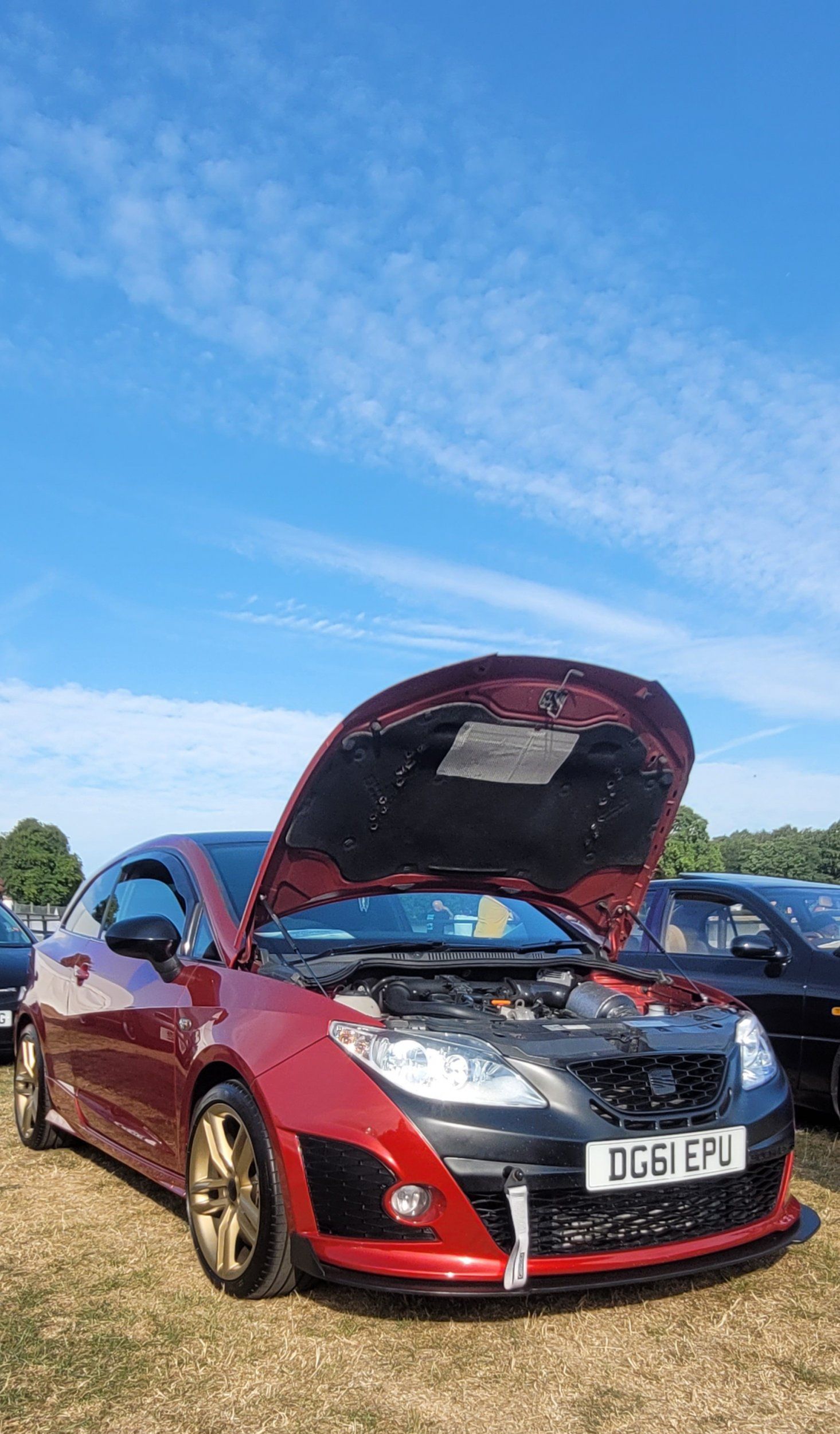

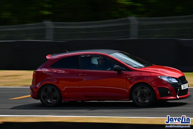

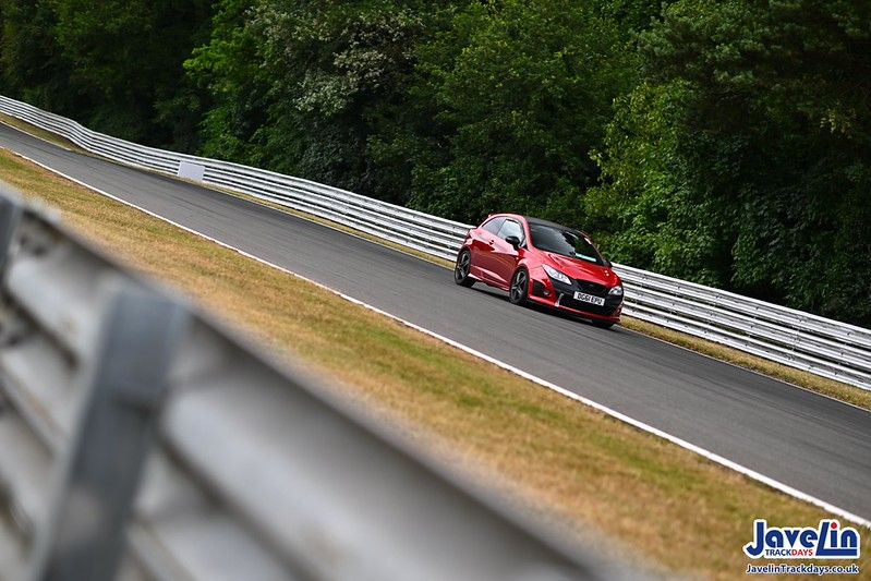

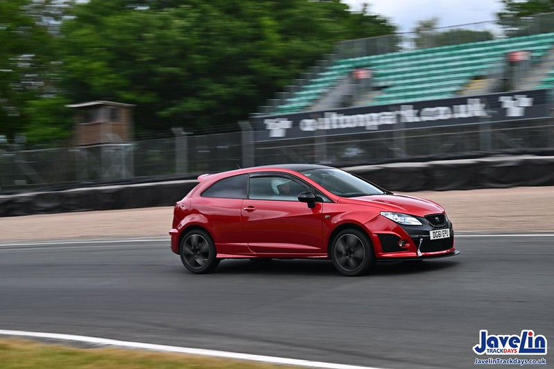

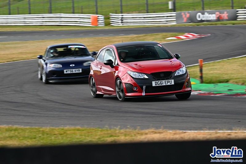

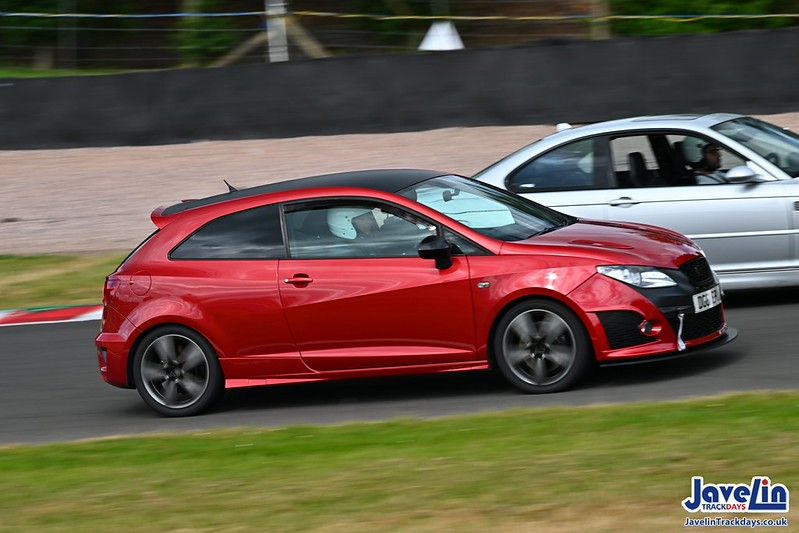

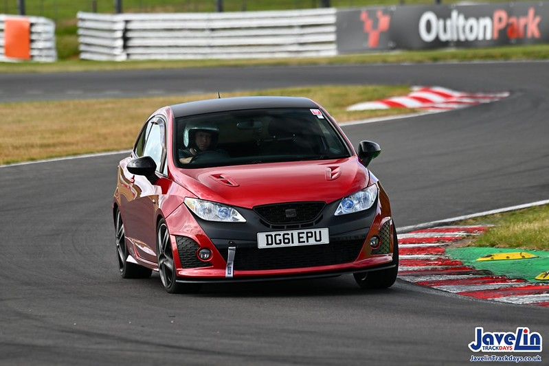

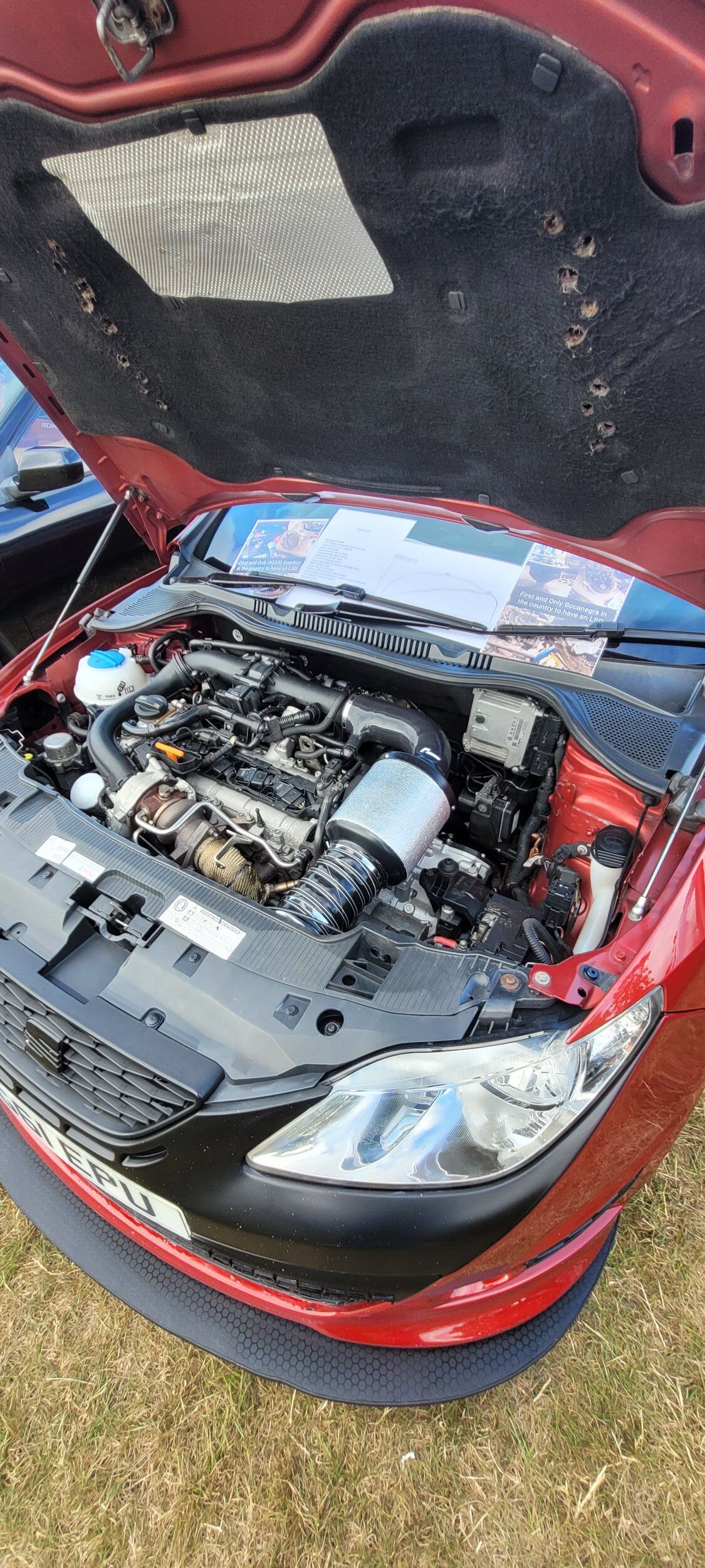

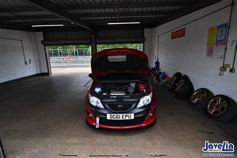

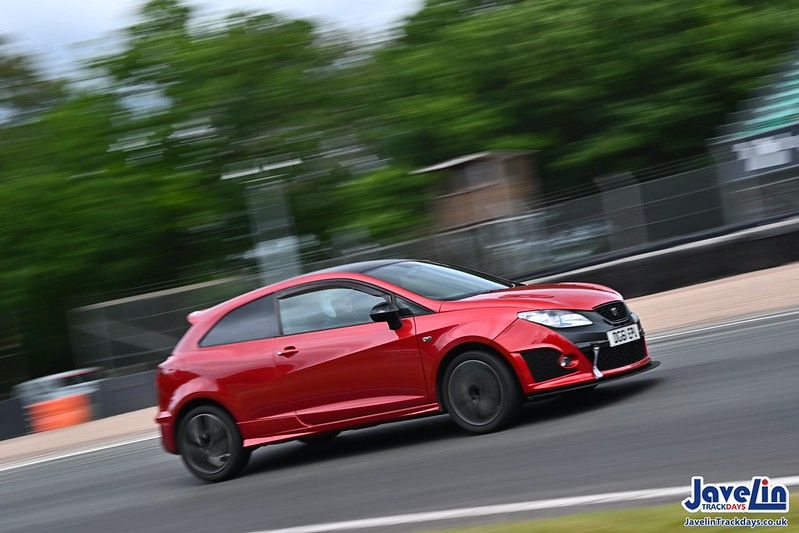

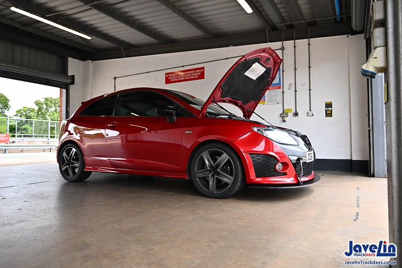

Couple of shots from TUNERFEST (north) @ Oulton Park today....

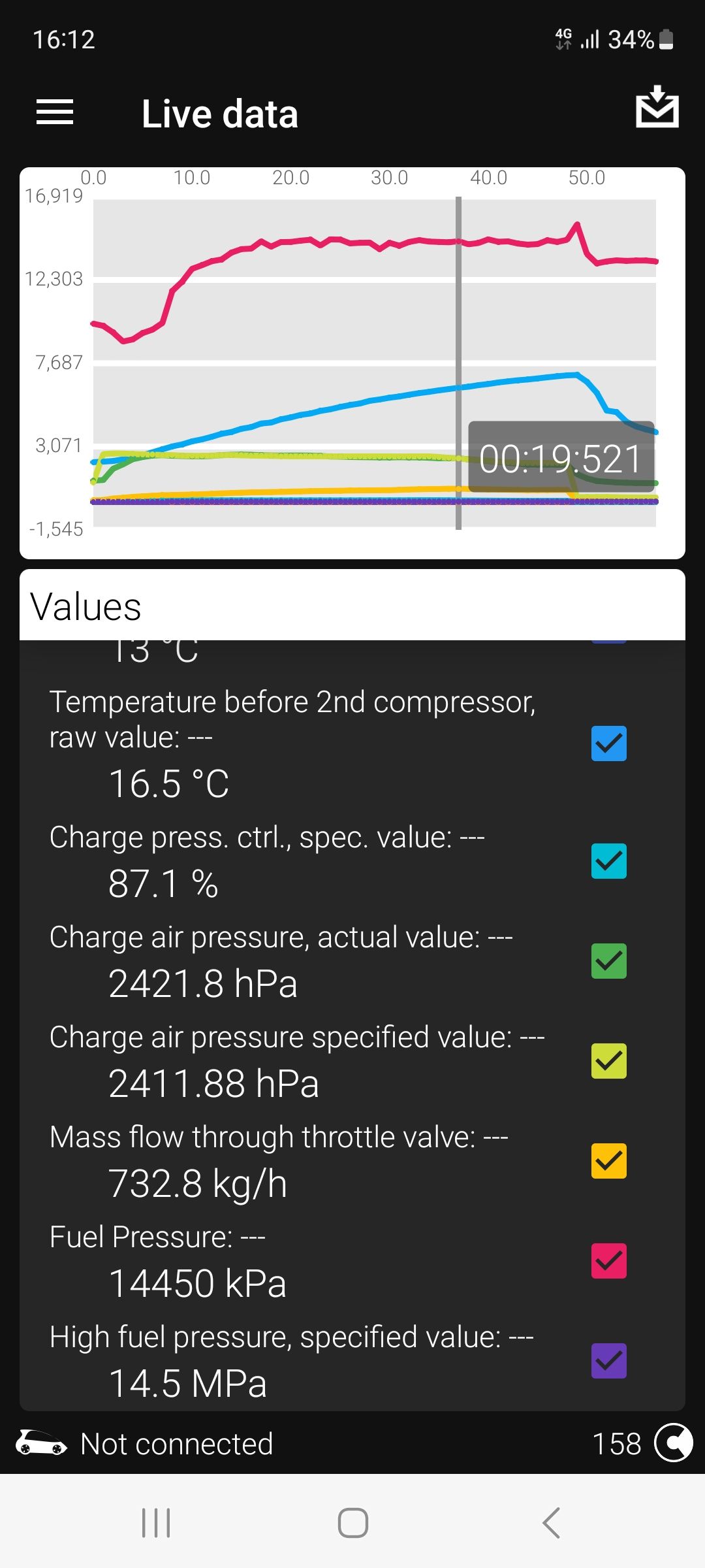

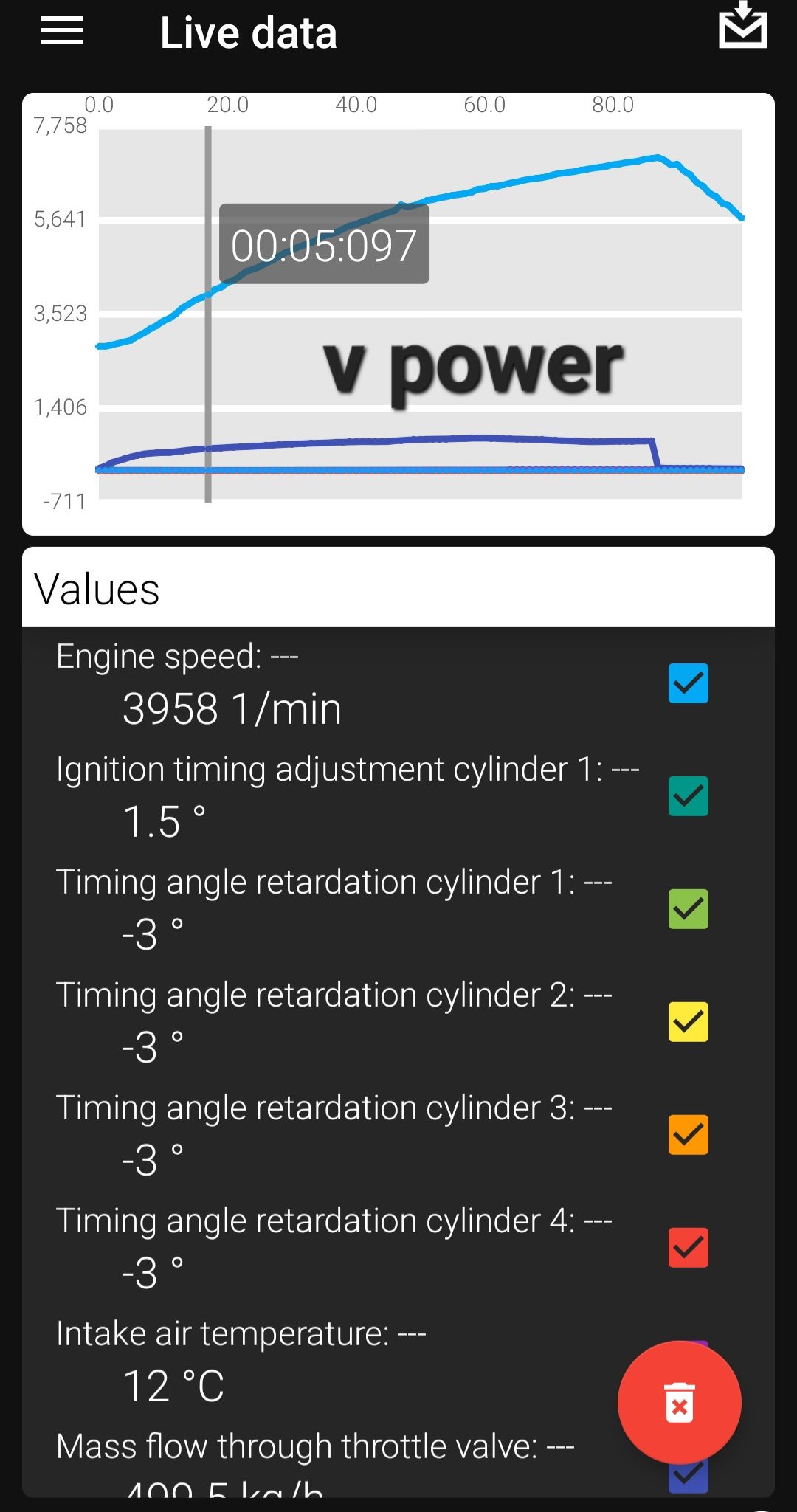

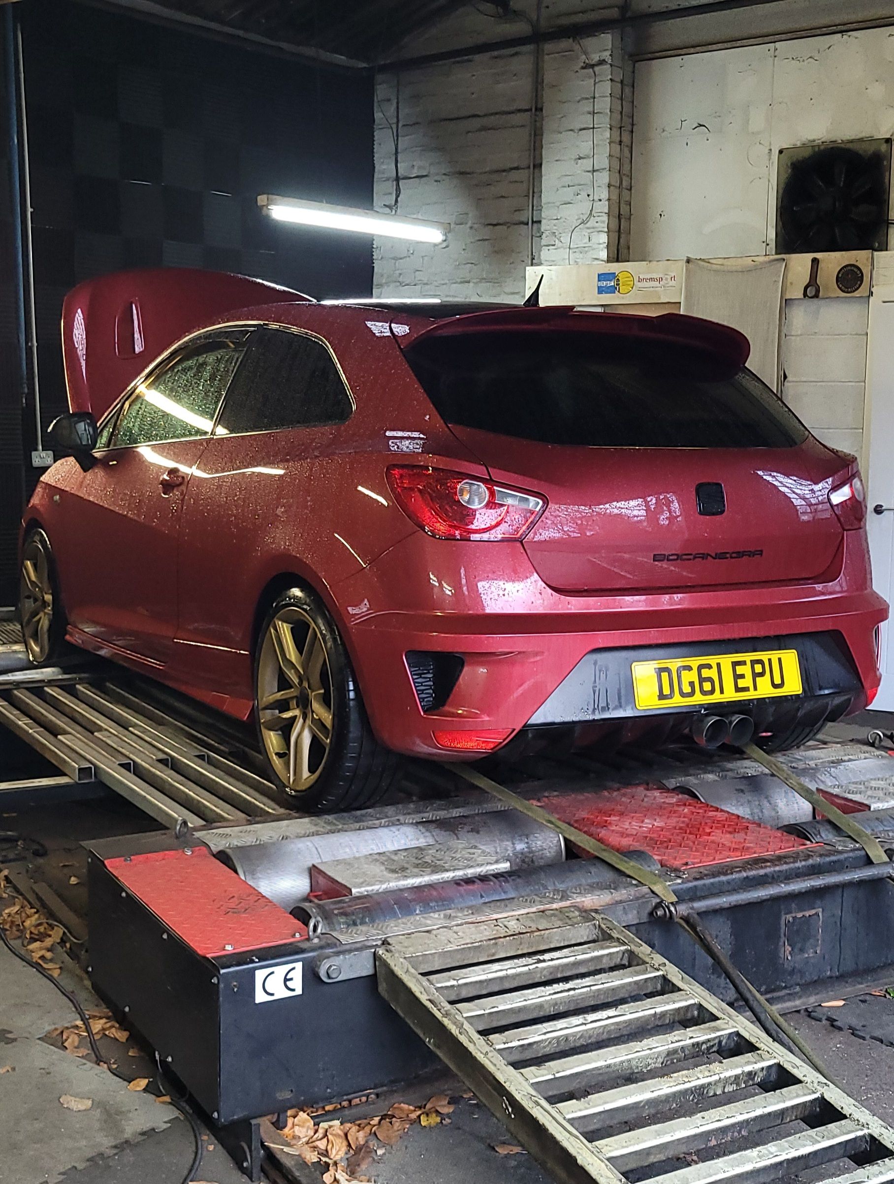

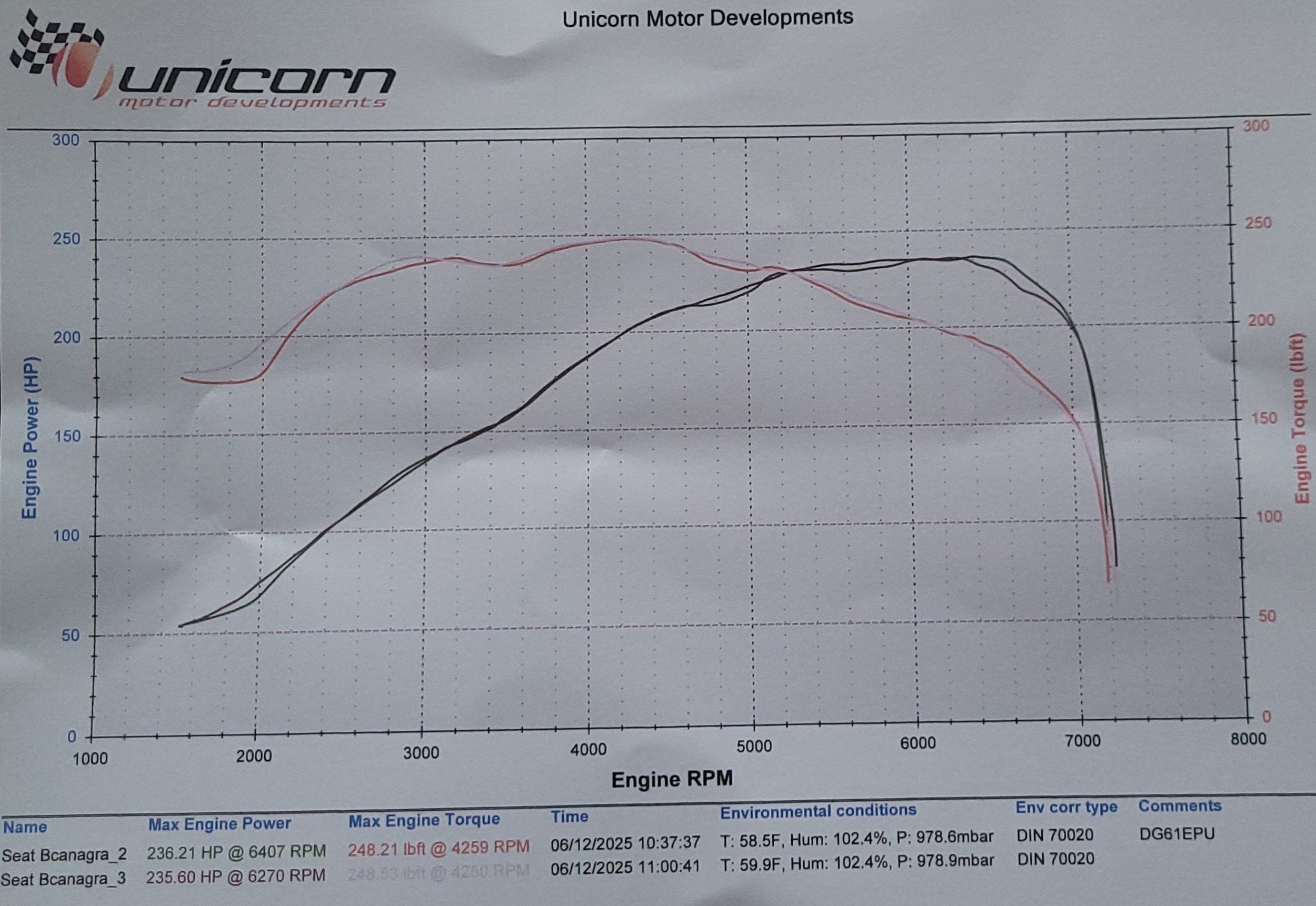

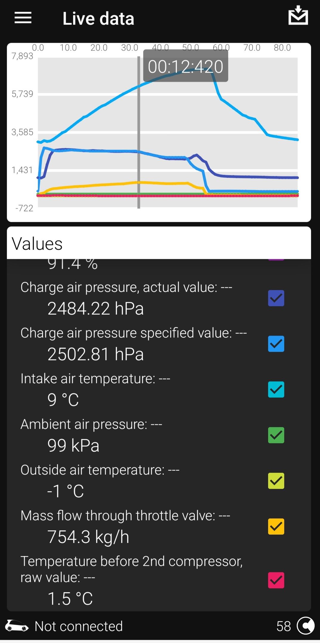

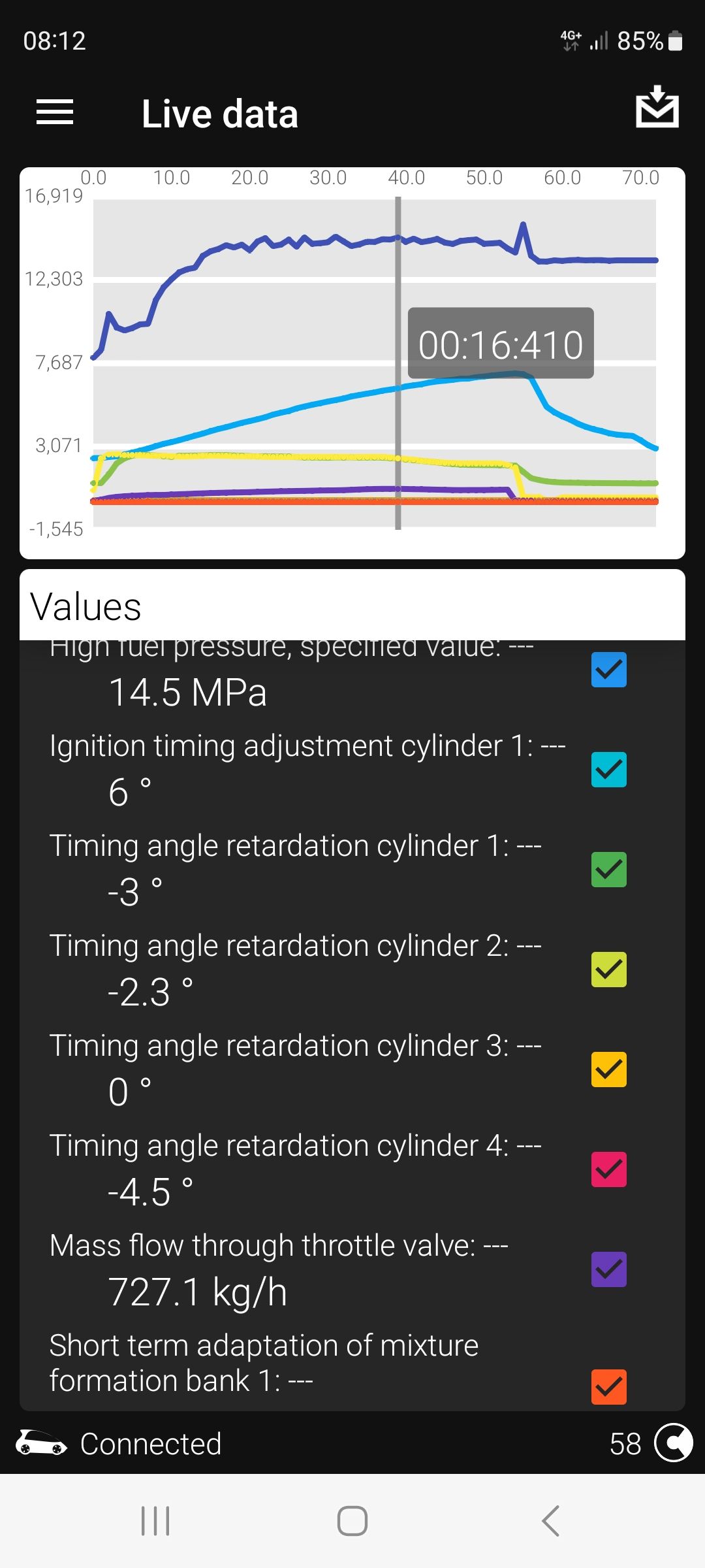

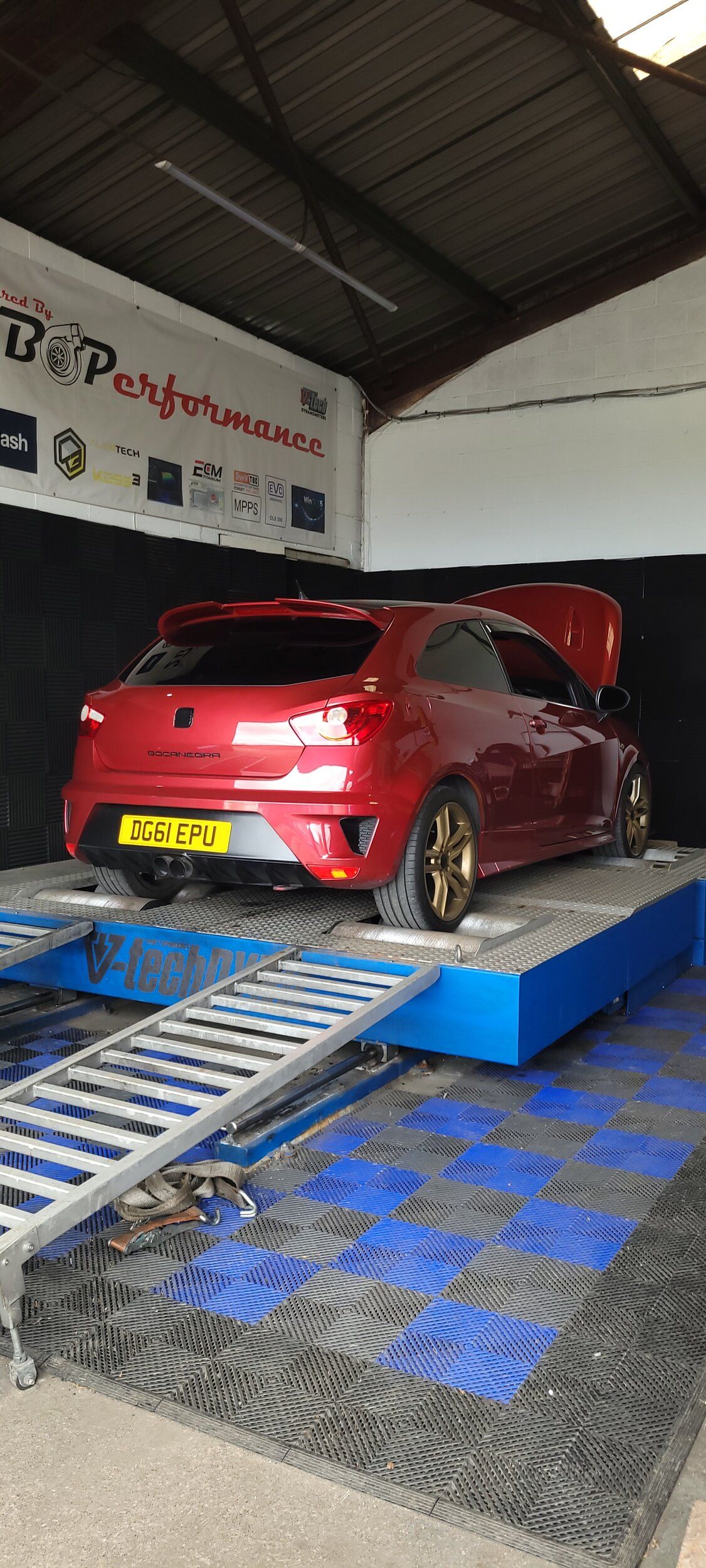

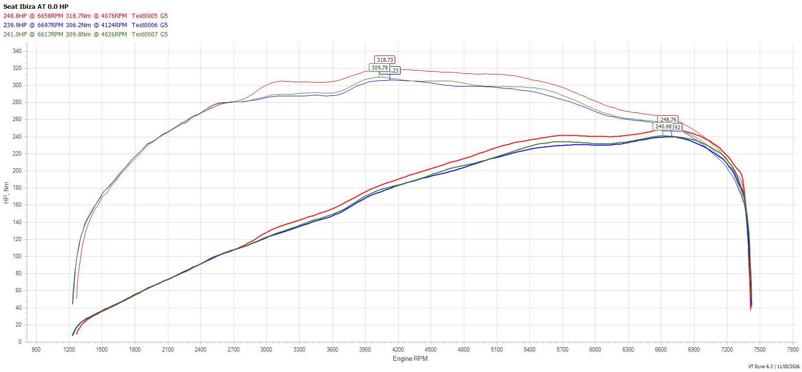

Try as you might to book a cold dry december day with loads of oxygen rich dense high pressure air for some power runs on the dyno....and what does the world deal me instead?.....
A wet average day with 102% humidity and very low presure.... in short a complete power killer 😞.

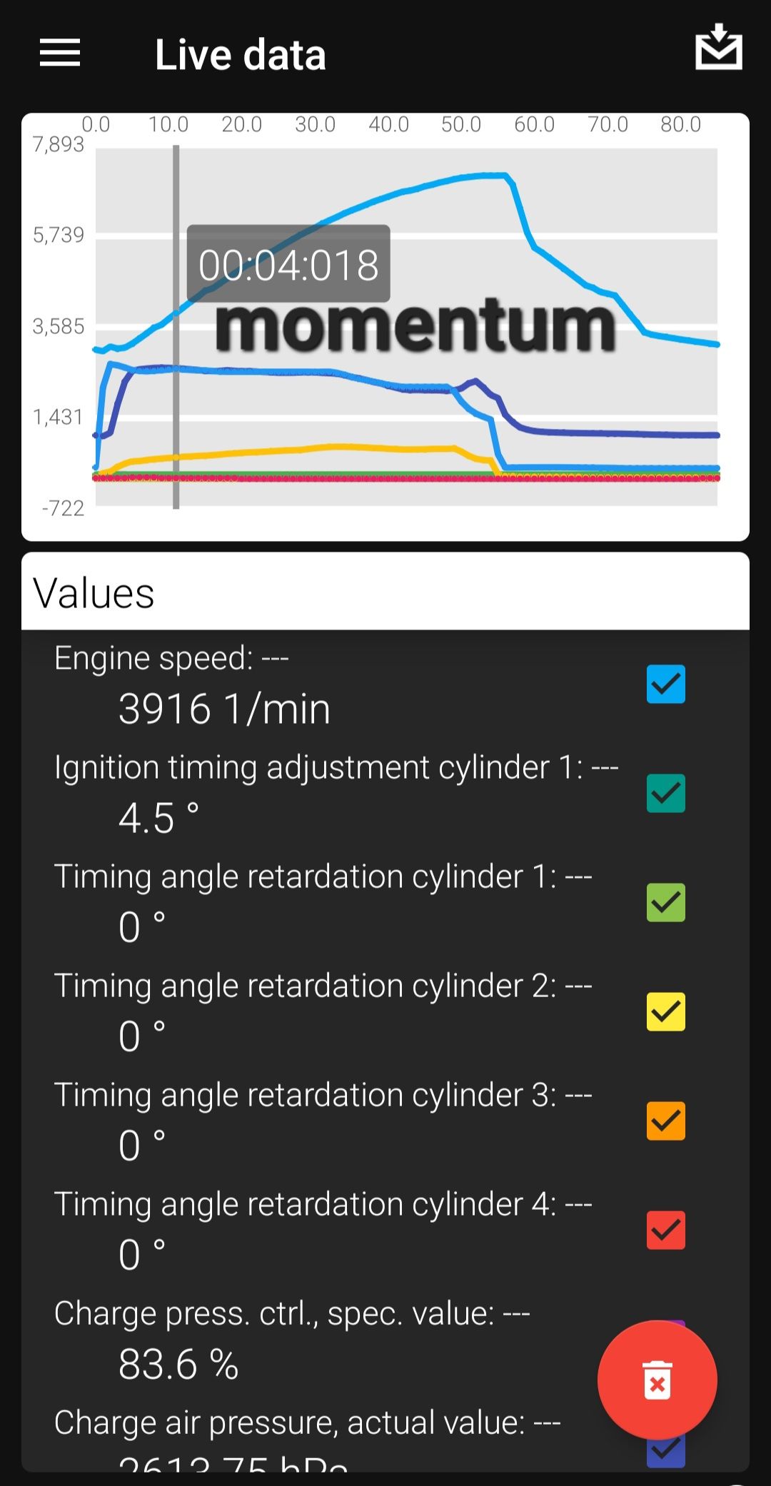

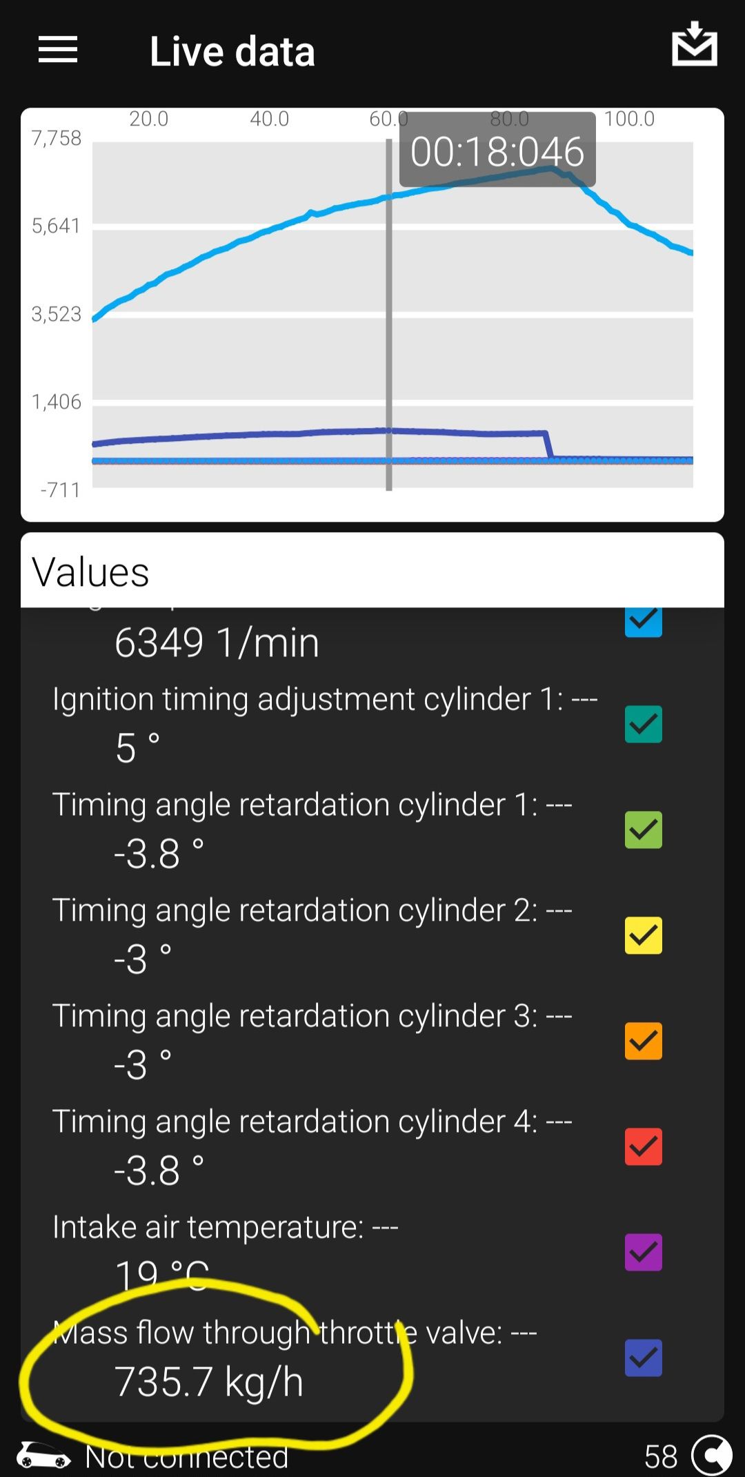

My aim was to back up my air mass flow logs of 735kg/h converted is 204 G/S ÷ 0.8 = 255hp, estimated.
However conditions today just killed it off, though I came away with some consistently good looking power/torque curves the figures were lacking
236hp/248ftlb 🫤
On a dry high pressure day this would pick up 10-15hp and 20ft lb.
'Meh' on paper, different story on the road & track.
9 months on since the tune and all data logs still looking spot on 💪

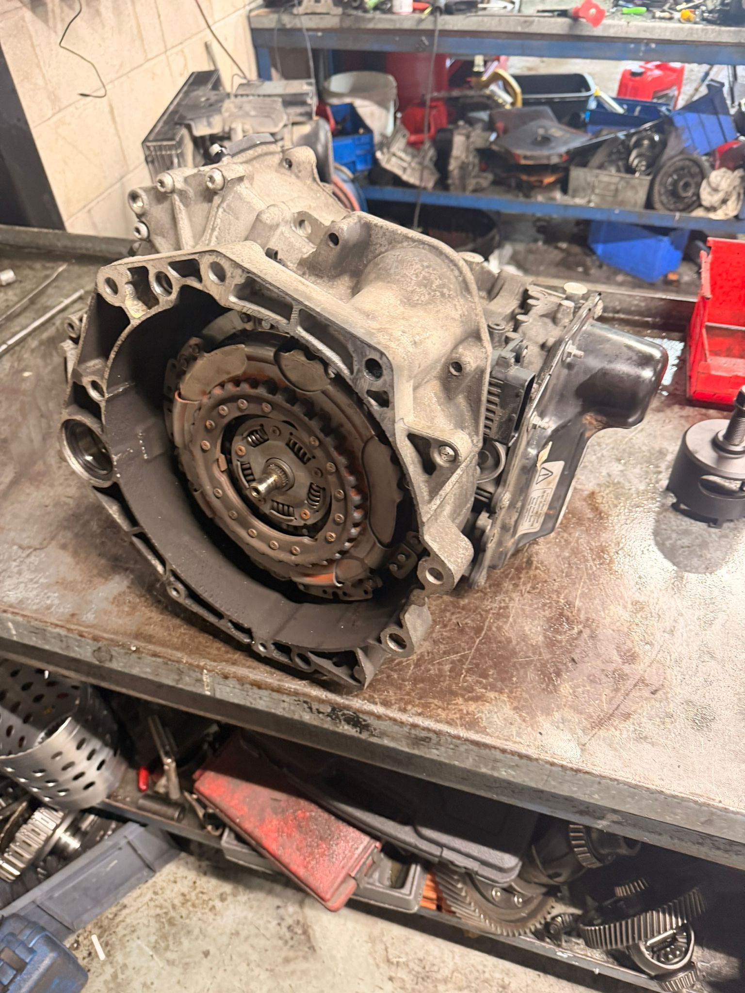

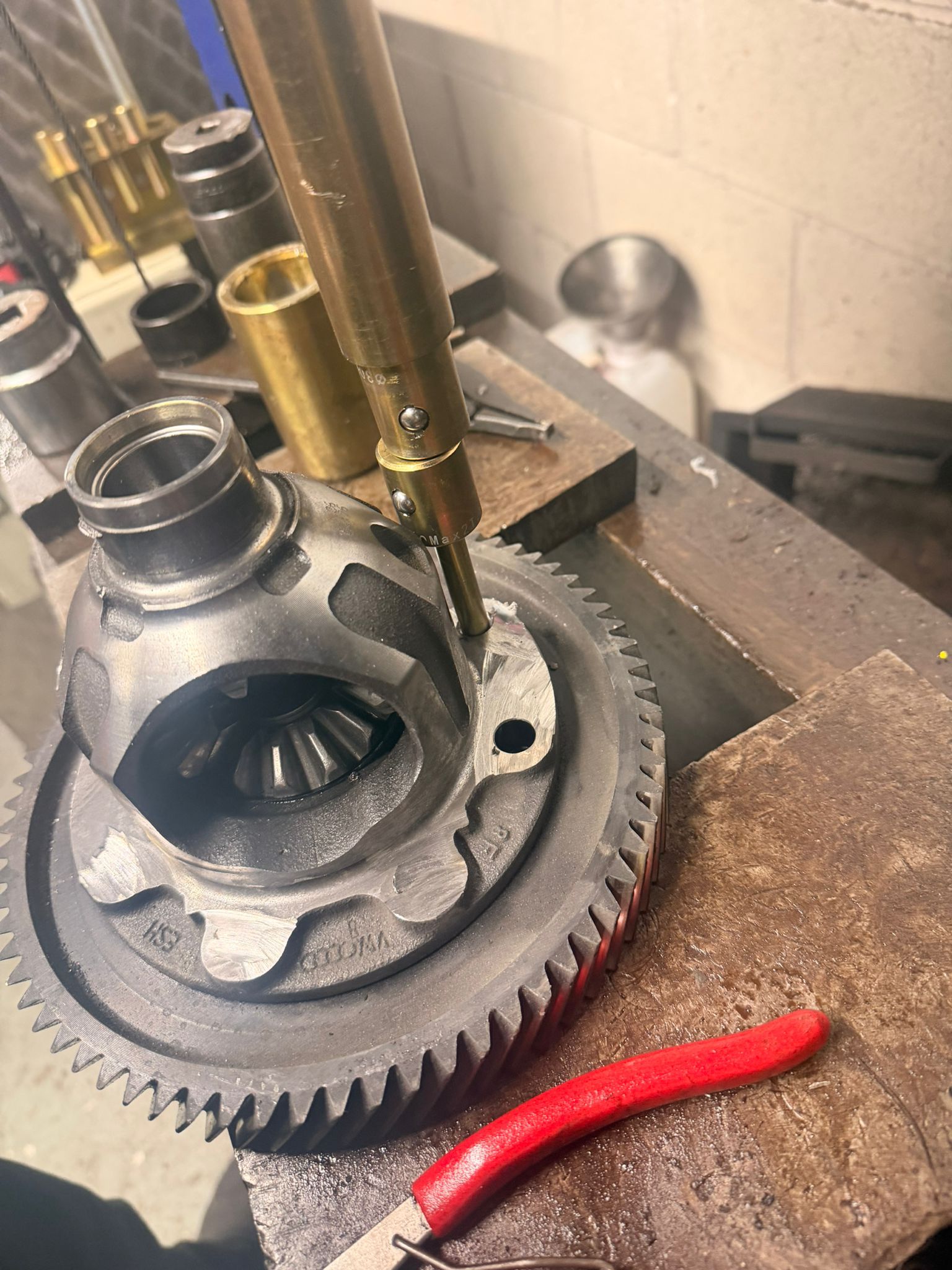

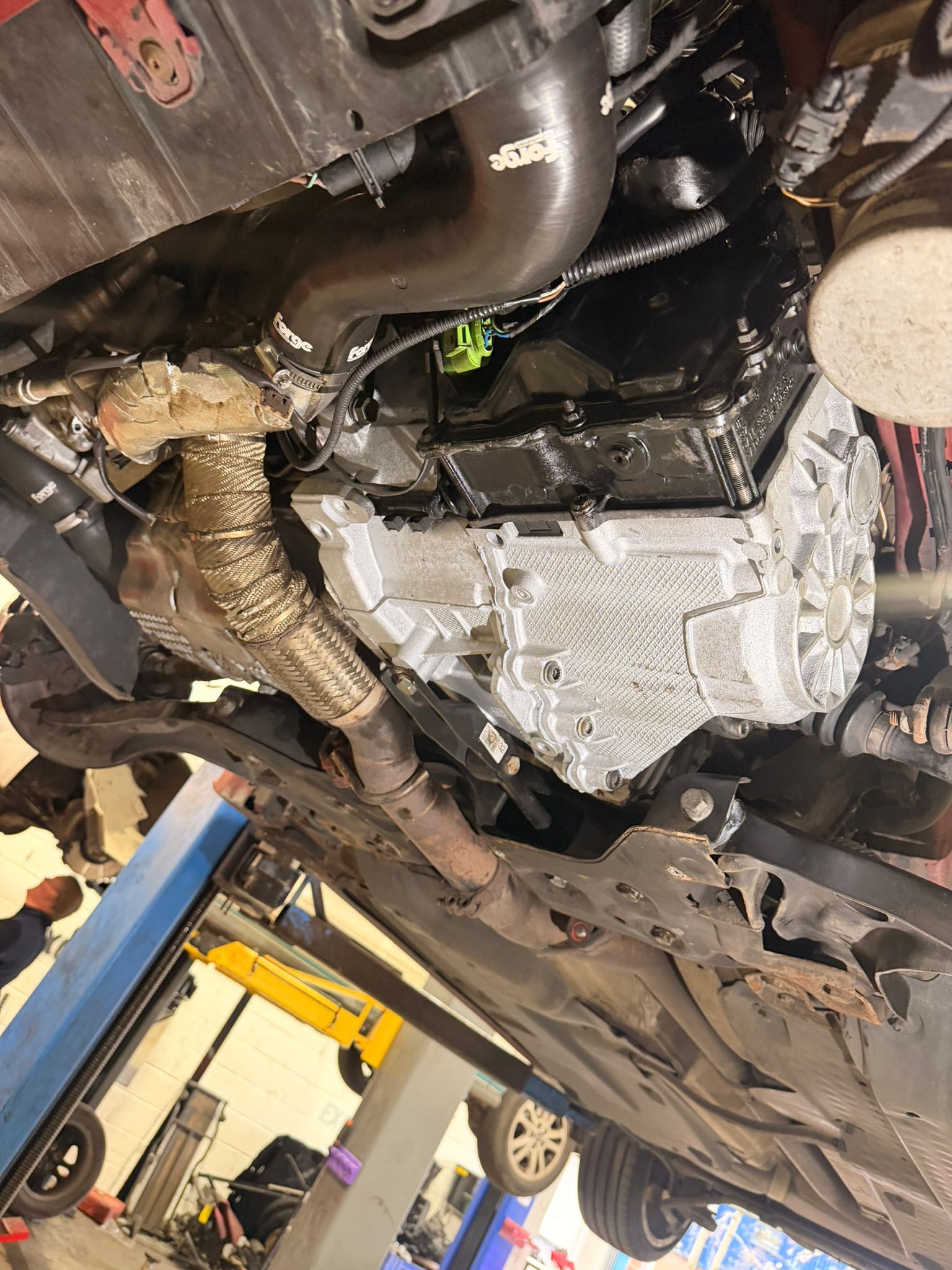

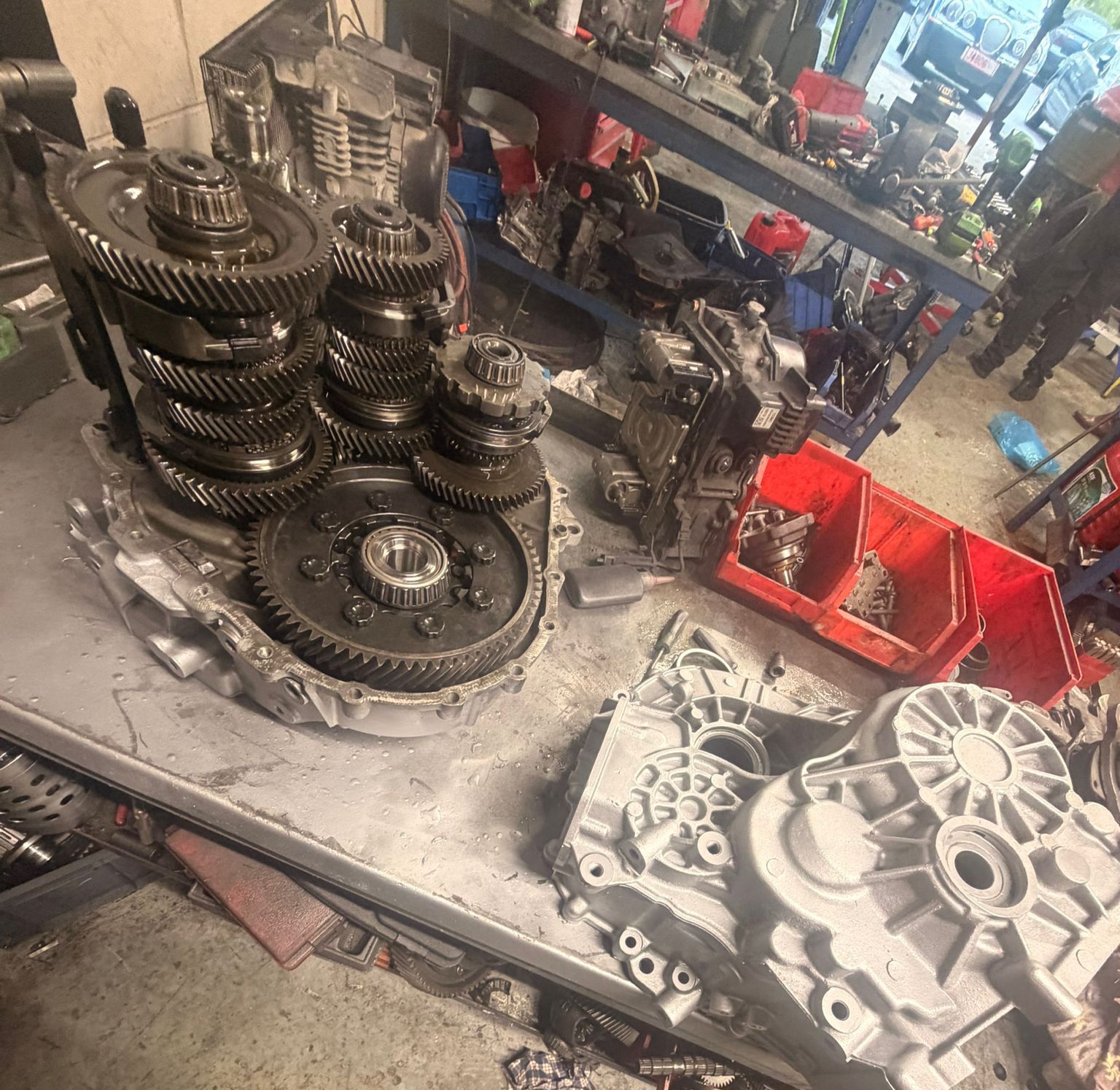

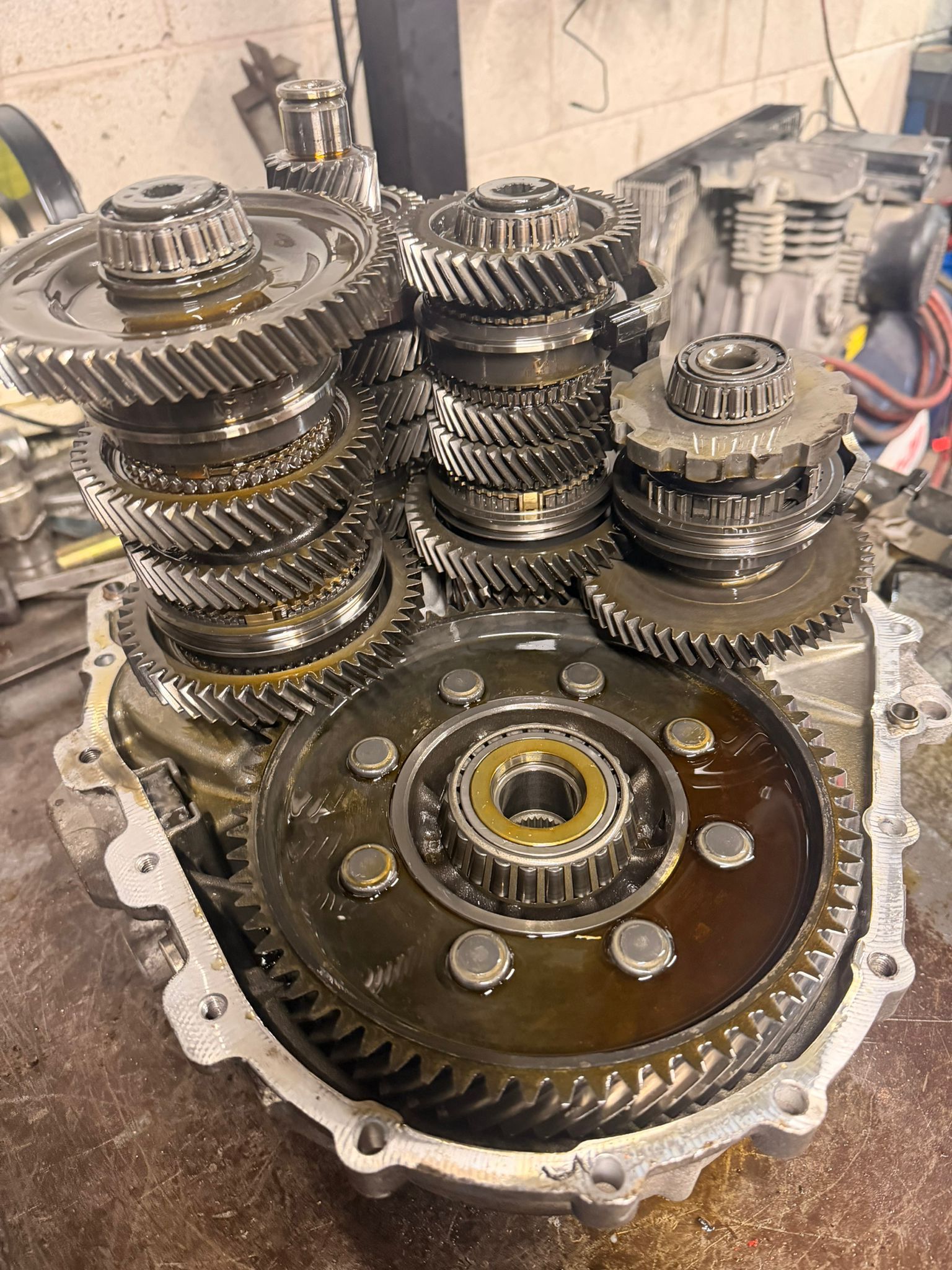

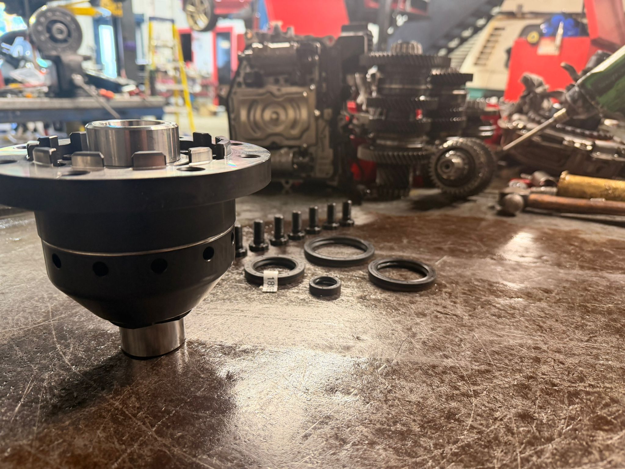

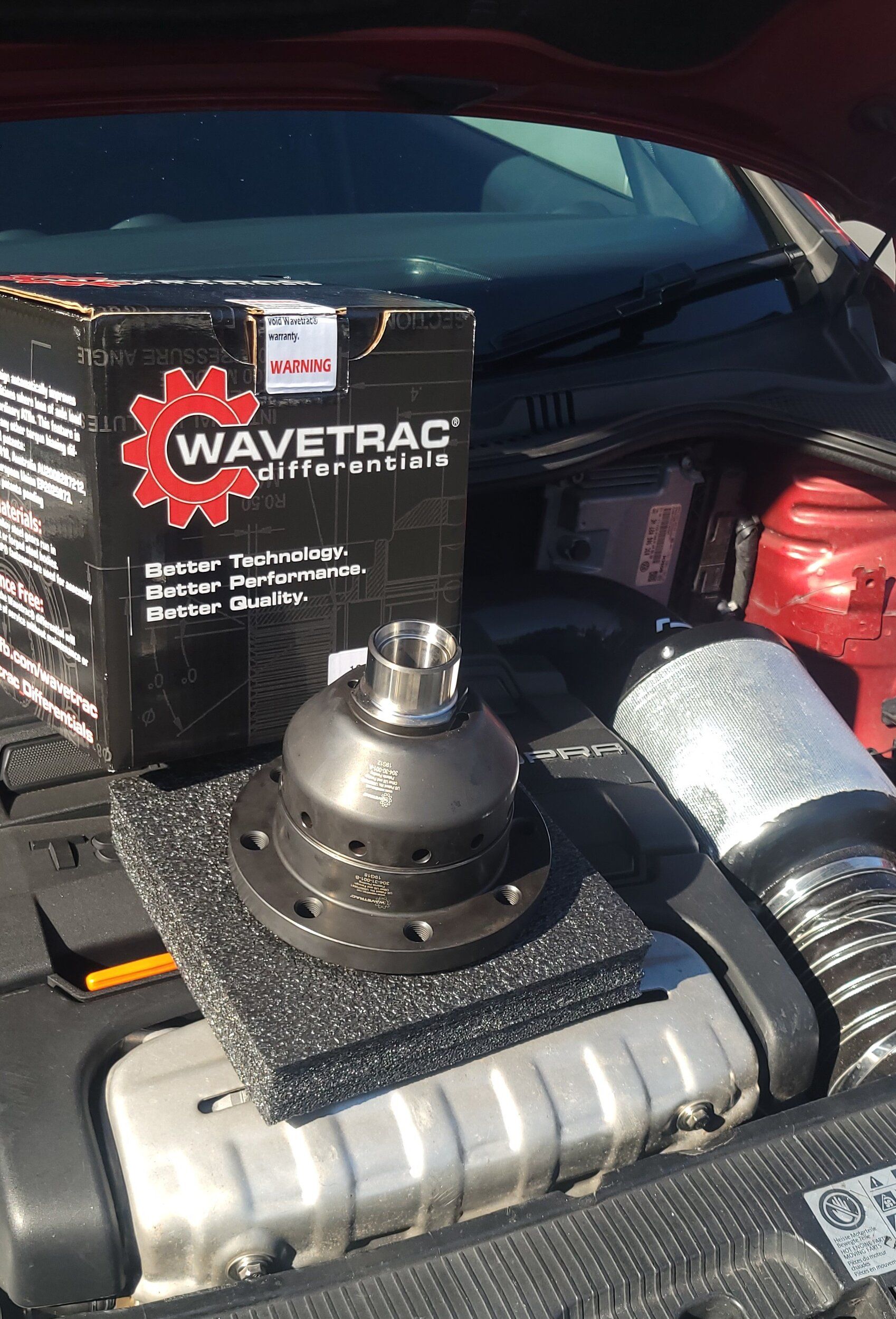

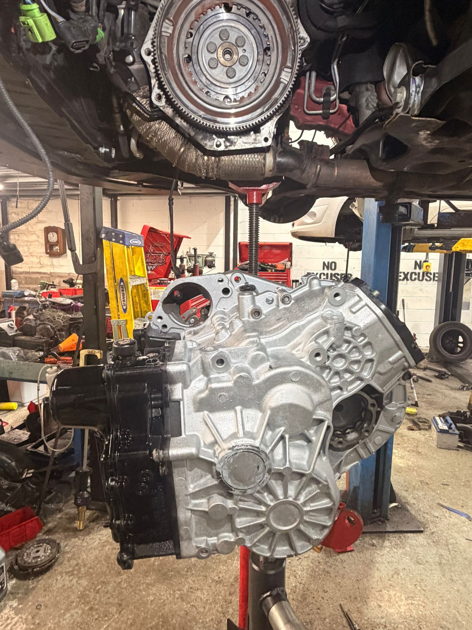

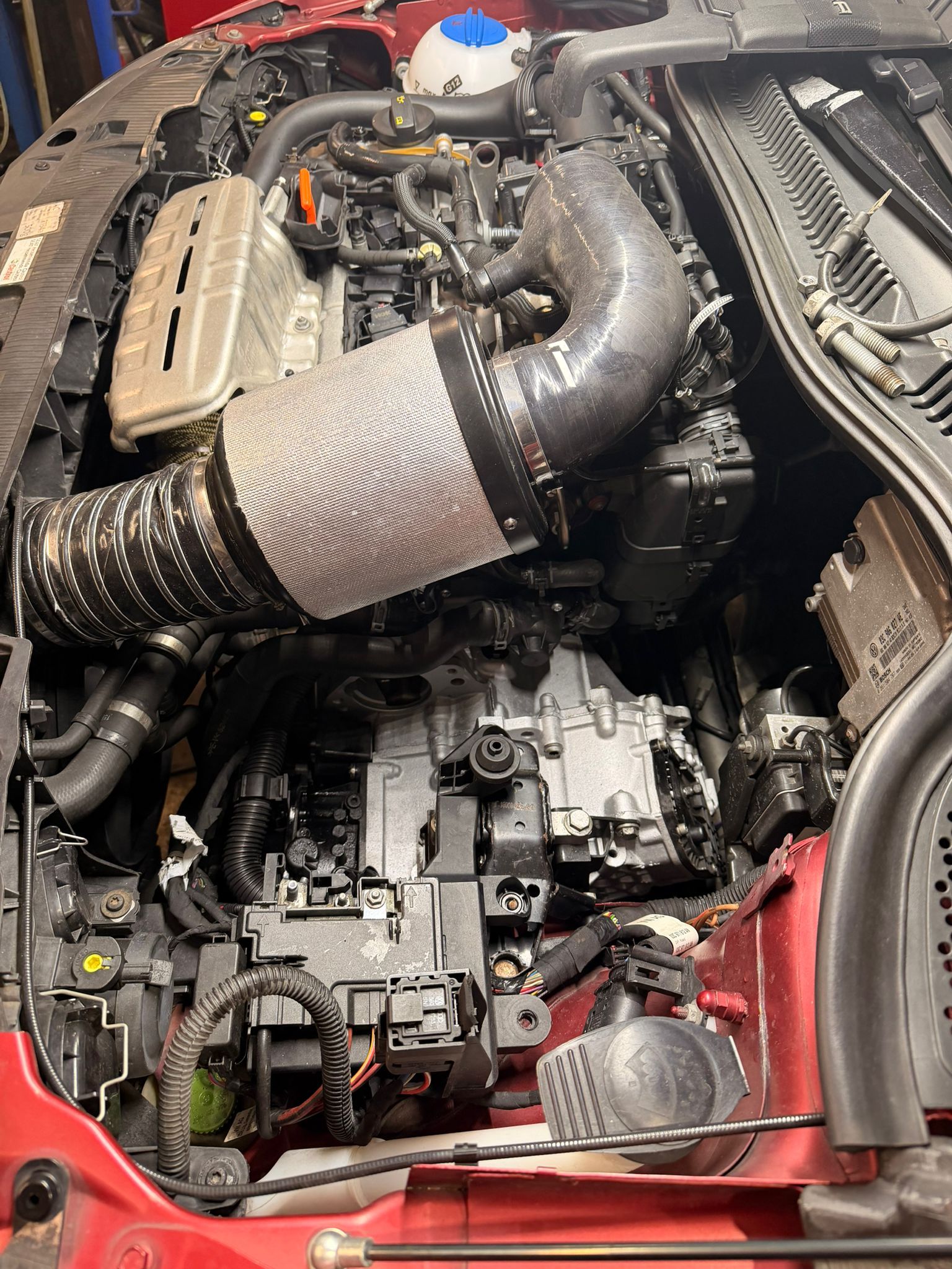

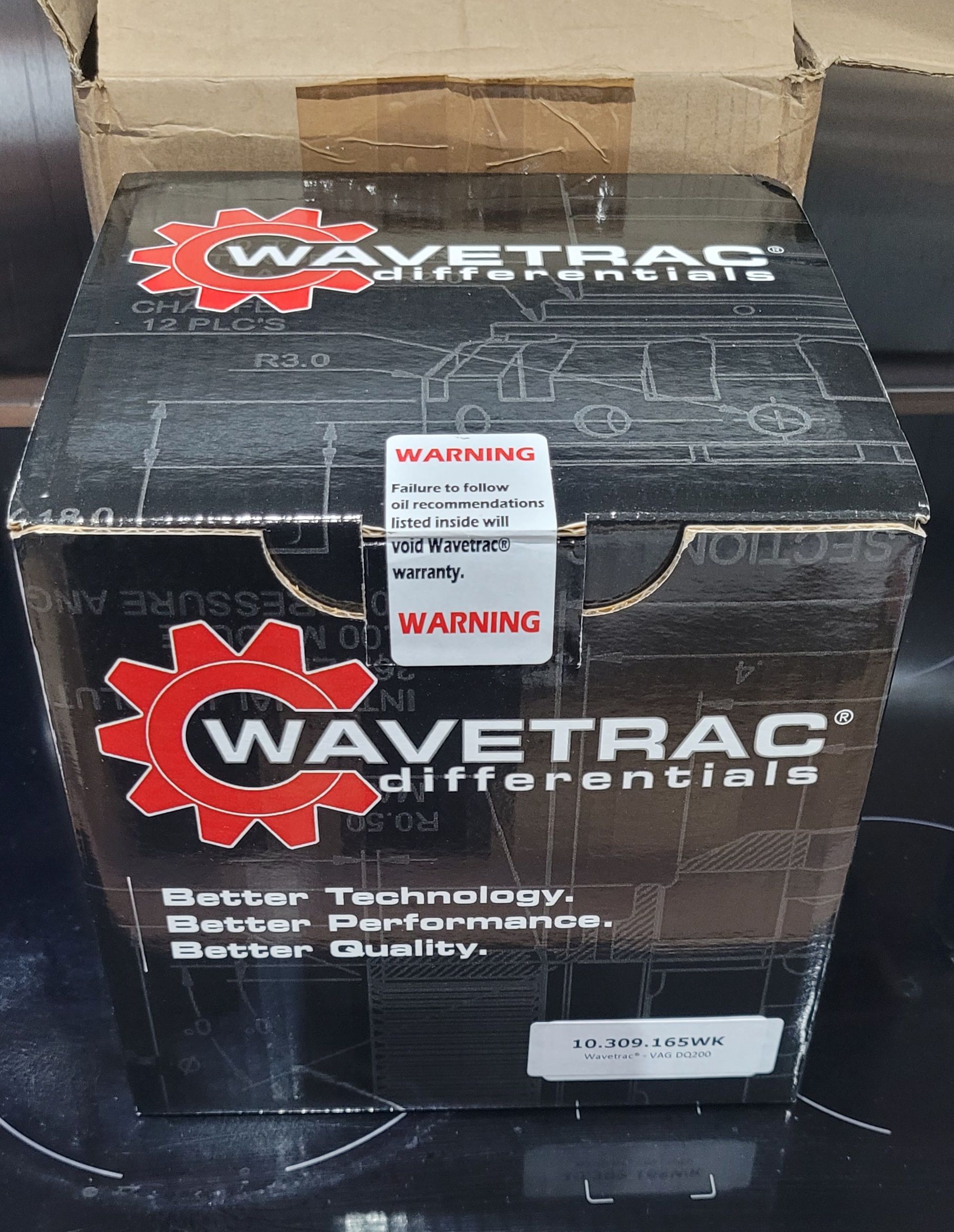

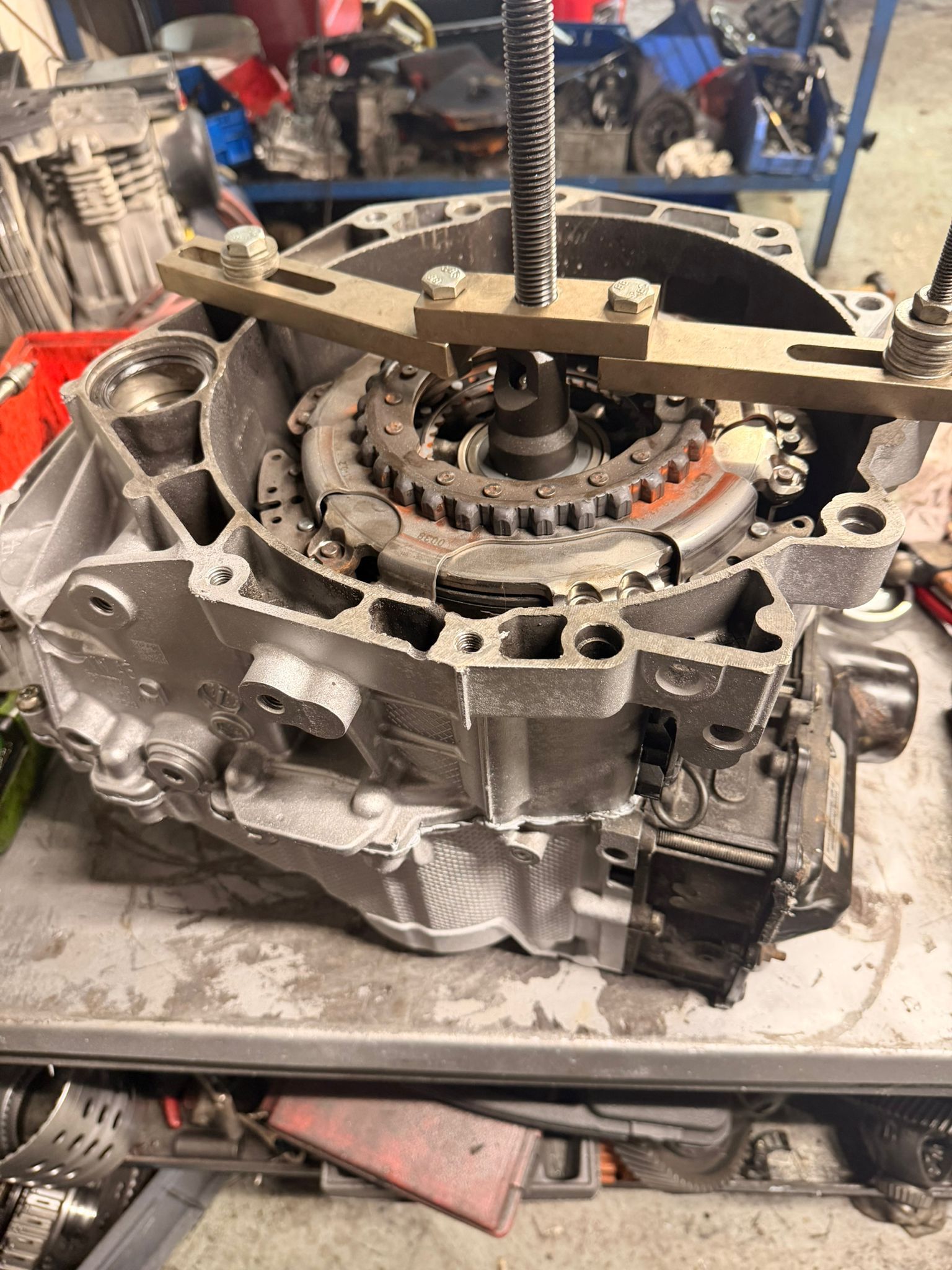

She's In!! Massive thanks to Lancashire Transmissions in Radcliffe once again, knocked it out the park!!
To my knowledge first and only DQ200 with a wavetrac LSD in the country.....and jeez what a difference does it make!!
Can't wait to get back on track now 💪
20260406_151502.jpgmotion_photo_2804163252586514602.jpgmotion_photo_5805615722750029093.jpgmotion_photo_6465901134361681299.jpgmotion_photo_459461443492637407.jpgmotion_photo_5125709230649233202.jpgmotion_photo_7961033786092944371.jpgmotion_photo_3398295395601697201.jpgmotion_photo_6127651995553330108.jpgmotion_photo_3519725003124129619.jpgmotion_photo_858601249689987584.jpgmotion_photo_2661759031889240471.jpg
You are going to have some fun with that, let us know how it goes.
