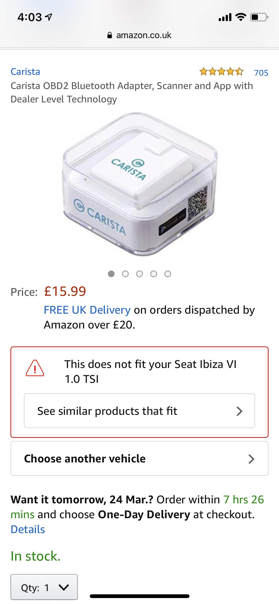

Does Carista 100% work with the mk6? I’ve just gone on to amazon to buy and it says it doesn’t fit my car (or my partners 66plate Ateca)

Hi, yes it 'works' . I didn't go crazy with it but managed to:
-turn off seat belt warning alarm
-change coming home lights to activate when door opens (not ignition off)
-display fan speed in auto mode
-set mirrors to auto-fold when locking the car.
For me there are too many questions over possible warranty issues to play about with it for the sake of it.
