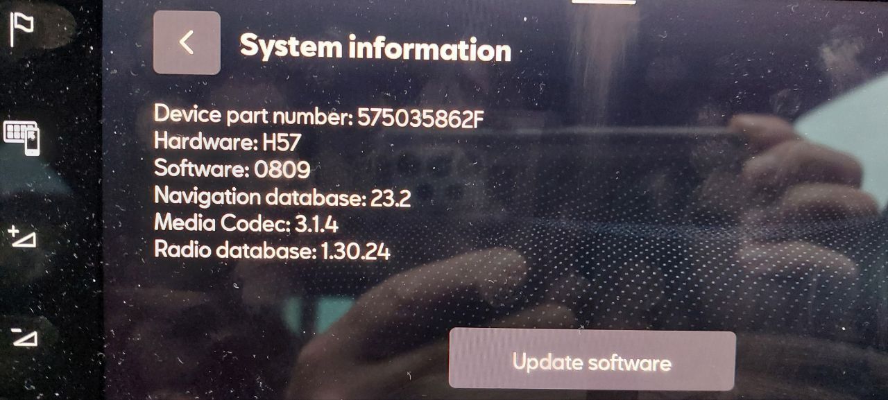

Reckon it is up-to-date. Been having a conversation on this thread. 23.1 was cìted as the latest you got 23.2... e.g.. Feb 2023. One month on.Here is latest version, says update, but I cannot find how to update it?
Okay, thank you. Was hoping some new update to cure restarting issues, media stick issues etc.Reckon it is up-to-date. Been having a conversation on this thread. 23.1 was cìted as the latest you got 23.2... e.g.. Feb 2023. One month on.
Reckon the button just says update but probably doesn't say "nothing to update". ?
Software version

It's your firmware code 0809 which is the release you are on, so the question whether that's the latest, bugs on it etc. Reckon I've seen that release on Arona in conversations. Leon and Formentors have a different code.Okay, thank you. Was hoping some new update to cure restarting issues, media stick issues etc.

Sorry to revise a July 2023 Thread, however I was just wondering if anyone can tell me, if this is the latest software ?
Might be prudent to add that we are in Australia and we are always a few years behind.
Not sure what this system is... M3 or 2 or something else... it has all confused me a little but I will learn.
Is a Cupra Ateca VZx Build 2024 (sorry can't remember month right now) and it has several annoying issues with shutting down after turning off car... and not remember what media source or file is being played.
Details below.
Device Part Number 575035876G
Hardware H31
Software 0442
Navigation Database 22.12
Media Codec 2516a208c7c3d54ed8991b820f4671119a5ad1ce

I will attempt to magic up @East Yorkshire Retrofits who are experts on firmware. Generally now you cant do firmware updates as a DIY task. It isnt supported by Vag, probably never was, so they have gone out of their way to clamp down on it. Map updates are different from firmware updates and those you can do yourself especially if you dont have connect services. Some people do... but prone to difficulties.
The 0442 firmware is different from the Leon 4 series. But I'll dig a hole for myself so I'll get out quick. The issues you read about are on the xxxx then people try to jump that leading letter. Like mib2 standard they get in a mess and that firmware isnt officially available in anycase and other stuff needs to be done.
You might have newer firmware than that but then @East Yorkshire Retrofits will say take it to your dealer in OZ. They will know. I do eyeball those libraries to check.
No the maps are separate from the firmware. If the firmware is updated it doesn't revert the maps.
The map will only get updated if the update is fine. There is strong validation of the file. Why you have to get it into the direction as expected. PCs are fine. Mac you have to use clean my drive. On the positive side Australian maps are comparitely small compared to Europe so it wont take long.
