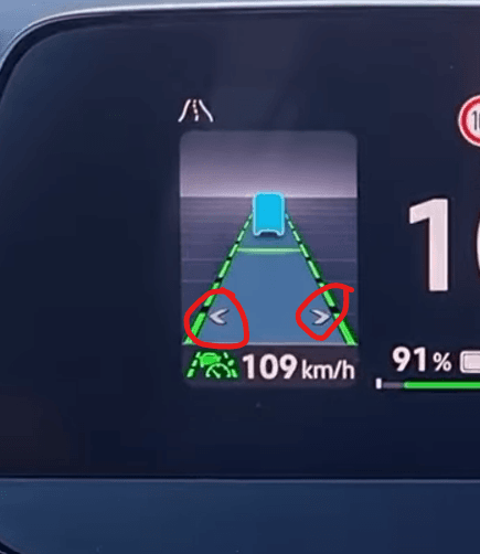

Ahh I think i get it .. it's these tiny arrows.. I think i might have seen these before. But I haven't been out since this revelation so might be wrong. So if you see these arrows you just turn indicator to which side you want to go and it will perform the lane change..?

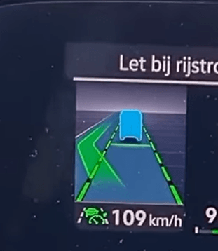

Then once you start manoeuvre you see this.
(Grabs from a vw id4 you tube video so might be completely wrong with Formentor)
Yeah that's my understanding of it. You don't fully push the indicator so it clicks, just enough to start the turn signal and it will automatically cancel the indicator when the lane change is complete.

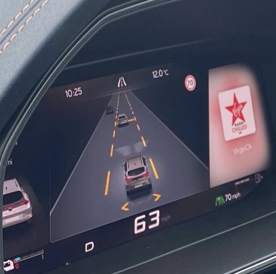

I got a photo today on motorway
So I think orange arrows mean auto lane change available and grey lanes means you can use it - however before getting to excited it barely ever works without having to take over ! ?

Yup sort of worked... in so far as I got the arrows to say it was available, I flicked the indicator and got the bigger arrow and a note to tell me to check surroundings ? then a very very slow lane change, now I know why I hadn't seen it before I really don't get that long to change lanes! Also thought it would plan it in relation to slower cars in my lane but no, it still braked, so overall pretty useless really ?
