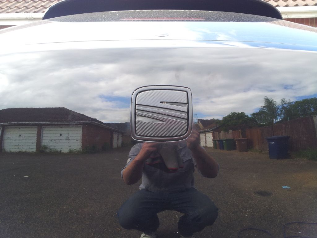

Rear s badge complete

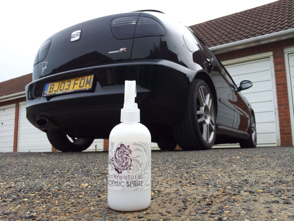

So the badge mission is finished lol :D But first I was at Modified nationals this weekend and alongside a few other bits i purchased Dodo juices new Supernatural 'Acrylic Spritz' due to being fed up of limescale and rainmarks left by our oh so wonderful British weather :lol: For those who aren't sure what this is,it's a water-based synthetic spray sealant,it is also a protectant to go over your existing wax which doesn't effect your previous hard work.What this does is creates more beading of rain/water,removes limescale/rain marks and leaves the car even shinier than before,supposedly lasts up to 3-4 weeks but so far it actually works.I've had two days of rain and now the sun has come out I have seen that finally there is a company that doesn't talk s**t now I know why I wont use anything else :clap: Here are a couple of photo's of this product applied and then a couple of the 's' badge wrapped let me know your thought's and opinions on old or the new much appreciated :D
New sealant applied
Rear 's' badge wrapped
Looks better than the front one, but would have been even better just plain black imo..

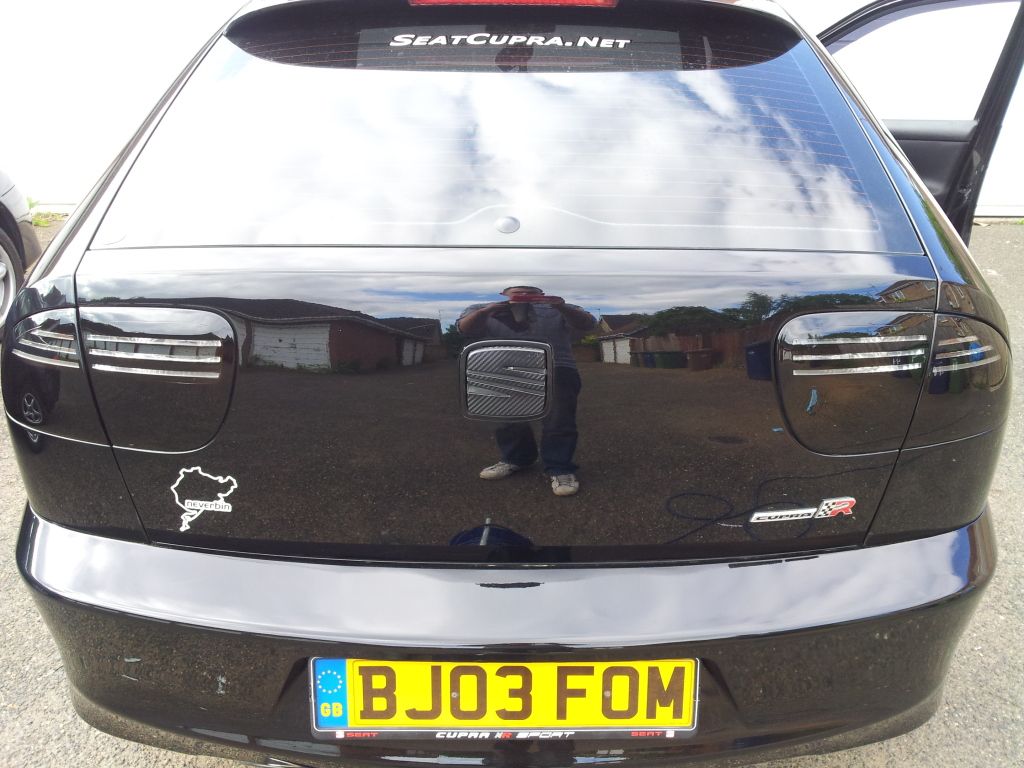

Car looks to be pretty clean. Nasty dent there though.. :(
Dent :confused: I have a ping pong dent but it's not that noticeable guy who had it before me had done it don't know how :shrug: you must be seeing something in the reflection of the boot as it's so clean :D appart from the fingerprints just under the badge whoops lol

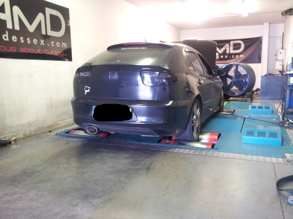

Amd Custom stage one & Milltek cat back non-res exhaust done!!!
Ok so it's bin a while but finally I have some new updates as you can guess by the title map and exhaust is now done.
After alot of research I chose AMD to be the right company to look after my pride and joy and what a decision and transformation,I can officialy say I have the love for driving back again :D

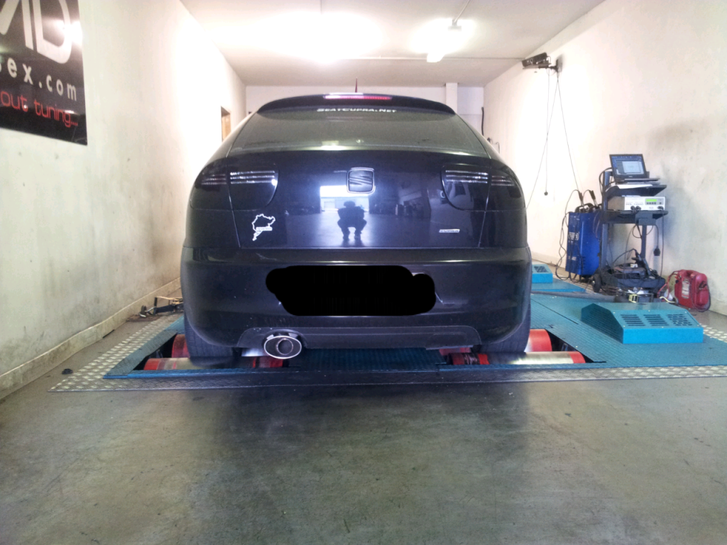

Heres a couple of photos of my day at Amd:

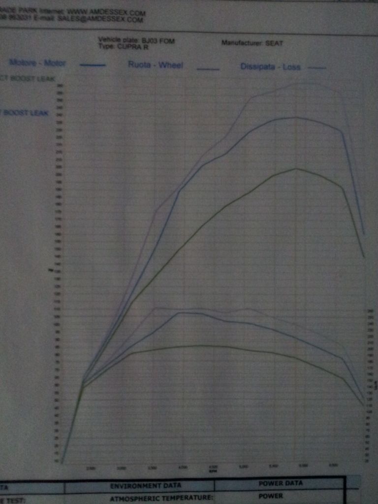

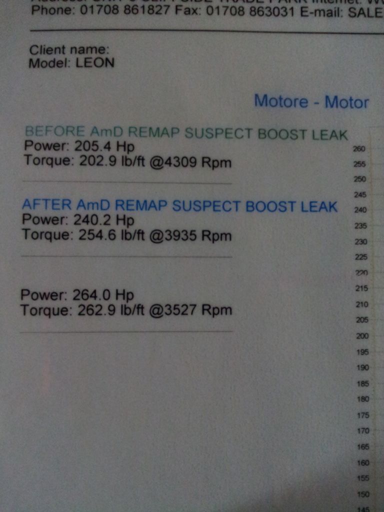

My results:

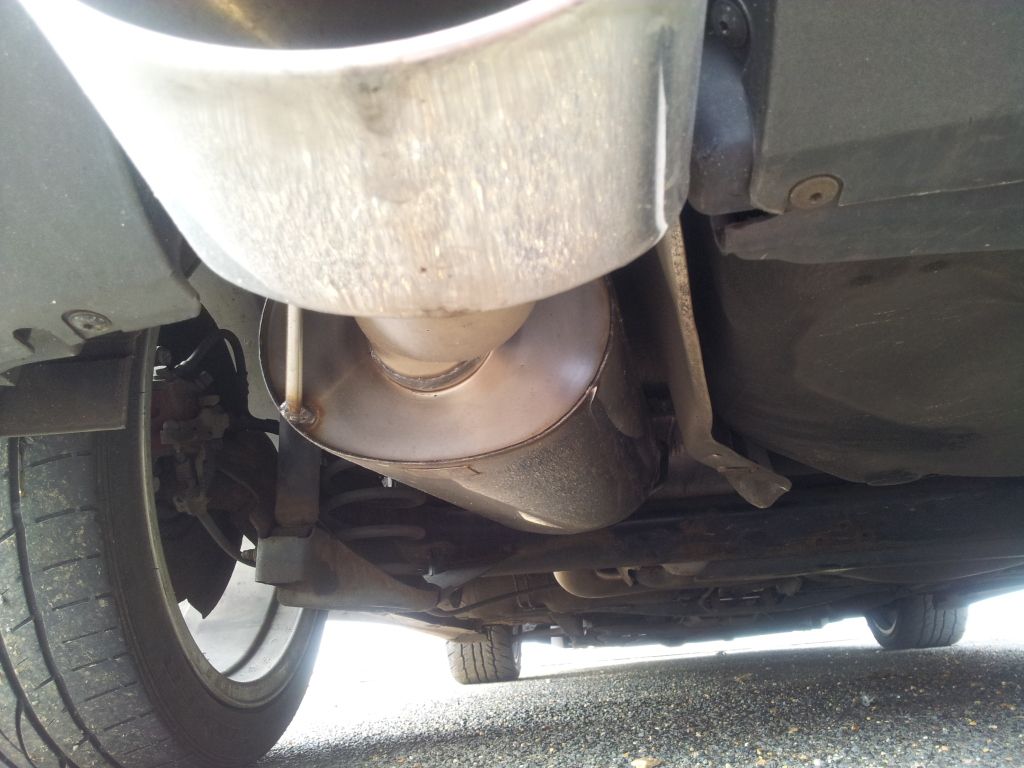

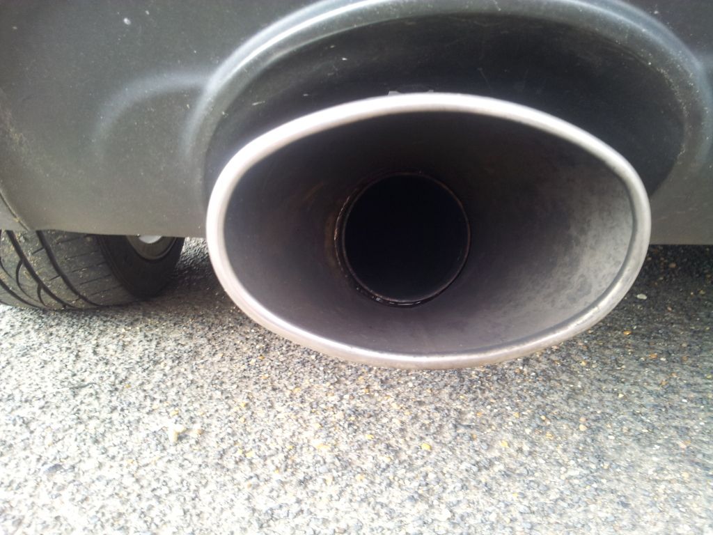

Some of the exhaust:
I was really pleased with the results but as such the map is still adapting so fingers crossed it's a little more rather than less :D
My mpg has gone from 28's to 34/35's and well the rest explains itself.

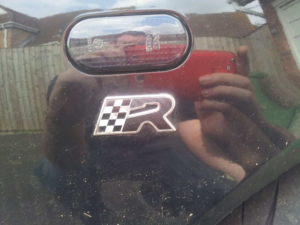

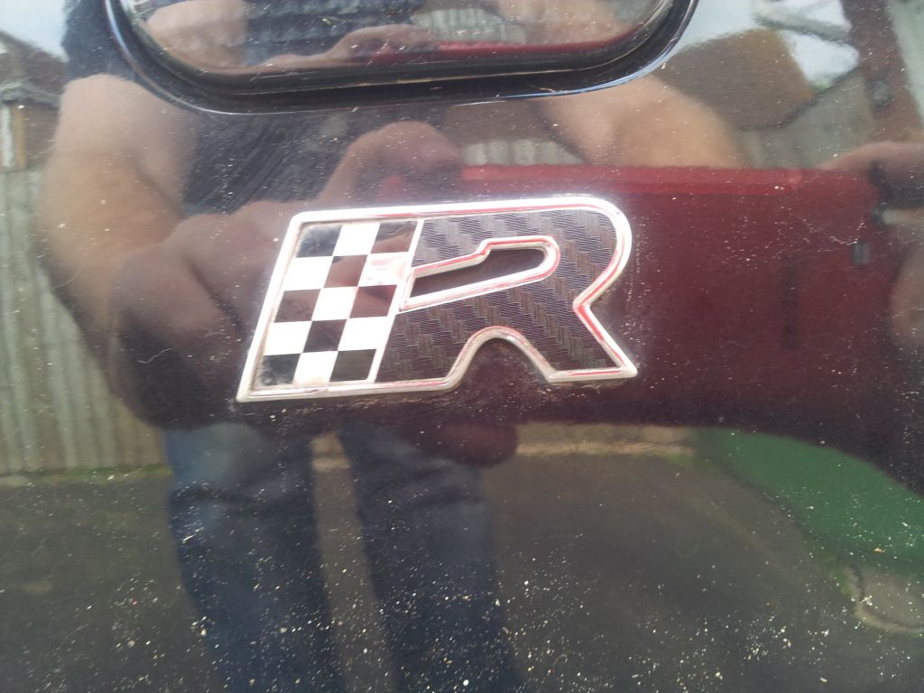

I added another little touch today as I'm not sure of the removal of the side R's I have carbon'd the red part of the R's which isn't to everbody's taste but I like it.

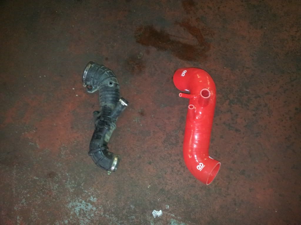

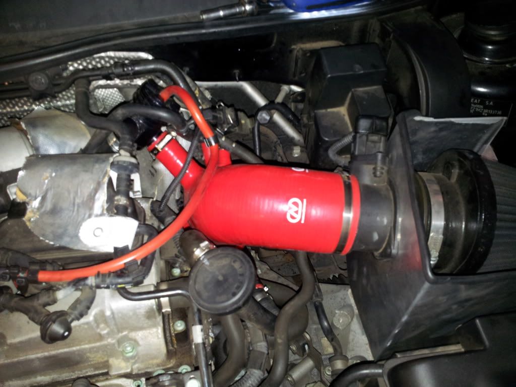

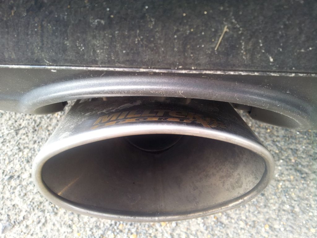

I finally purchased the 80mm Tip for the car but although I did want Badger 5 one funds wouldn't allow so instead I went for the Creation.M one with the billet adaptor which I am actually quite impressed with: Increased pull not only lower end but top end aswell,quicker spool and it certainly looks the part to me anyway.

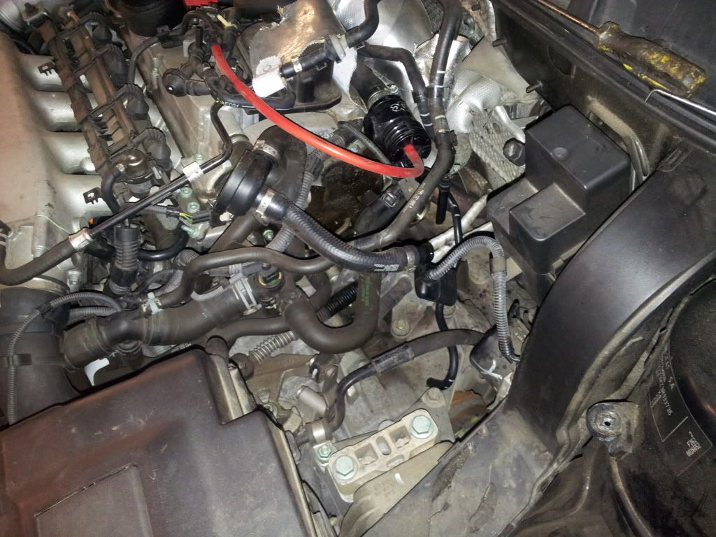

Original removed(it's a little messy atm as haven't got round to engine detailing yet :rolleyes: )
New Tip compared to old
Tip fitted

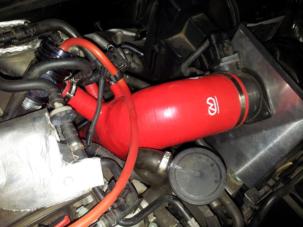

I have replaced the brake vacuum hose and servo hose I will upload those photos when I get a minute appart from that thoughts welcome :D
Did you have trim the TIP a lot or it was an easy fit? Someone had a few issues with the Creations Motorsport TIP a few months ago, I hope that they updated the design since then.

The billet is a nice tight fit so you don't have to worry about air leaks :D but make sure on the inner circumfrance of the billet that goes to the turbo you apply a heat proof silicone and do up the grub screws either side of the billet tightly(they are what is a pain in the a** lol)then place the hose on the billet adjust to the position you are happy and everything else goes in place.You do have to cut a little of the silicone pipes (on the Tip) down but honestly it's worth it and I very much doubt any of the others don't have to be modified slightly either but each to there own.
I also recieved a great,polite and fast service from the C.M guys which sometimes I have not from other companys so it is definitely one I would recommend alongside Bill at Badger 5(just to make this clear I am not comparing either or slating one or the other as I know this is a hot subject for arguments among enthusiasts I am stating I would definitely go for C.M's or Badger 5's Tip)
At the end of the day the decision is yours but don't be swayed by other people be different and choose what you want,Thanks for the kind comment :D
