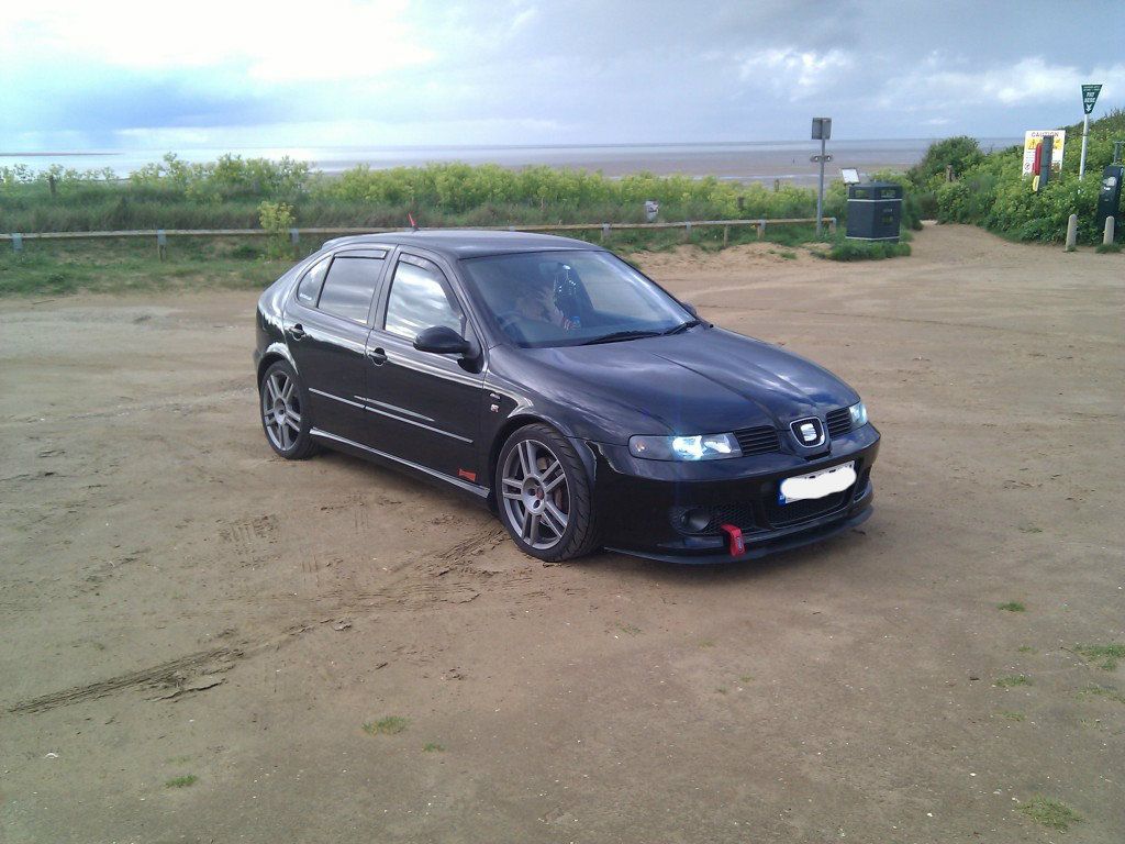

Some more recent pics
Update

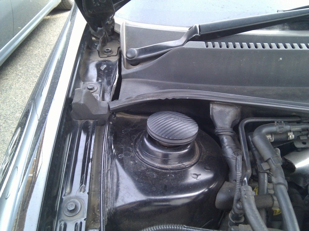

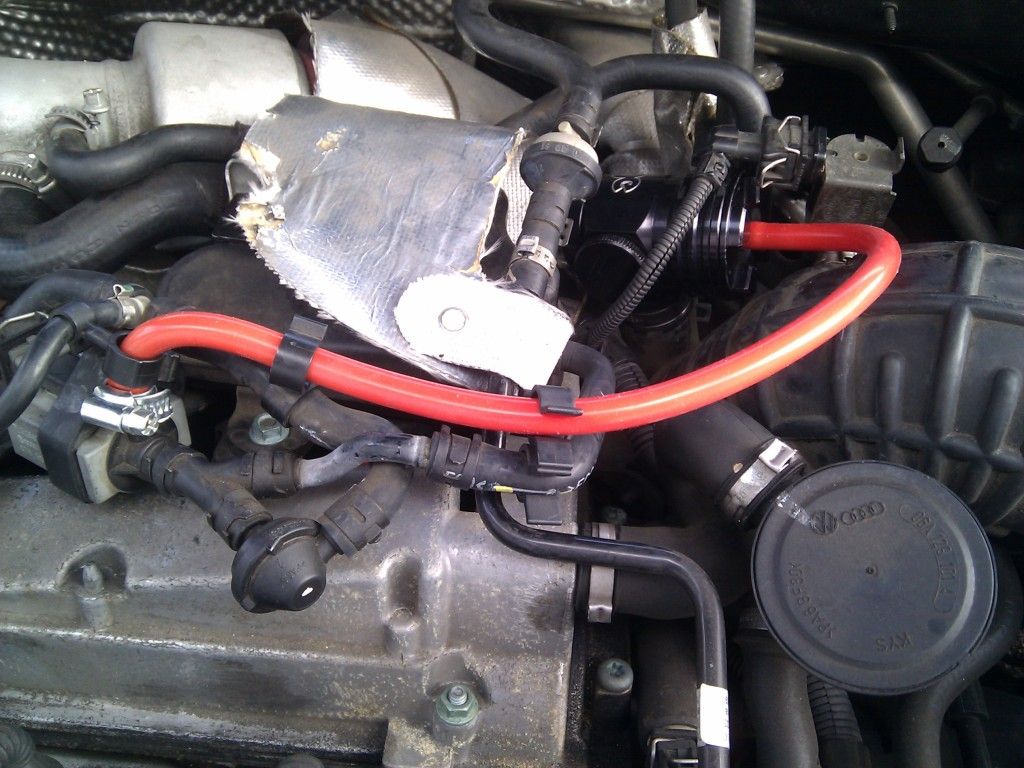

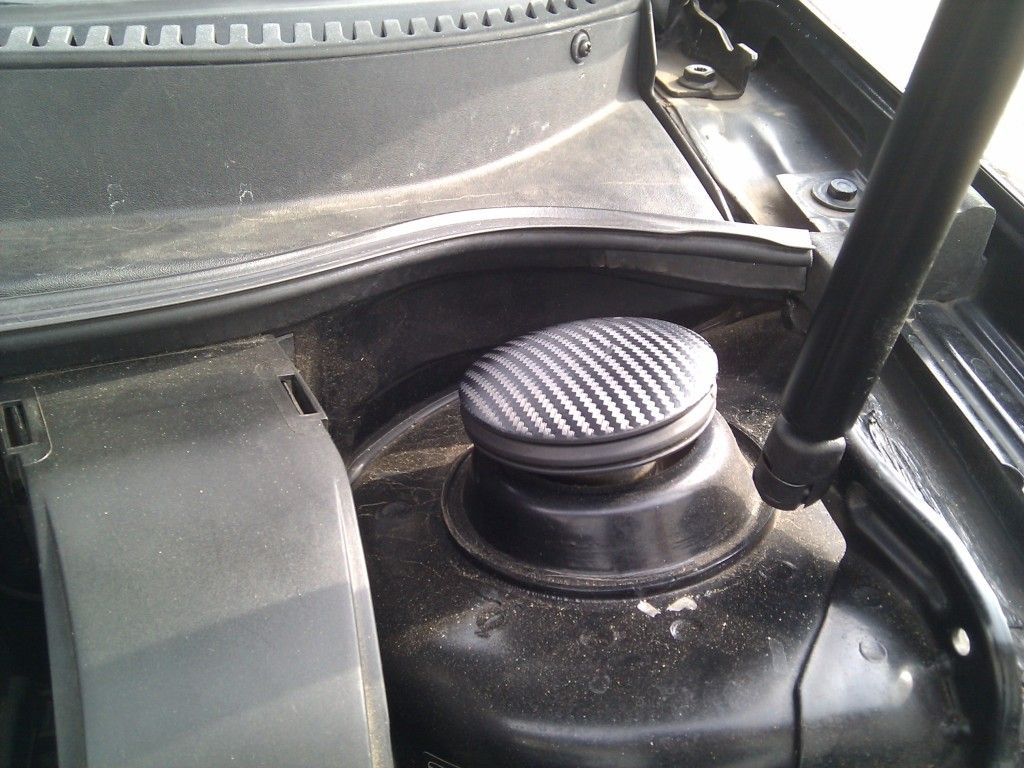

So I made a minor error with the fitting of the dump valve thanks to the non instructed box I made the assumption that the d/v stood up like a 007p rather than lay on it's side lol my bad all corrected now and whilst I was under the bonnet and eagerly awaiting payday i thought i would invest in a small modification in which I must say was 110 % worth every penny the boost is stronger car nippier,turbo build up and d/v ALOT louder and all for about £7 I partook in the N249 bypass :funk::D
D/v adjustment
N249 bypass....

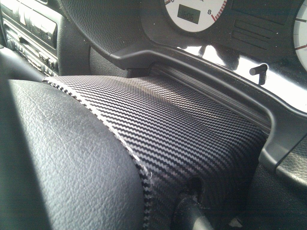

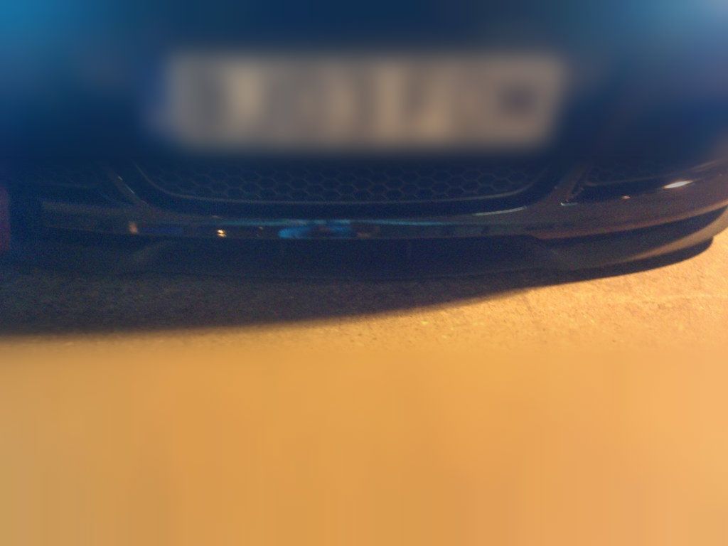

Then I decided to use some of my left over carbon wrap..
After i also decided to detail the car as i felt it was a little dirty(means filthy really) :rofl:
heres a few photos afterwards (around town):

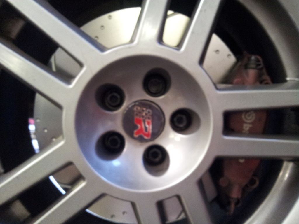

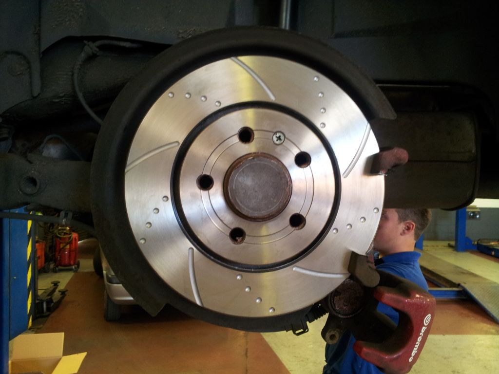

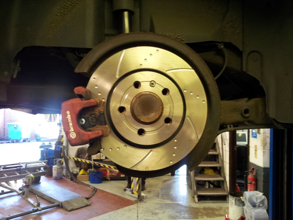

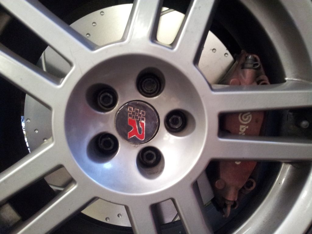

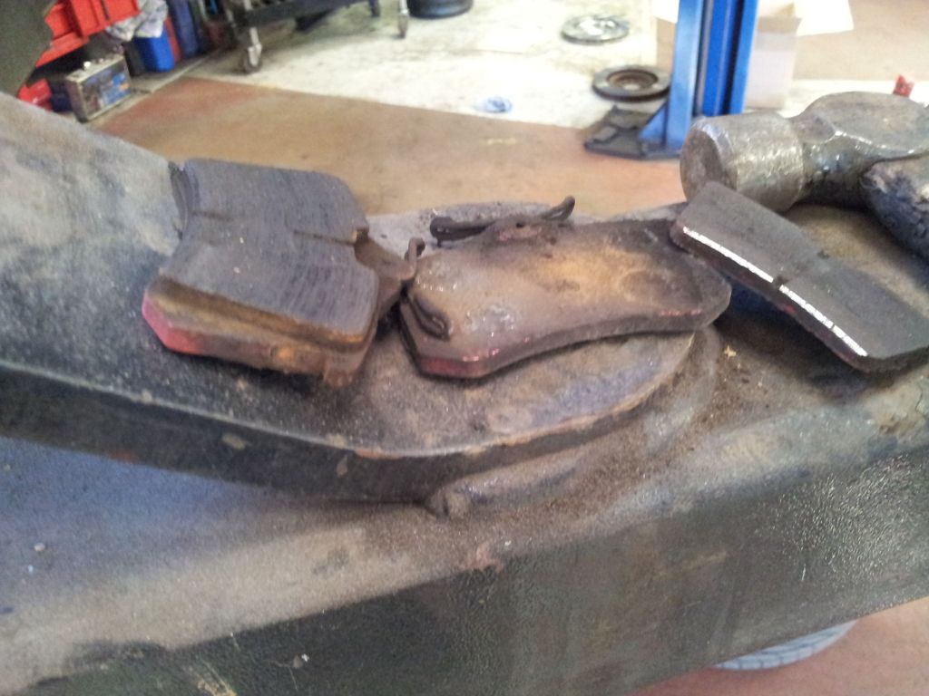

New Discs and pads

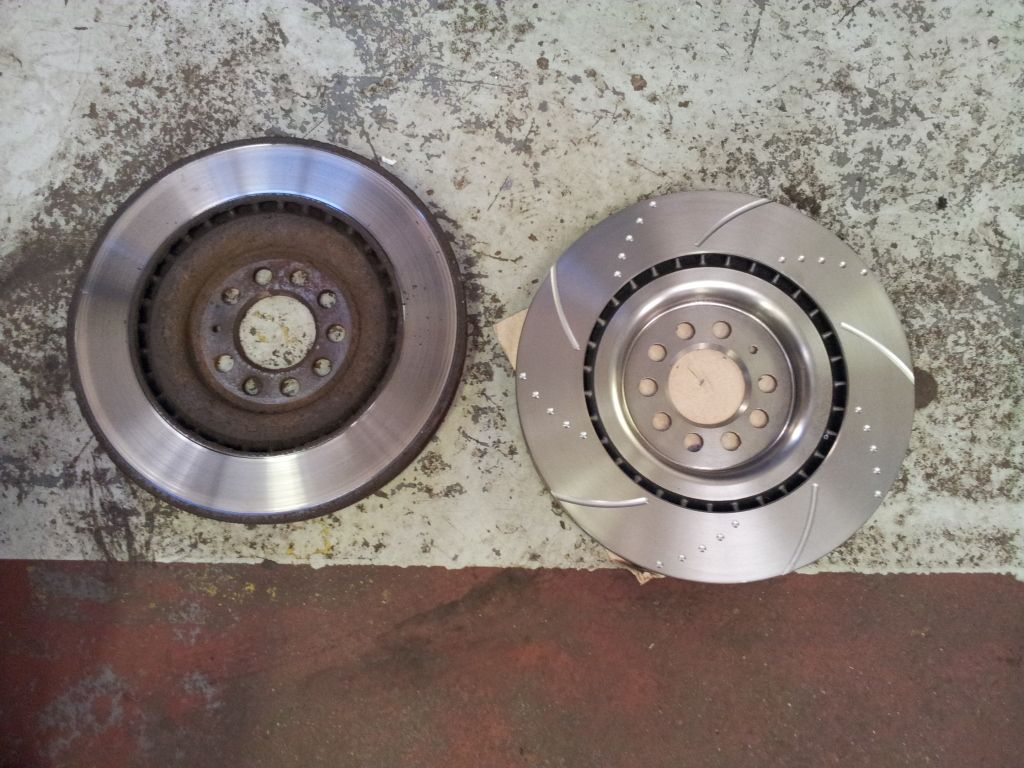

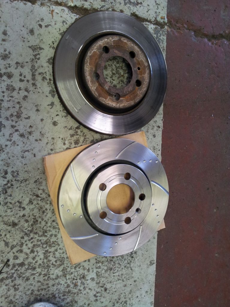

Well the other day on the way to work i heard a nasty screech noise from the front brakes and as i got out of the car i noticed a fresh score mark around the discs as the pads had started to reach the metal....WOOPS :( but it was about time she had new discs and pads so after much reading up I decided to go with grooved and dimpled discs and Ferodo ds2500 brake pads :D
Old vs New
This is what happened when the rear pads were removed :lol:
Fitted
At some point i will get round to refurbing the calipers as they have faded :censored: but next on the list is the Milltek cat back non resonated exhaust system,I will upload the photo's A.S.A.P :D

Btw you mentioned refurbing your brembos (which im gonna do too) but did you know as a short term fix, use T-cut red on the rears. I done mine years ago and the bright red, and heavy gloss lasts for AGES! Paint the front.....but t-cut the rears (unless of course there is paint coming off)
