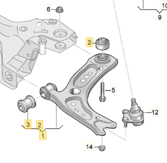

Do you mean the front lower wishbone bushes? number 2 & 3.
These are bonded rubber - there is/should be no sliding movement - so grease wound't do anything. If there is sliding movement then they need to be replaced. These bushes (number 3 specifically) need to be torqued up with the wishbone at the correct ride height otherwise it will preload/twist the bushes and ruin it in no time.

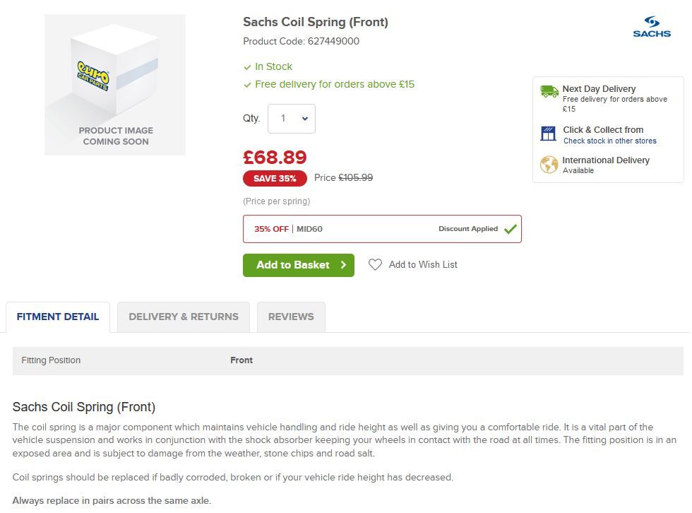

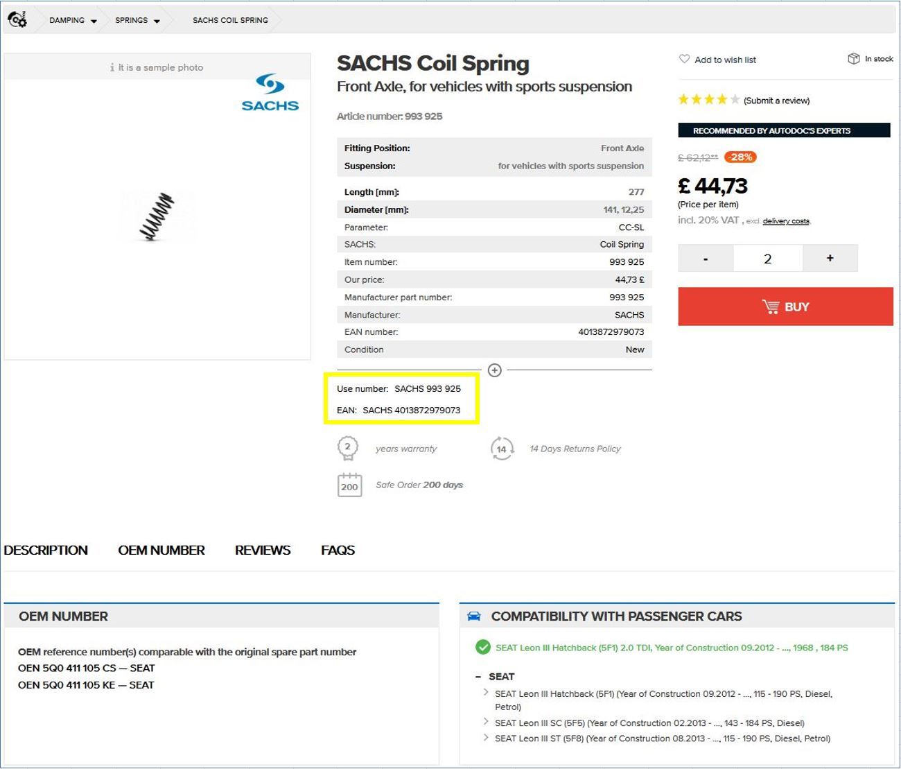

On the point re- ECP and Sachs front OEM springs - I haven't paid for them yet (£69/ea) but when I collect should I check the SACHS/EAN number as in picture from AUTODOC search below? Can someone confirm that this item matches the official SEAT parts list? (Car is 2016 Seat Leon 184FR)

ECP ordered part - this is the ONLY option based on my car details.
Give me your reg and I can confirm the exact OE number for your front springs.
As I said there are over 50 versions of spring part numbers for the Leon all linked to PR codes. I guarantee there aren't 50 equivalent springs for the Leon from ECP from ANY brand.
Will said aftermarket springs be ok? I'm sure they'll be 'ok', may find higher/lower/softer/firmer than the genuine spring?
If it was me - there isn't much saving on aftermarket springs I would get the correct OEM parts - unless you are on purpose trying to alter the ride and know spring height/rates to aim for.
Reactions: Mr Pig
Ooh this could be interesting - I guess Ill need to visually verify the part number before paying!! Is part number 993 925 the correct FRONT spring part for my car? (as per Auto doc website)
Woody & SuperV8 - if 994 960 is the REAR spring part number, then this is super useful as I will probably get the springs replaced if I upgrade the rear ARB to reduce over steer.
It is the rear spring, I'm glad you're awake ?. Yes, if you scroll further down, their parts number for the Sachs spring matches yours and it does say 'for vehicles with sports suspension'.
