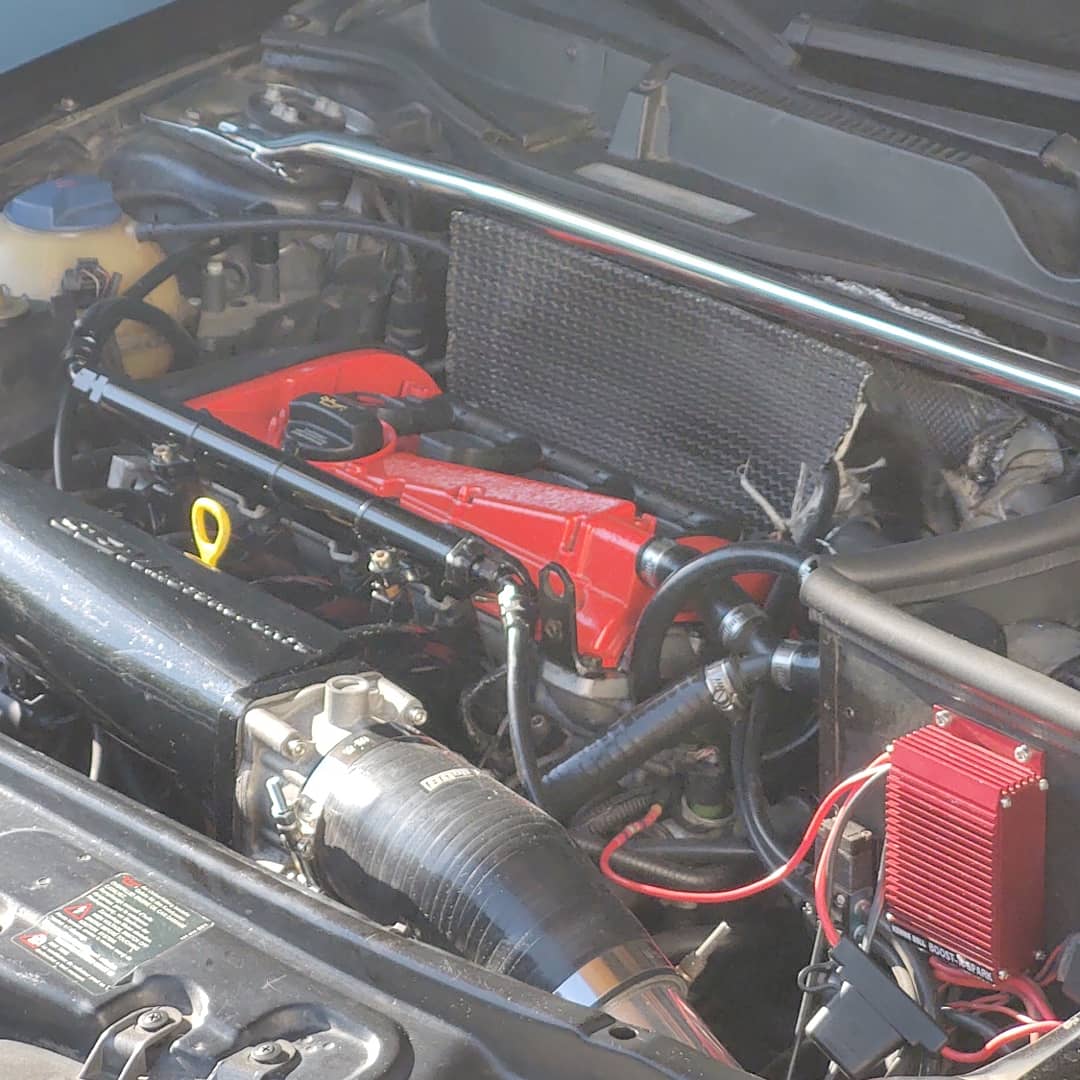

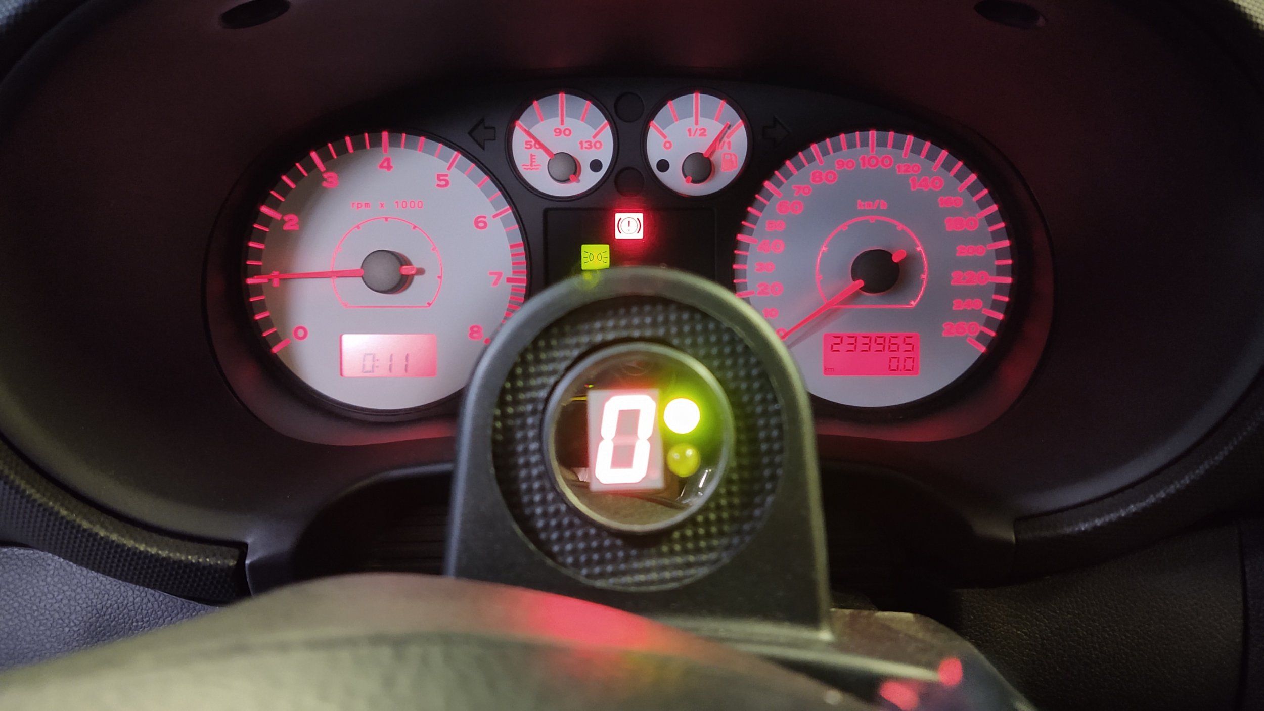

5 years later. Can't believe I still build this car and love it more than ever.
Now running a GTX3582R gen 2 with a 84RS turbine. Haldex gen 1. Ignitron ECU. SQS dogbox with a sequential eshifter. Some aero bits.
