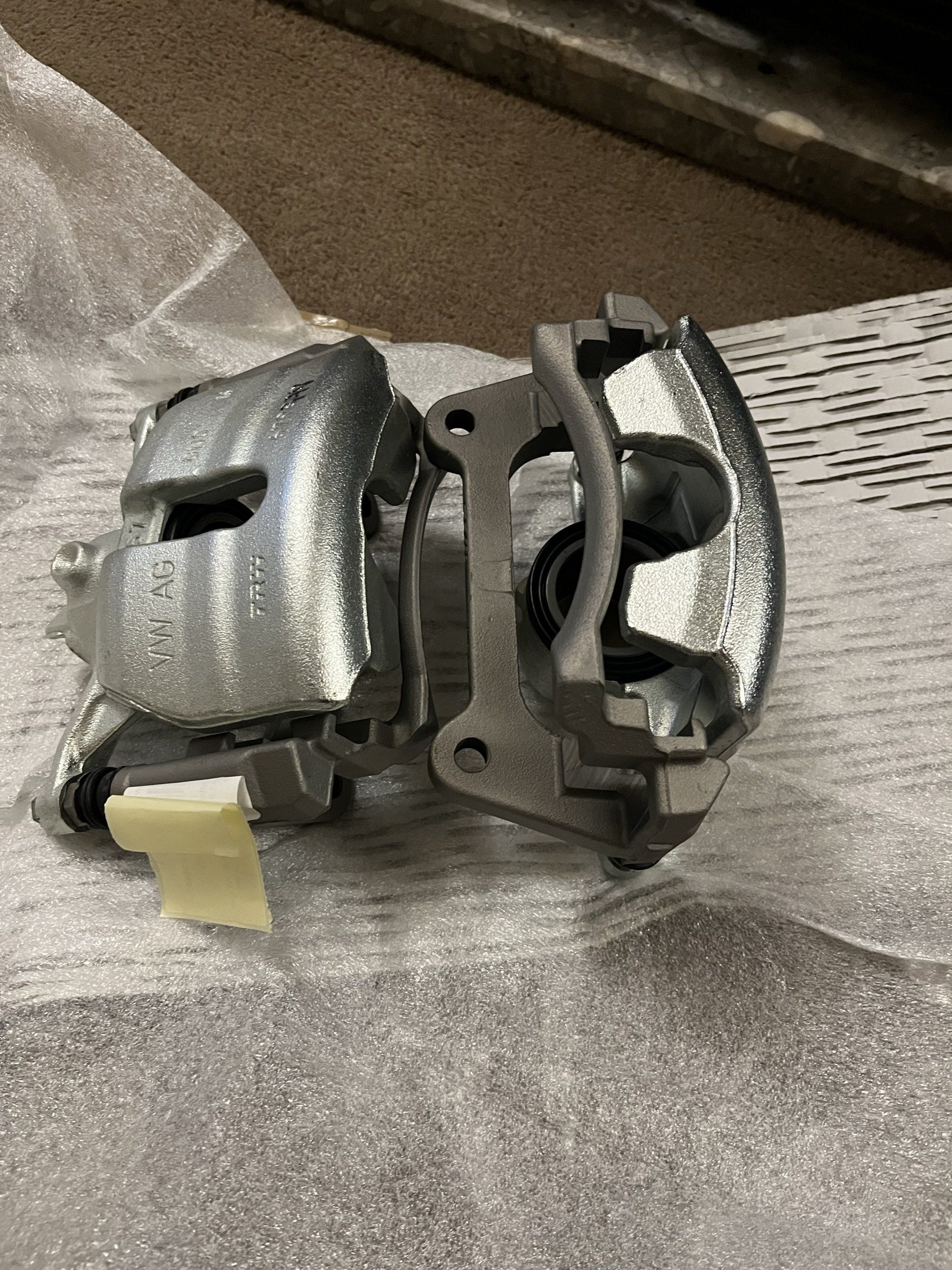

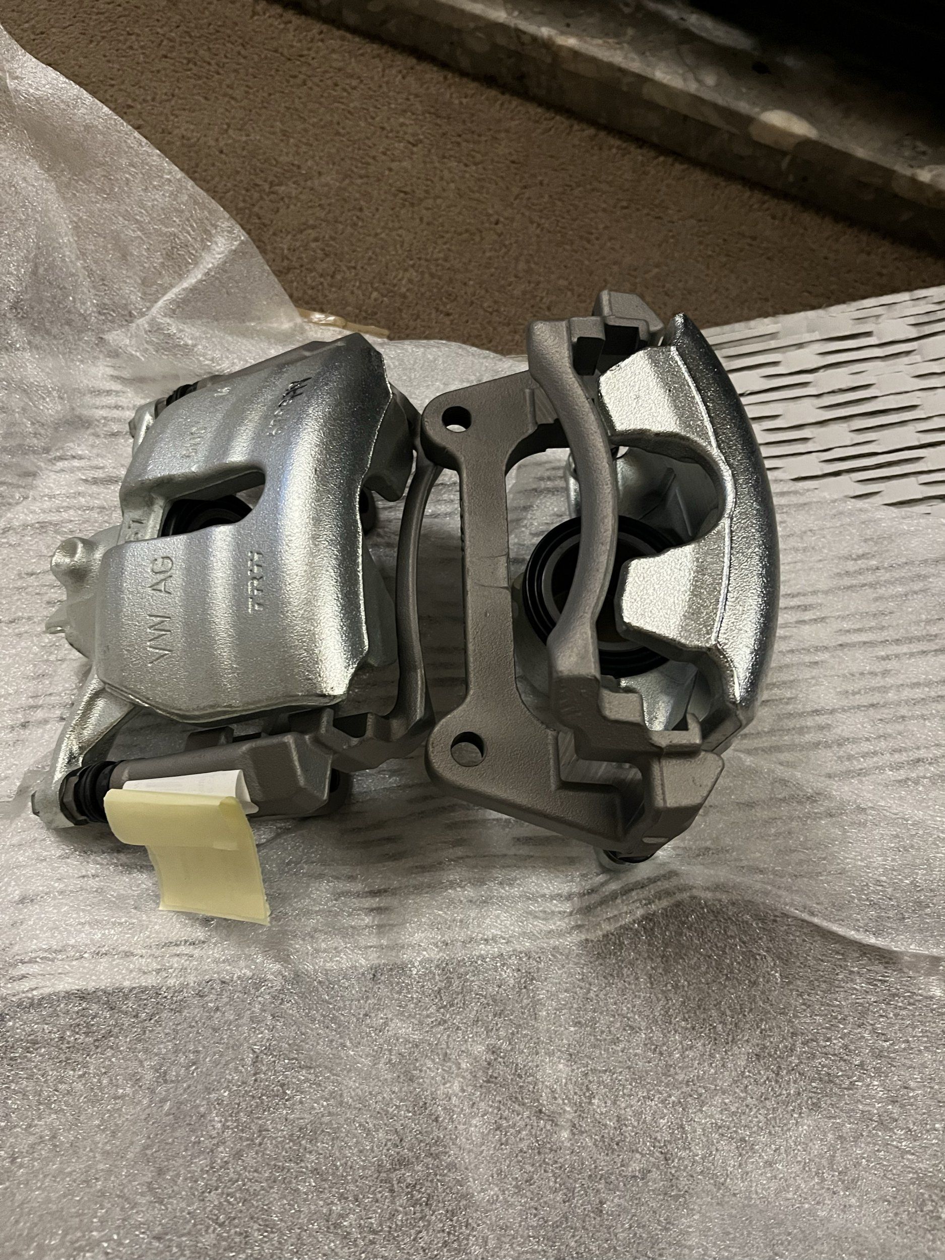

So I ordered a set of front calipers this evening, I shall update you on the progress whether you’re interested or not, all help has been very appreciated

Little update, finally arrived today, going to give them a little lick of paint when I get chance which might be this weekend or might not but shall keep up with the updates
