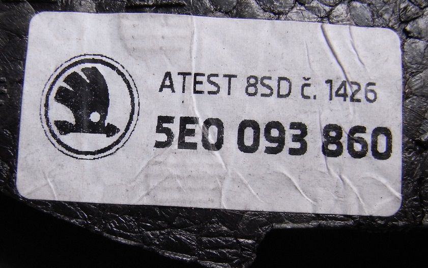

This is the Skoda kit in my wife's Leon ST. It'll fit inside a 16'' wheel and above. There are a few different kits that will work but this one is the best as it the good additional space for extra items.
Any modern VWG jack will work as all of cars are built on the same MBQ platform.

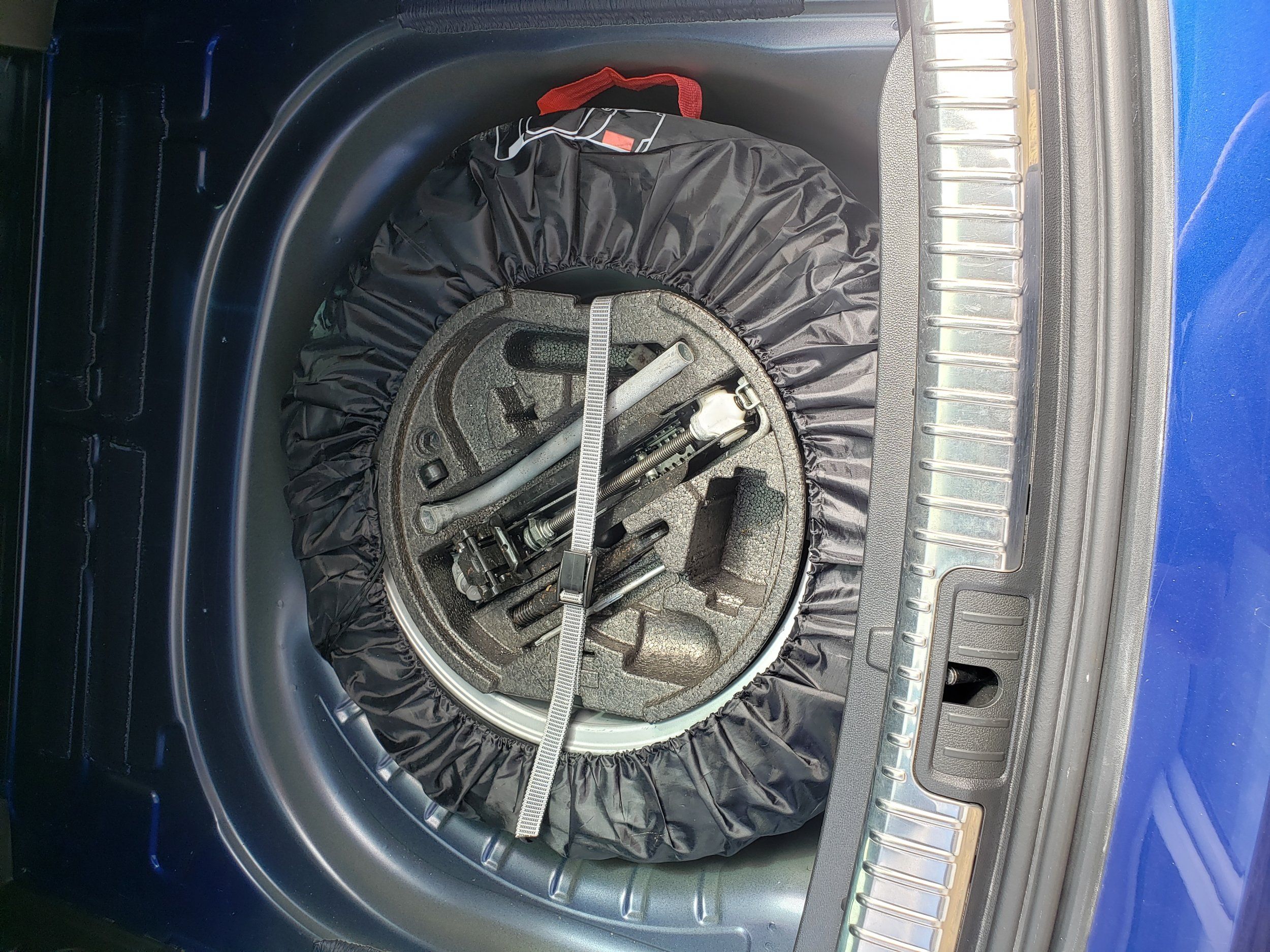

Just to confirm, having both my previous hatchback and current ST estate models. Hatch will only take a 125 width spacesaver without it sitting proud of the boot floor, but the estate will take a full size spare. I have a full size matching 225/45/17 inch alloy and a Skoda tool kit sitting in the spare in my estate and it fits perfectly with the floor lying in the correct place. Yes I know the insert is actually for a 16 inch, but its secure enough when strapped in, the tools are all the same, and I'm not replacing like for like just so it fits more snugly!

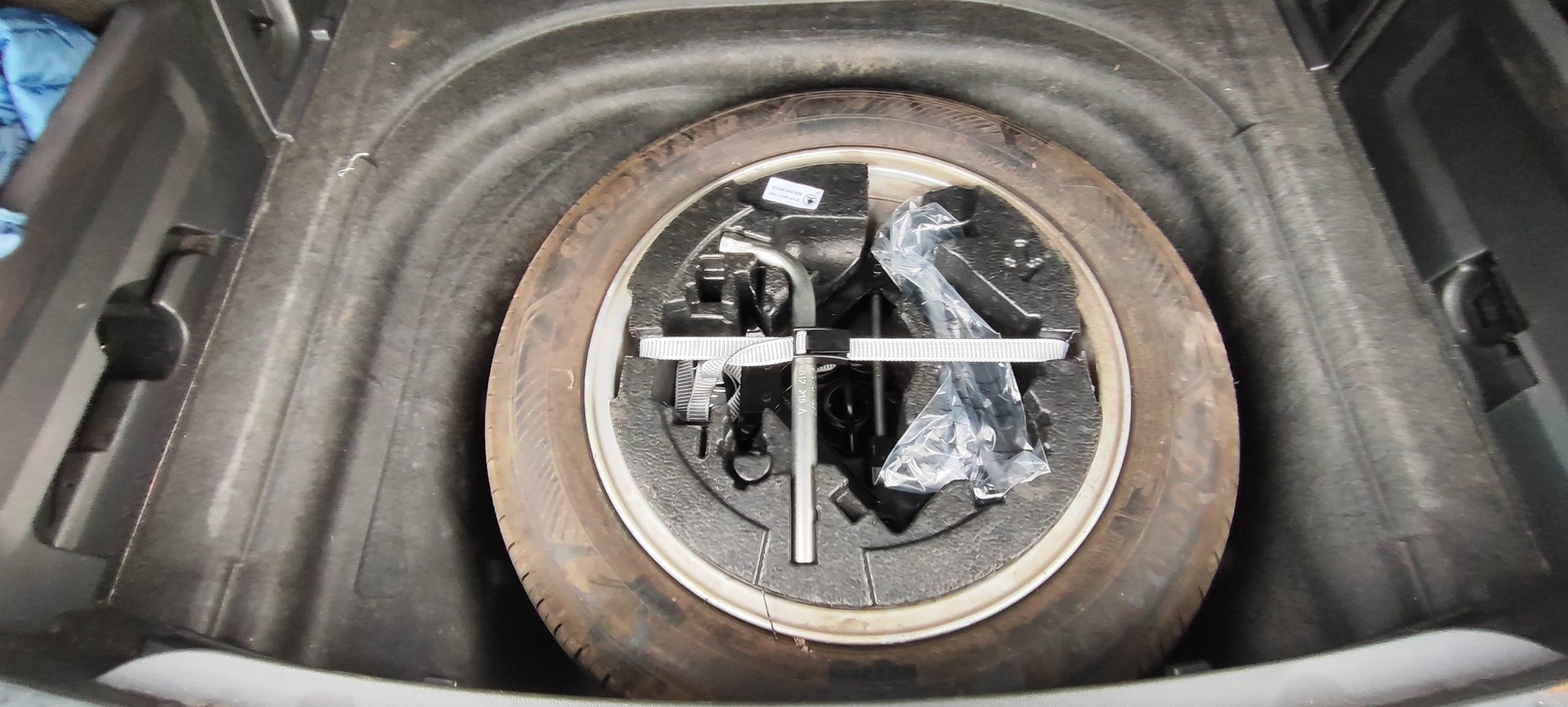

16 inch alloy with the Skoda Octavia foam and kit. Quite hard to find, I managed to get a brand new one from Czech Republic from a Skoda parts site delivered for €76 which I thought was pretty good and arrived fairly quickly. Big thanks to @Mr Pig for the info.

That's the one you want. There are a couple of different kits but this one is best because it comes with a better jack. This jack is stronger than the 'half' scissor jack other kits have.

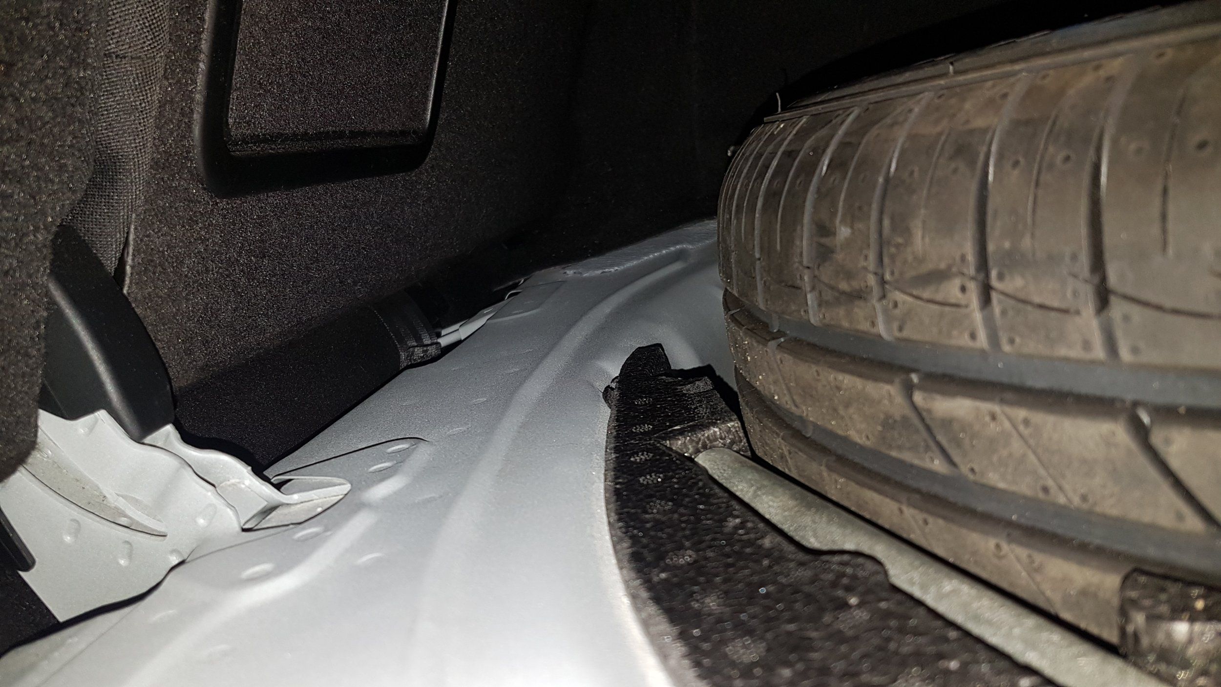

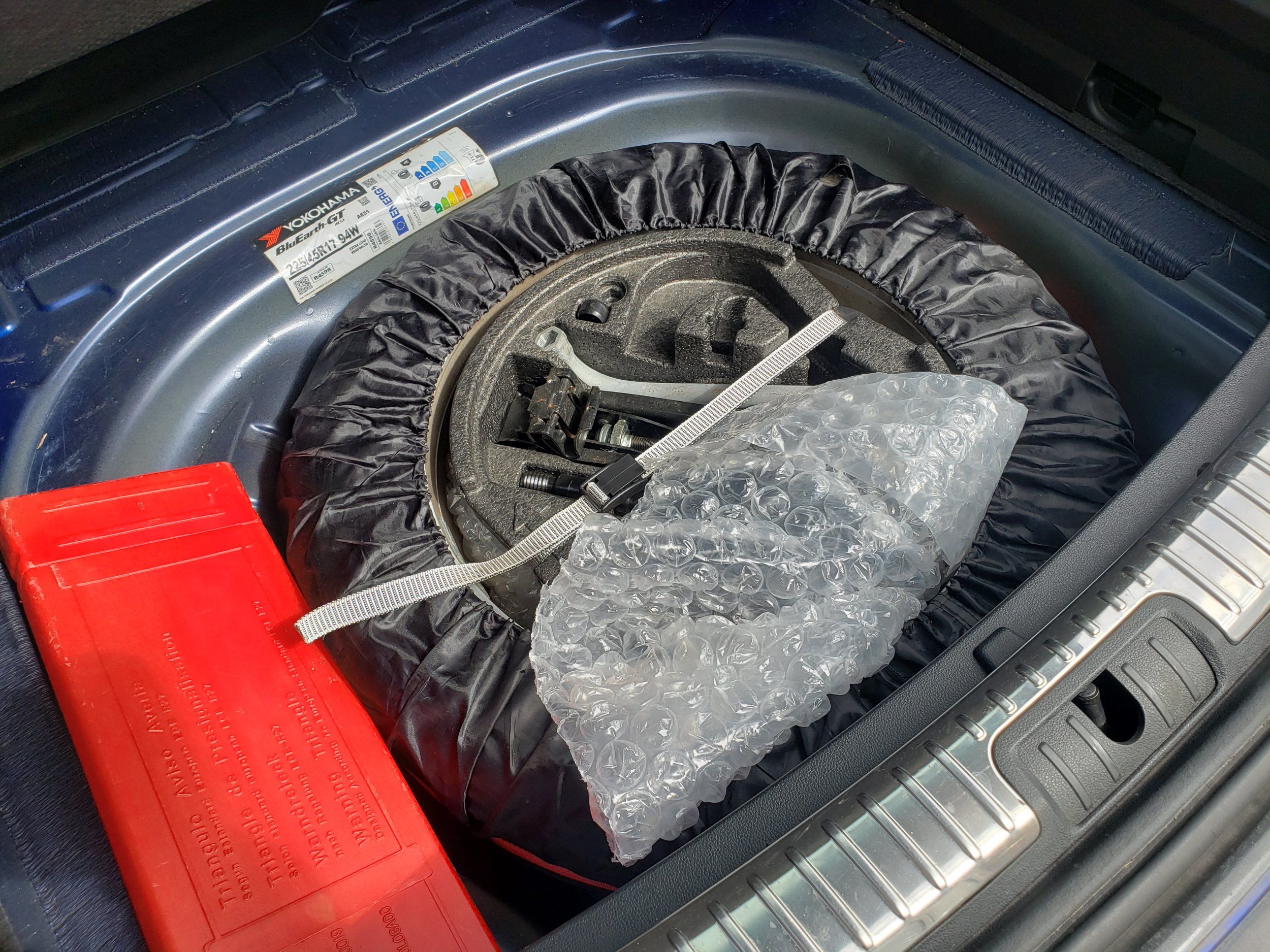

Yes, both the Leon 2 and Leon 2 have the same 112PCD stud pattern. The full size won't however fit under the floor in the boot if yours is a hatchback, but it will if it is an estate. Photos here of a full size spare in my old hatchback (white car) and my current estate (blue). The space saver will fit in both the hatch and estate
