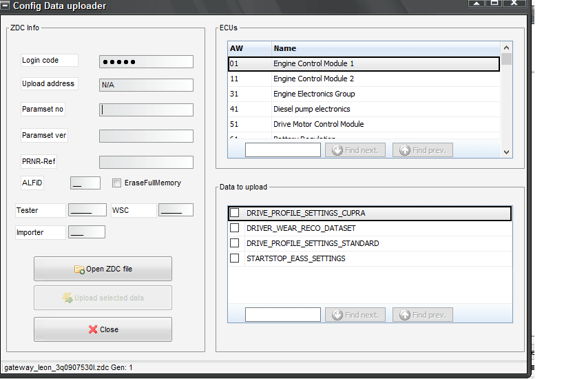

so today i upgraded my gateway from 5q mid to 3q high as ive not long fitted vc an wanted the custom menu for the cluster in 5f .
so i fitted it
removed cp
restores fsc
upflashed the gateway
uploaded the new dataset with odis
copied my long code over
now i have 2 issues
1.stop start does not work it says engine needs to be running an it is
2.ive lost my door lights its stuck on red were as befor i had red in sport white in all others
ive checked adaptations an cant seem to figure it out i cant even change it in individual also wich i could previously anyone else done this maybe
thanks for your help
mods ive done myself so far to my pov spec mk3 2014 tdi fr
remap
mib entry to mib2 8"
all activations carplay performance monitor etc
virtual cluster
rear high line cam
5Q mid to 3Q hight swap

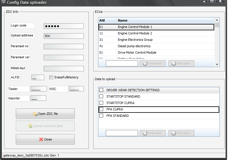

can i use vcp one there is 2 for leon but unsure mike gave me the basic dataset for odis just need stop start an white back on my drive profile wen not in sport thanks for your help just realise who you are haha

I flashed fpa an eass from 2nd picture no joy still could u help at all please maybe take a look if u have time mike said edit it with your tool but i cant get it to run lol @Chillout
