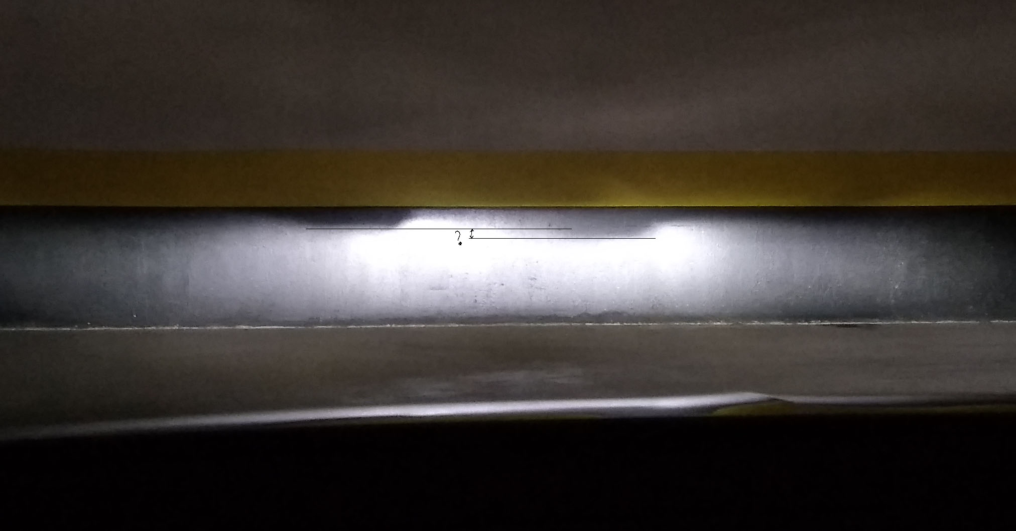

Hi, guys! I'm from Estonia (right-hand traffic). I have Seat Leon ST Xcellence 2.0 (04/2019). I found this topic because my headlights are too low. But also right beam is lower than left. When i did photo, i was sitting on the driver seat (left side). Is it norm? Look to attached image.
I did 1/2 turn for left beam and 360 (1 circle) for right beam. And now they have almost the same level. Should the beams be at the same level?
Don't have an answer for you, but my lights look almost the same as yours.
Actually, my passenger light was lower than yours but I raised it myself to look as in the pic.
I feel they are at the right height, maybe even a bit low still.
