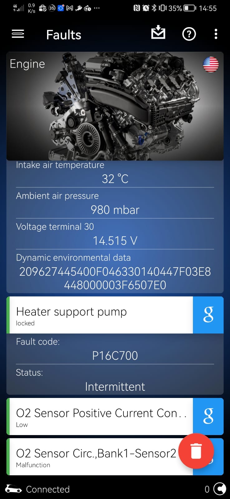

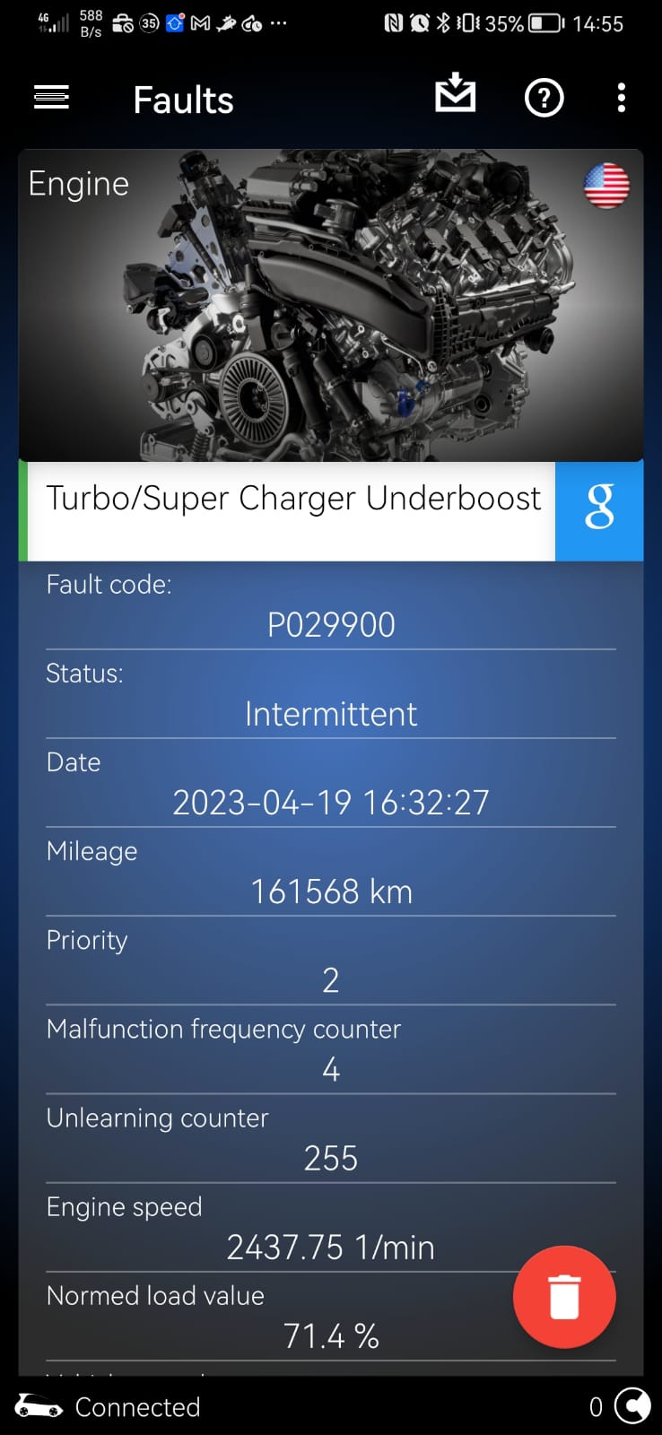

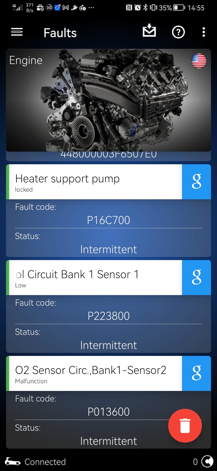

Thanks for the reply mate,
That’s exactly what I’m afraid of being ripped off by the main dealers I feel like I got ripped off by the garage that I brought it from already. With mine I have actually got 3 alerts on the OBD2 system. First is o2 1 sensor intermittent fault the second o2 sensor 2 as there are two on these one at the front of the exhaust and one at the backend. Then I also have a secondary heater pump lock warning !!! to top it all off the timing belt and water pump have not been changed at the recommended service. It’s on 103k now I got it on 99k. I went through a broker and they blagged me saying it had been done that’s why I opted for one over 80k. Thinking that major service will have been taken care of and I will have stress free motoring for atleast 2 years. I tried taking it back to the dealer about a month after having it. First they said bring it in we will look at it and let u know what’s the issue and book it in for the work to be done. When I got there was a different bloke who says no you have to leave it here with us and we will call u when it’s done. Can’t tell u how long that will be either !! Was really unhelpful and blunt. They’re an hour drive from mine and I need it for work also I didn’t trust them as they was acting really shady like having whispered convos with the mechanic so I couldn’t hear and being really annoyed at the fact I brought it back and told them they had to rectify it as I had the issue from the first day I got it. It’s been a while since then but I am in two minds to call them and see what they say.
I did see online someone else put the same code as my heater support pump one and they recommend getting that secondary water pump replaced but said not to use an after market one as they only cause more issues. I’m really frustrated And dreading taking it to a mechanic as I know they will have a field day. il post the fault codes so u can have a look and yeh that would be good pal. We will have a chat and see if we can get it sorted between us. What fault codes are you getting now are they the same as before ??
First thing don't stress mate everything is fixable and secondly a main dealer or seat specialist will always tell you its something catastrophic and it's not.
I figured mine out myself in the end through research and studying manuals.
So it will be something we can fix between us.
I had 5 fault codes to start with and I now have one and it only comes up now and then and it's only what is suggested above and neither are major issues they can be fixed with no major hassle.
I will have a proper look into your fault codes tomorrow and see if they match my original ones if not yours will be alot simpler.
People on here helped me and ill help you after all that's what these forums are here for to help each other out

Thanks a lot mate appreciate you taking the time to look into the fault codes for me. Also my fuel economy is no where near the advertised 70mpg I barely get 35mpg and that’s when I’m driving really carefully coasting a lot and really watching the active mpg meter. My average is about 33mpg. When driving locally. I don’t do a lot of motorway driving. From what iv read online it Suggests it could be because of the faulty o2 sensors ?? I have been looking to buy new ones but parts dealers want £125 for pre Cat and a £105 odd for the post cat one !! On eBay they going for 30-40 quid. Do you think the eBay ones will be any good ?? Also I need the exact part numbers if anyone can help with those would be very grateful as don’t want to get the wrong ones. I have a 2015 1.6 tdi 110hp
Lastly I have seen o2 sensor adapters (spacers) online does anyone know if they work or if they are a waste of time ?? Il attach my fault codes below
To be fair you got to be careful on ebay as some of them are cheap Chinese crap parts.
