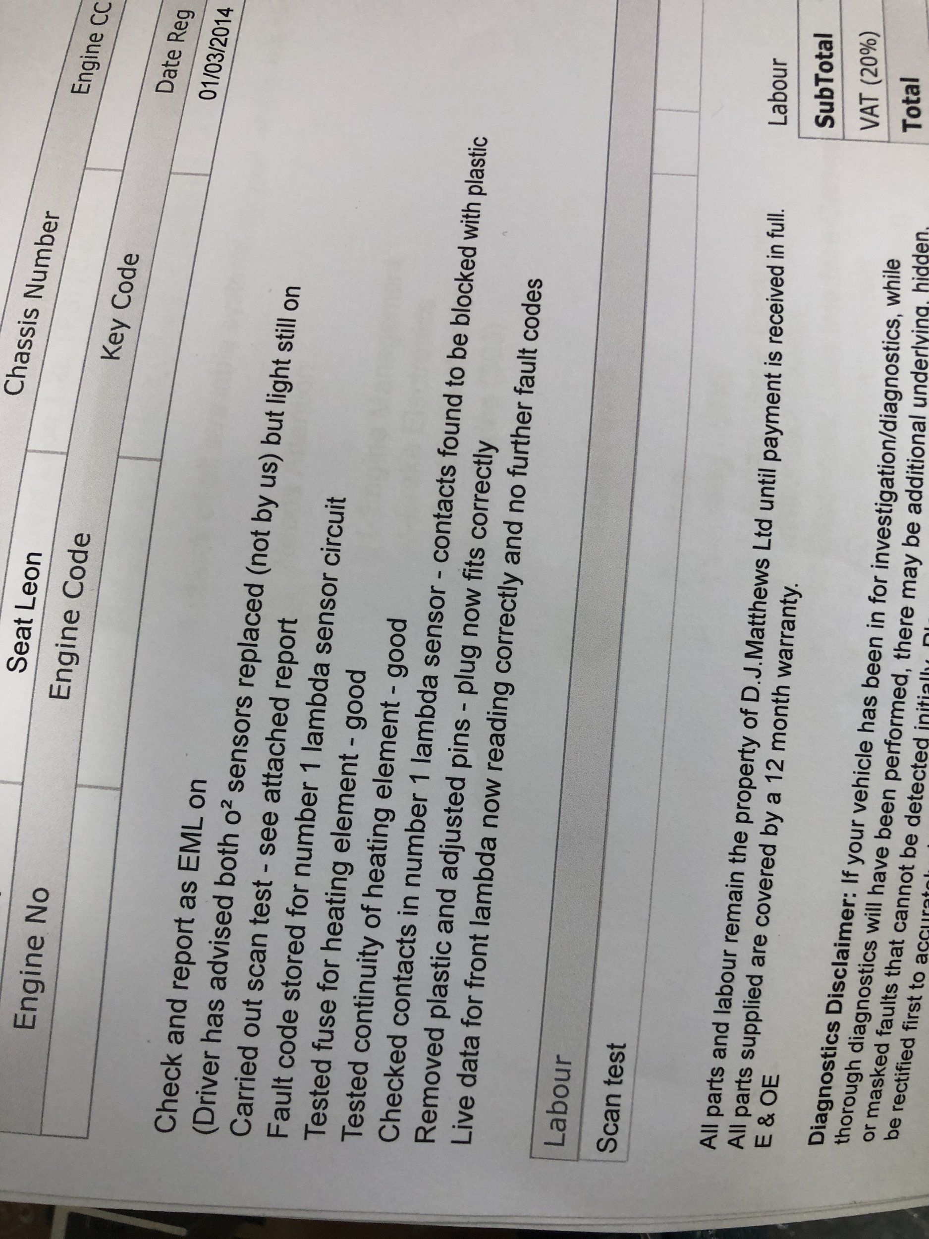

Also , from their diagnosis Heath scan , told need attention on:
1) B1168f2 steering angle sensor no initialisation
2) B126301 tank lid unlock activation electrical error
3) B140b29 release button in rear lid Handel implausible signal
The main reason I took for scan due O2 sensor and light on dashboard.
I replaced 2 sensors by myself and error still present - cleared many times , did not solve.
Inspect fuse - all good.
In the end was contact issue from probe sensor wont make enough contact.
You will see from photos
img_1733-jpeg.47867
