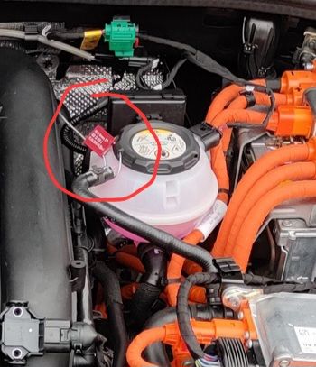

Did anyone get a warning about EV coolant being low? I got it and it is indeed low. I checked it but there are no signs of leaks.
According to the manual, it should be refilled with G12evo which is the same coolant that the IC engine uses. The manual is also mentionenting in bold that i shouldn't top up the coolant and go immediately to a specialised workshop.
But now the question is...why is there a security seal on the EV coolant tank? Whatever safety reasons they think they got can be applied on the coolant used by the IC engine which is missing that seal.
I don't want to put the car on platform and send it to the service for a fluid refill, it's kinda stupid.

Also had this warning light on and off recently with my Cupra Formentor PHEV. EV coolant is just below the minimum.
I can't see why there is a security seal and I am reluctant to take it to a dealership for a simple top up. Hoping someone could shed light on why there is a seal?

So I searched for an answer. That coolant goes to the batteries and if there is a leak there, the liquid will have a pretty high charge and you can die if you touch it.
But for the moment, I fixed it by removing the hose where the seal is located. After I removed it, a lot of pressured air came out and the coolant was back to normal. That's weird but it worked...for now. I'll keep monitoring it
Presumably if the security / tamper proof seal is removed by any one other than the Seat dealership and there’s no record on the car’s digital service record that the EV coolant has been topped up by a dealer, then it would give Seat an excuse to decline any subsequent warranty claims in relation to the EV cooling system.
I'm assuming that if a dealer does top up the EV system, then they would fit a new replacement security / tamper proof seal?

They'd probably void the warranty on the battery too if the cooling system wasn't maintaining it at the correct temperatures ?

Hey, I noticed my coolant was below min so I undid the hose to release pressure. Turns out there was no pressure and when I disconnected the hose some coolant leaked out so I put it back on v quickly. Did you ever get to the bottom of your issue? Mine is a well below min but no warning. Thanks

Some people say that if there's no pressure, then the coolant is leaking somewhere. Not trying to scare you but the worst case scenario is leaking in/around the batteries. Either way, I have no other data to back up my claim, just people's comments around the internet.
For me, since I disconnected the hose and plugged it back again, I had no issue. And it's been 1.5 years since I did it.

Thanks i appreciate the response. I'll keep an eye on it. Did some coolant come out of the hose. Some did for me and I'm not sure if that is normal.
Had this same issue come up today, hadn't looked into it before I went to sort it myself, stupidly yolo'd and cut the security tag off and undid the reservoir lid partially, and it started venting pressure, and the fluid level started to rise on its own, closed it back up and its been fine since then. Need to monitor it.

FYI: If there is unusual behaviour on your vehicle and it concerns the HV coolant level being low, it's generally the sign of there being an underlying issue, especially when there is a lot of pressure there, there should be next to no pressure.

I'm going to point out the blatantly obvious here and be quite blunt.
Opening the HV coolant bottle cap to relieve the pressure within was not the cause of the issue or the fix for it, it's was a symptom of an underlying fault and to do this several times expecting a different outcome was not a good idea.
The first time the issue occurred should have been when you made contact with a repairer.
Why the RAC didn't stipulate you have the issue investigated ASAP is beyond me.
So, realistically, the lesson here is there is no issue with having a hybrid car over an I.C.E (you'll probably find you have a similar issue having diagnostic work carried out on a petrol or diesel engine these days too, lead times are at an all time high), but should you have a problem, you're better off having it investigated in a timely manner to prevent an inevitable component failure.
At a guess, the pressure will have been air con gas filling the HV cooling system due to a failed HV chiller unit. It's becoming a regular occurrence.
The knowledge and equipment required to carry out that particular repair should be within the scope of any half decent garage.
