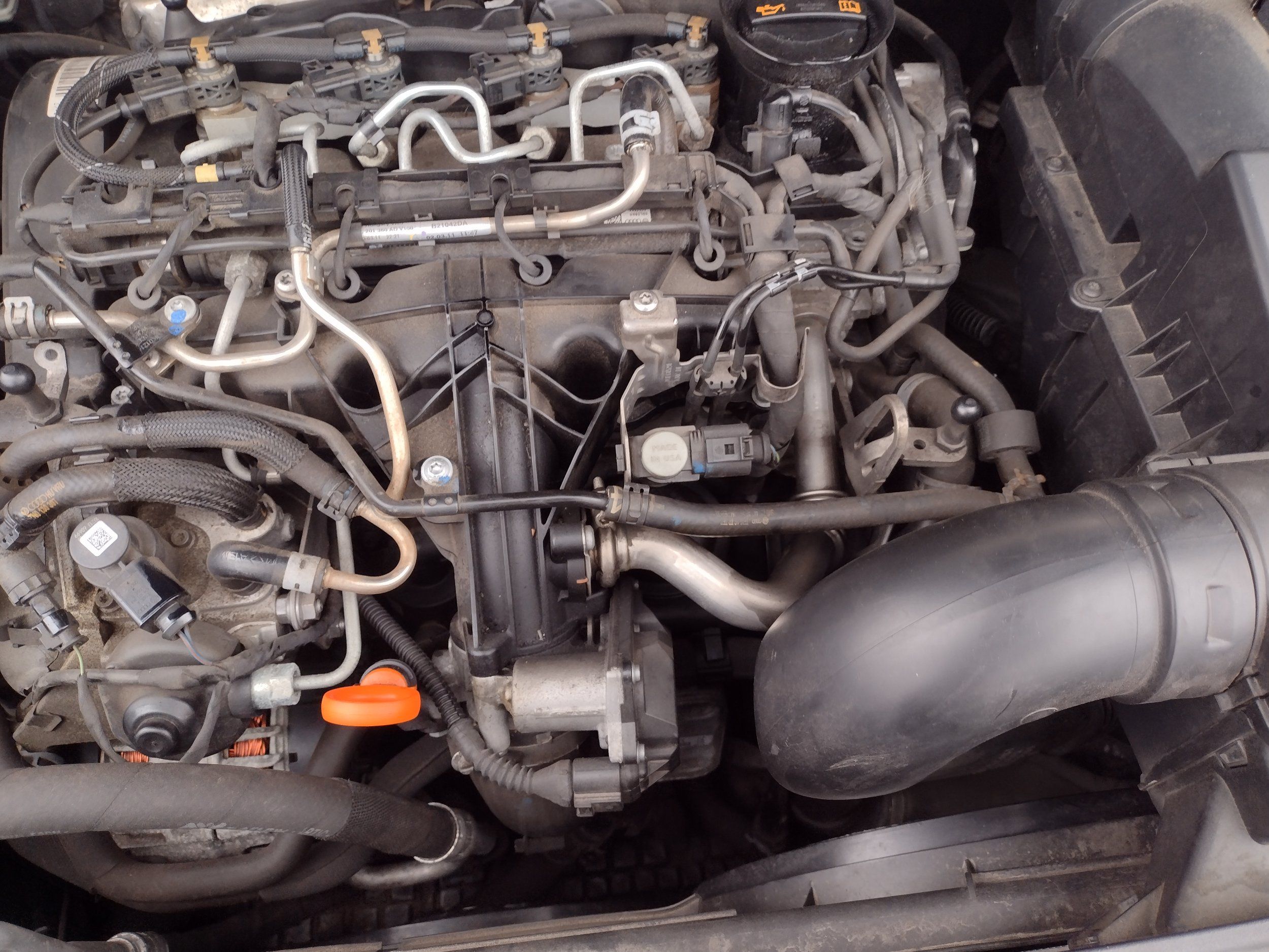

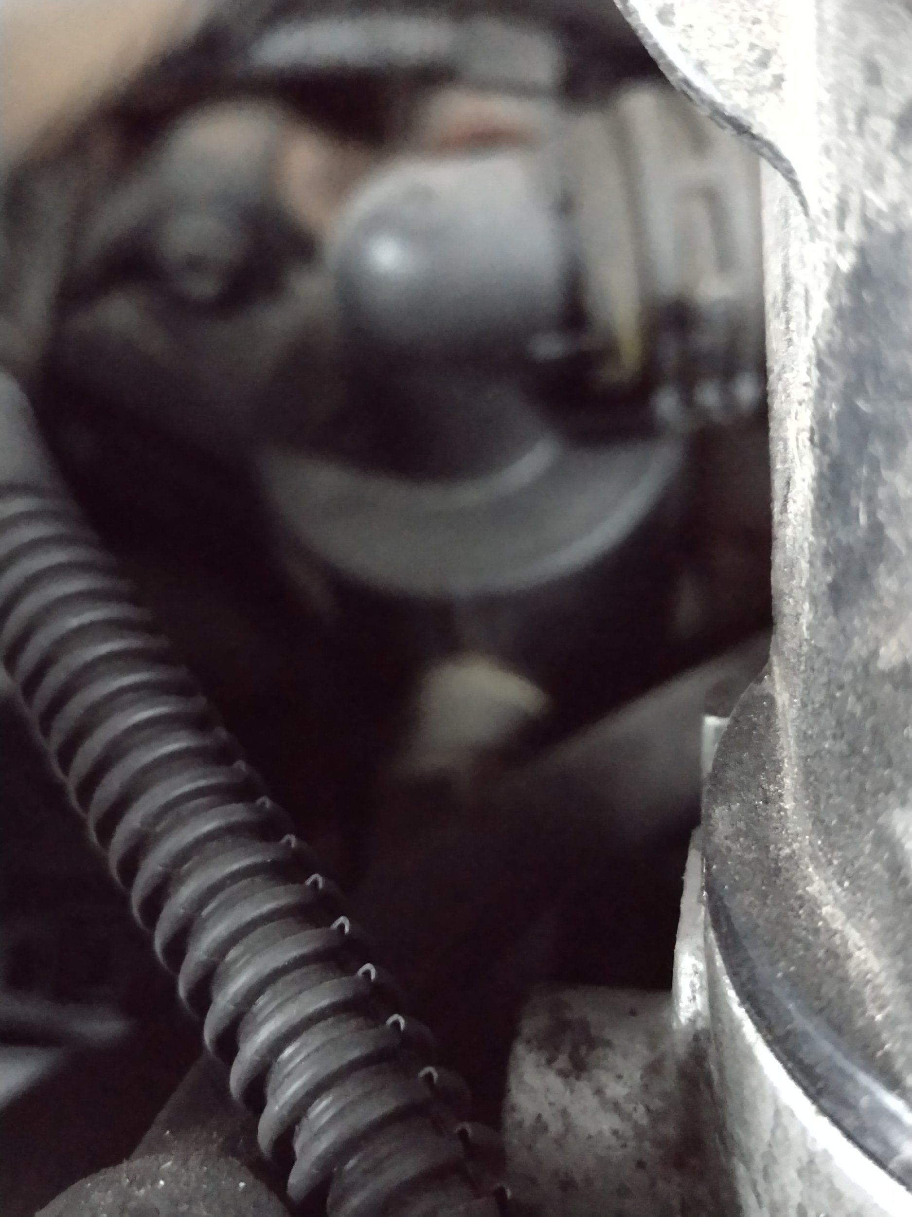

I am unable to access pictures from help guide of Wovotim. Also I am struggling to find location of Coolent Temperature Sensor for Seat Alhambra 2011 CR 1.9 TDI. Attached are pictures. Appreciate if you can help
