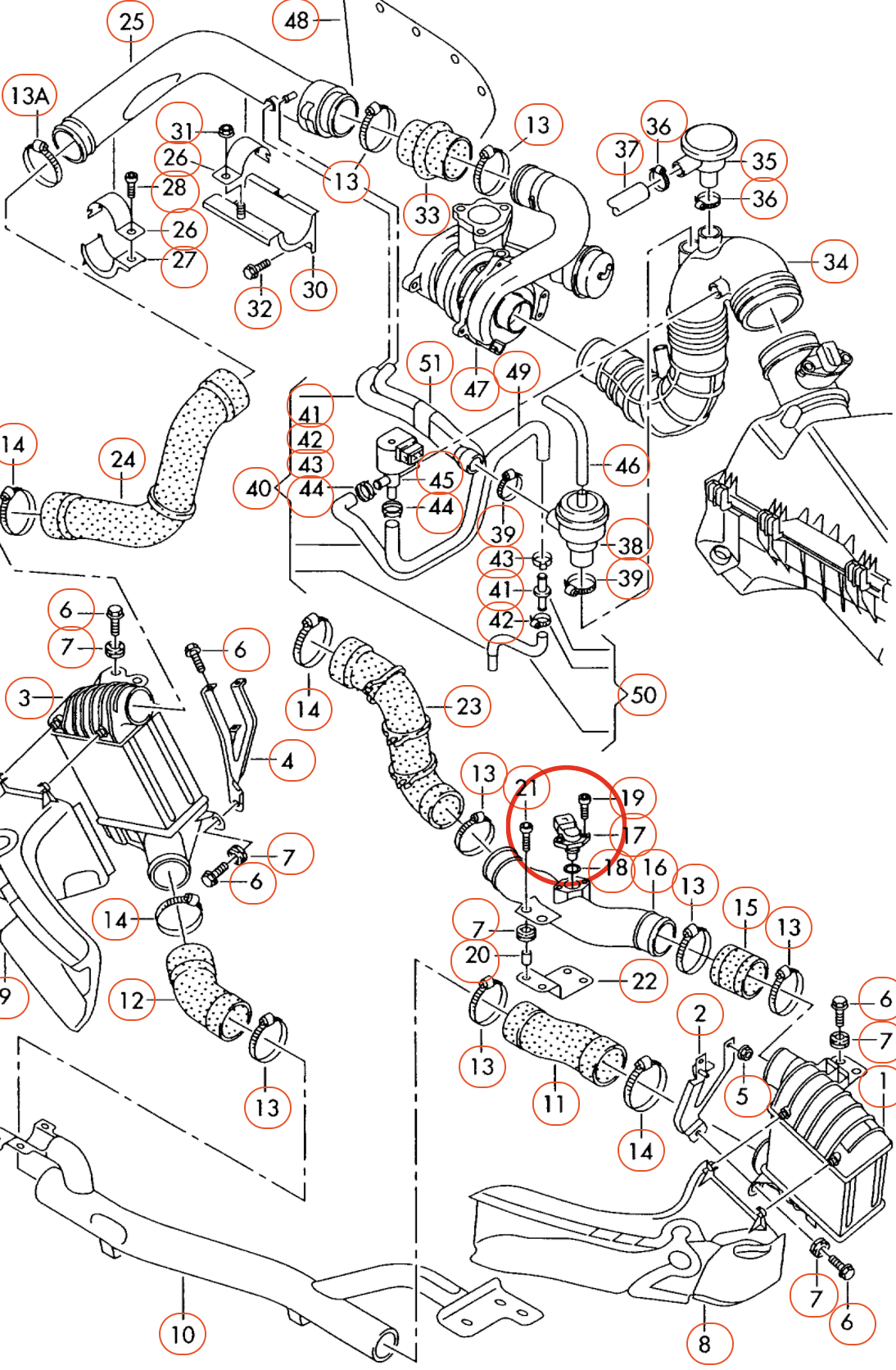

Should give you some idea, i guess itll be under the battery, either bumper off or if you're lucky through the wheel arch by removing the trim
good luck

Ok, that helps a little more, I’ll check it out today.
out if interest have you had the bumper off before?
rgds
ps sorry for the p#£& taking tone!
pps
I think I’ve found it, it looks accessible as well. I’ll keep you posted. Cheers Connor.

Ah nice one glad you found it . I couldn’t find any pics of where it’s actually located so diagram is next best thing Lol
