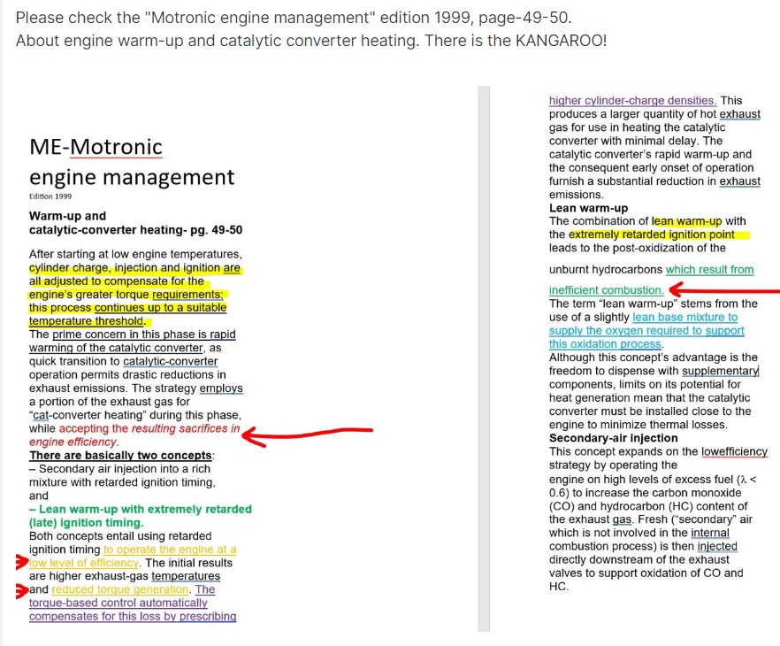

Ok, so the title is misleading - let the Kangeroos have their fun I say!
Anyway, I paid for an hour access to Erwin this morning and came across the Technical Service Bulletin section. There is a Service Bulletin with a release date of 11/10/19 called:
2470: Jerking while warming up when accelerating/releasing accelerator (only 1st to 3rd gears - EA211evo 1.5 l TSI)
This is obviously the well documented claim of kangerooing / jerking / hesitation etc
It states the 150 bhp Leon 5F engine 1.5 TSI 110kW DADA has a new software version available to the dealers in response to this issue:
Original part reference: 05E 906 018 AL
Original software version: 6084
New part reference: 05E 906 018 AL
New software version: 9692 or higher
Those with the 130 bhp Leon 5F 1.5 TSI 96kW DACA (like me) will have to wait as the status shows "in preparation phase".
Anyone had this update done or been contacted by a dealer? Personally I can feel hesitation while the engine is cold and it is amplified when the ACT activates until the engine gets warm.
Here is the cause of Kangaroo:
