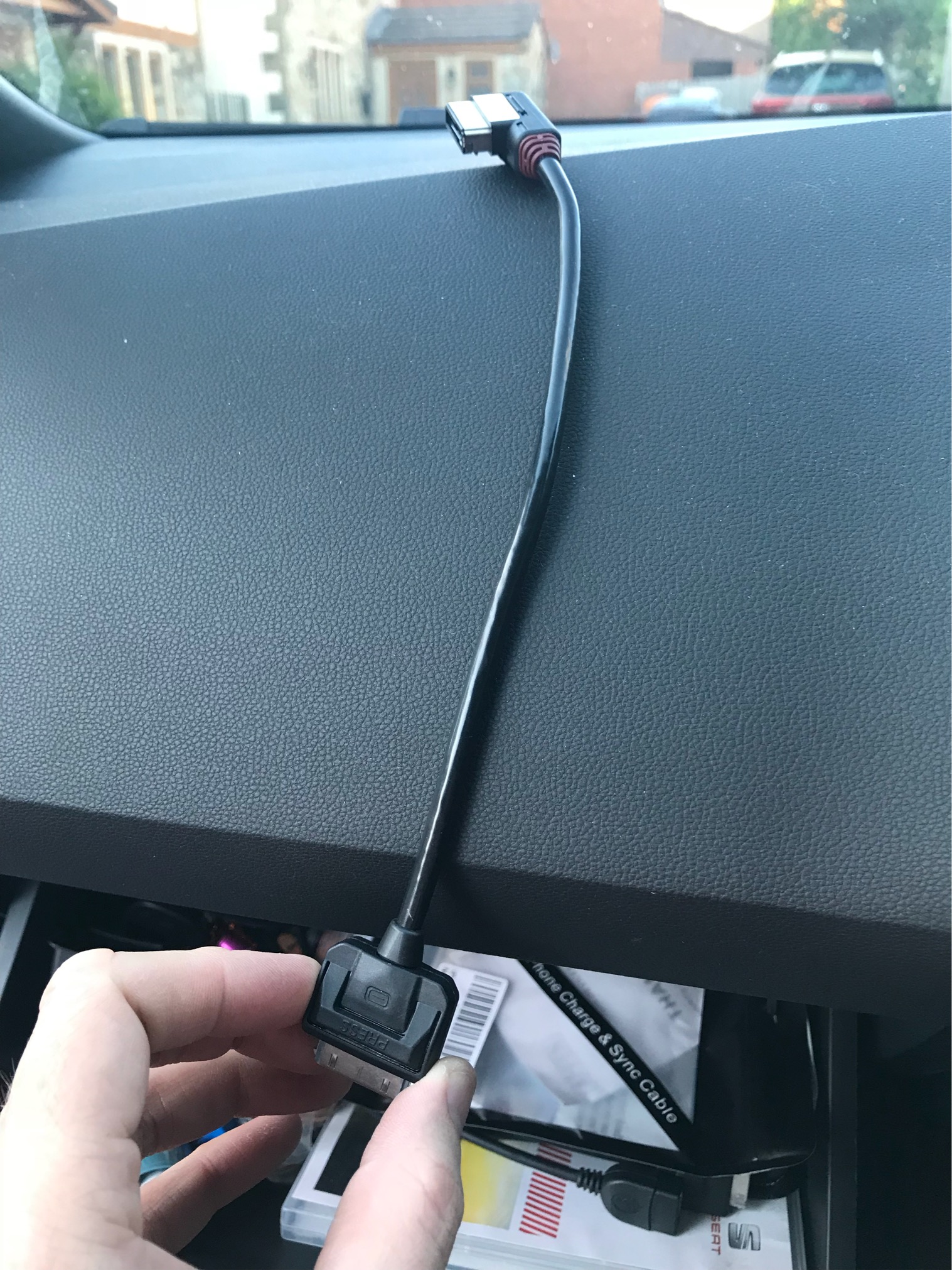

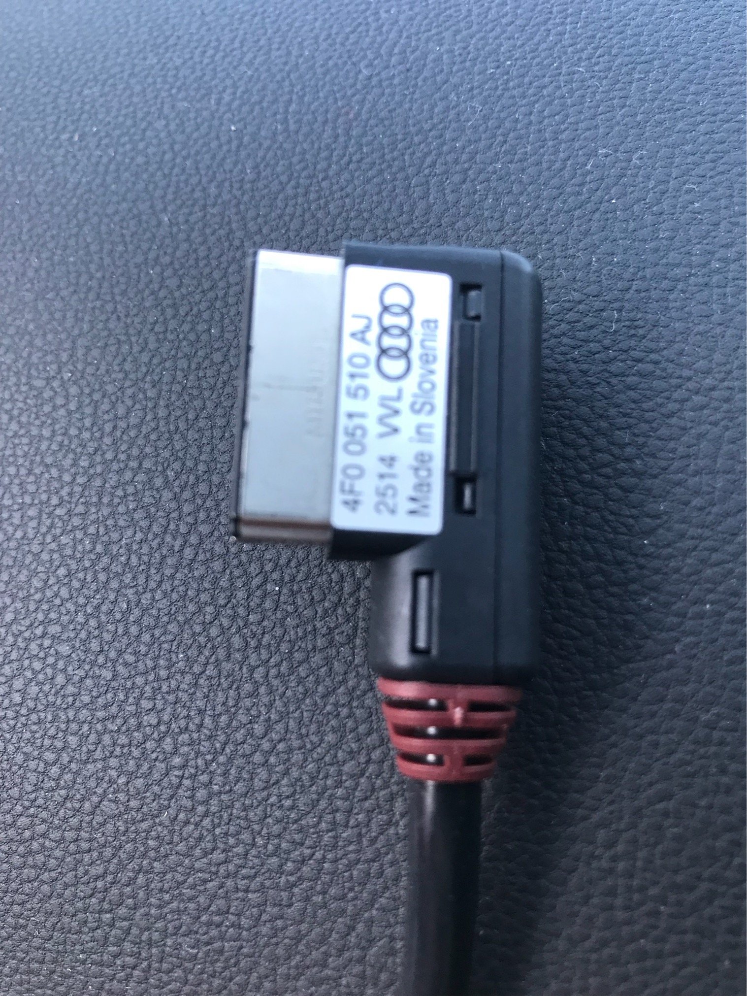

That’s the one BUT it has a red collar around the wire to show it’s the better cable.
Audi cable, red collar - hopefully you can see the part number:
89F26D0D-8DE3-4313-982D-2E5ED3A4BC13.jpeg D2F40916-A52E-4A6F-B5F9-73034983D370.jpeg
This one worked prior to iOS11 with album artwork.

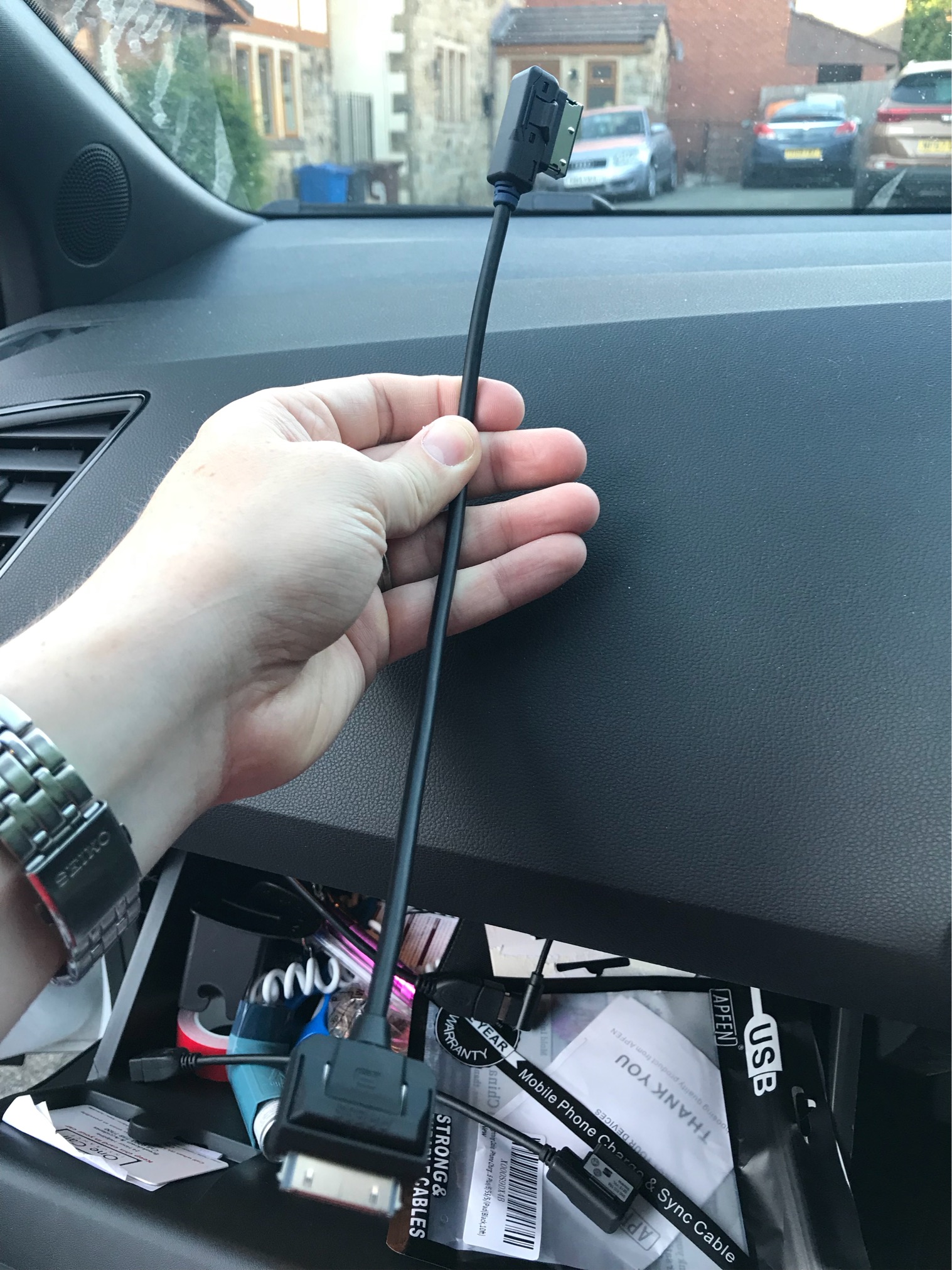

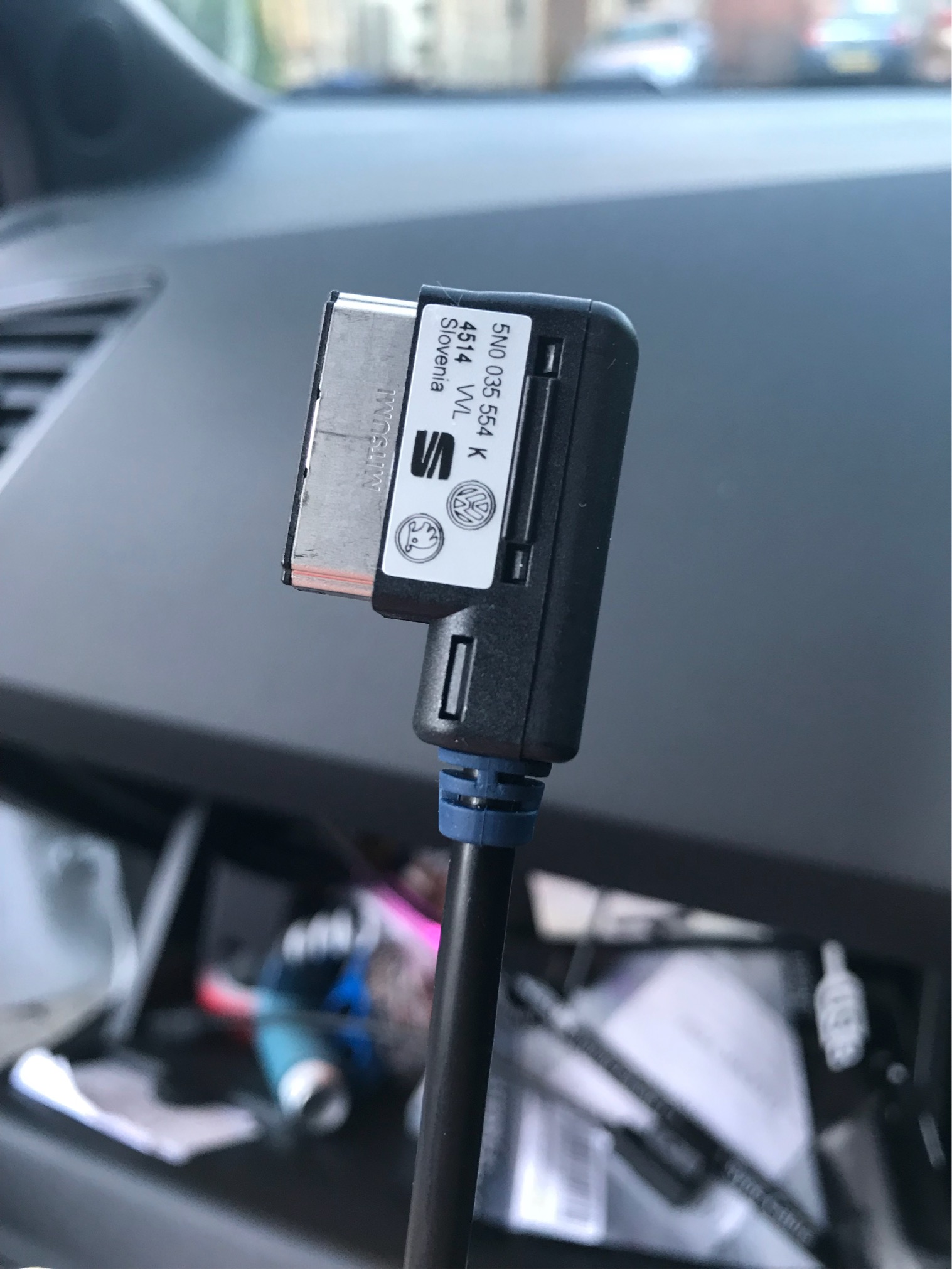

Seat cable, blue collar:
1DB5818F-2AA2-45A9-90B6-FDCE49E32D5A.jpeg 151E3A3D-387C-421C-AFE7-ECBC61F5237F.jpeg
This never did album artwork.
