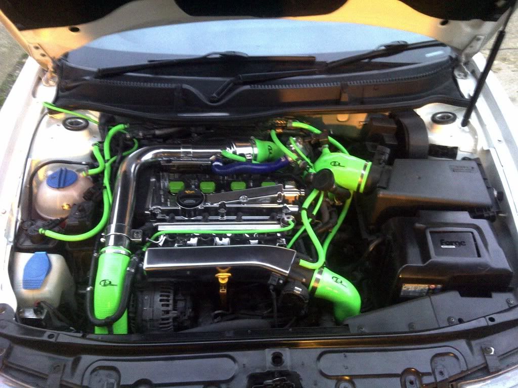

Soo as some of you have seen ive been having problems with the car ticking over after ive put it all back togther.. had a little play with things tonight and hopefully its sorted, sounds a lot better :)..
Heres the bits i had done fitted... not totally finished and Ignore the blue pipe work, i have a delivery expected 2morrow ;)

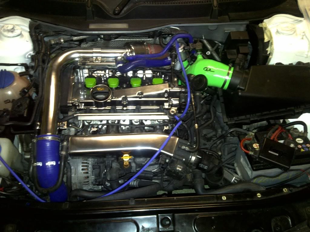

Didnt last long :(, took my manifold back off, cleaned injectors, tightned the seats all the way down this time, hoping that would have cured it all, started fine and ran perfect, but now when i rev it it knocks and the then splutters a few times on idle then will settle again.. worried about the knock as it was perfect before it came off the road :(
Hoses turned up today though.. now gonna fit most of them :)

Sorry to hear mate, are the coilpacks down all tight? Hope you get it sorted.

Cheers Tom, should look good when done, all coilpacks are ok and down.. just really worried about the knock thats comin from somewhere .. Not having any luck with this lately, lost nearly all my love for it again. :(

Hi Mike,
Finally managed to get a copy of FC yesterday evening; nice pics and write-up.
I'm not proclaiming to be an expert, but I've had something similar to this happen to me. In the end, it was a coilpack that was intermitantly faulty, and didn't completely run smooth again unitl all four packs were replaced. Bear in mind that when a cylinder has below-par voltage, it may cause a sluggish motion and this maybe the cause of the knock in the cylinder; engines tend to knock when they run rough. Get a voltmeter and clip it to each each wire feed individually, it should read roughly 14 volts. Any less at any point, it could be a dirty connection within the loom, or at the point of the coil pack.
Cheekily, I called out the AA when mine started to play up, and this is what he did, before my mechanic repeating the same process.
No expert in any shape or form mate, but this was my experience. Thought it might help. Keep the faith. It'll be something very minor and soon it'll run sweet as a nut again.

Thanks a lot mate, ive gt a few last little things to check, im going to thread lock all injector seats in and alraldite round the tops to try and seal them fully to make 100% sure.. Glad you enjoyed the feature :)
Soo today i got all the other bits on, and gave it a wash, felt a bit more love for it again, but the knock/misfire problem is still there.. Oh and ignore the blue hose, still need to order a replacement :)
