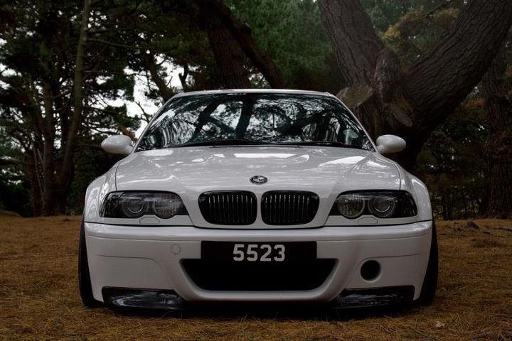

Thinkin of this next...
:lol:.. Ive always wanted an m3, the same as i always wanted a cupra R.. If you dont do these things when you can the time may not ever come...
I dont wanna be sitting there at the age of 70 regretting that id never had the chance to own one..
In 2 minds wether to get a m3.. or just a 330 or 325.. half the price, so that leave plenty for mods.. hmm
